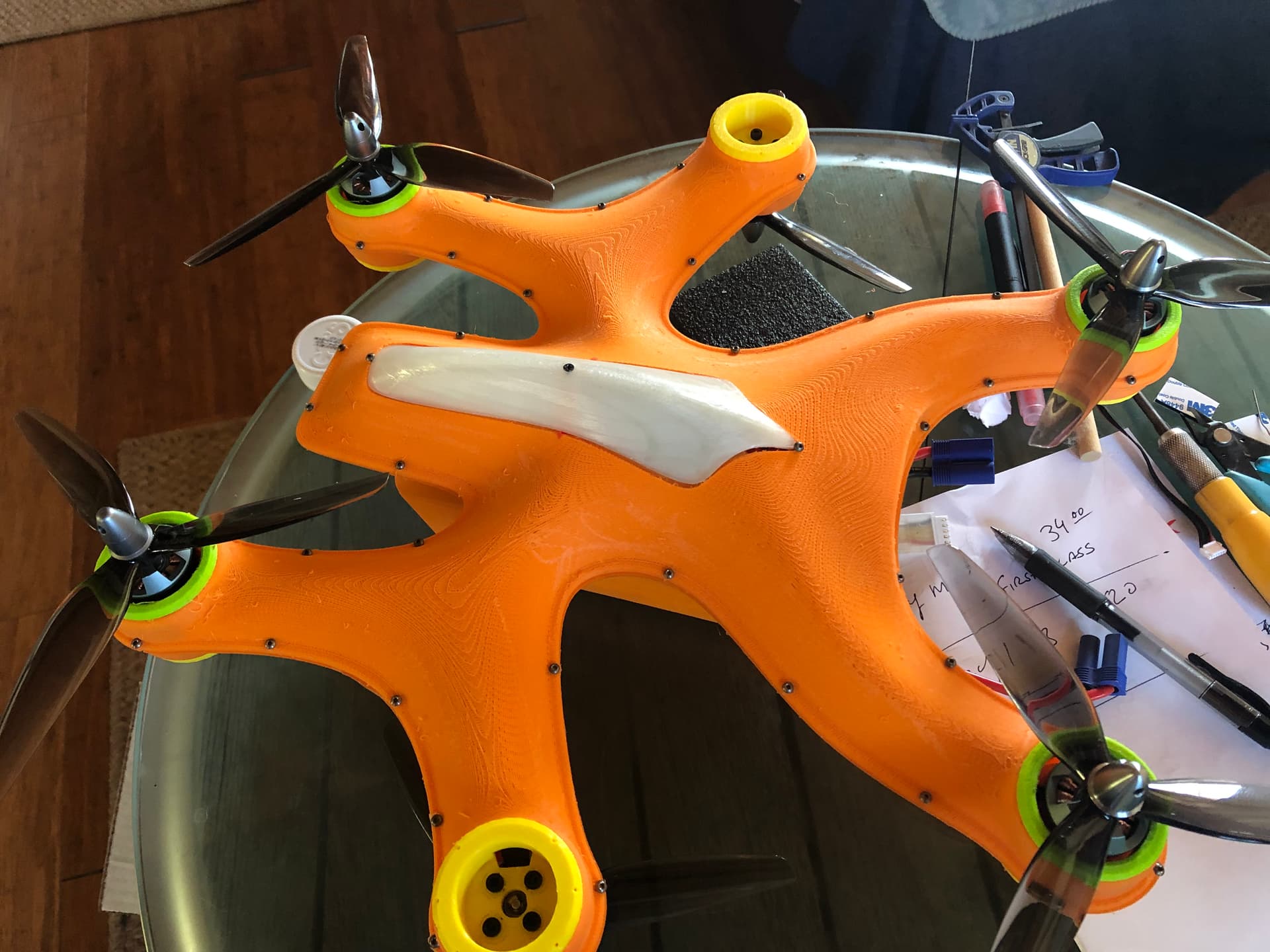

[SOLVED in 4.7-dev] Take off problems in AltHold and Loiter mode: Whoop Frame

I have, although I didn’t see this issue discussed. I’ve seen a few other videos of log debugging that hint at how you would recognize this problem, like this
5/8/2025 8:25:52 AM : Frame: HEXA/X
5/8/2025 8:25:52 AM : IMU2: fast sampling enabled 9.0kHz/2.3kHz
5/8/2025 8:25:52 AM : IMU1: fast sampling enabled 8.0kHz/2.0kHz
5/8/2025 8:25:52 AM : RCOut: DS600:1-6 PWM:7-8
5/8/2025 8:25:52 AM : mRoPixracerPro 00360044 30305109 37393435
5/8/2025 8:25:52 AM : ChibiOS: c6d0293e
5/8/2025 8:25:52 AM : ArduCopter V4.7.0-dev (3b4dc138)
Doing some test flights and all seems well with an exception of a GPS needs home message.
