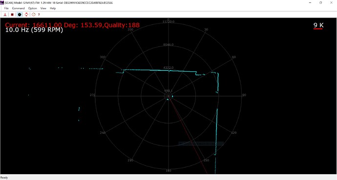

RPLidar S1 erratic distances

Hello @Fayeli I tried the using the different baud rates on pixhawk, I am using a cube orange. what baud rate did it work for you on your CUAV?

I followed the manual online and its not detecting it. This is what its showing for Rover @rmackay9 @Fayeli
@rmackay9 do you think it could be because of the hardware I am using? I am using cube orange (not the plus), with the pixhawk board and 4.5.1 software.
those high price hardware as cube orange shouldn’t have the power problem.
the baud rate did work for me on my CUAV is 256000.

I continue getting the same error. My motors on the sensor are not spinning despite plugging in exactly how the manual states I continue getting prx-1 no data.
I checked the voltage on each wirings its 3.3 volts on rx and tx and on power i get 5.2 volts. everything is correct including my wiring. My parameters are according to the user manual.
Do you have avoid or rngfnd values changed ? For terra ranger i know they recommend changing avoid values too.
When i do plug in the sensor to my computer it connects.
What firmware version are you using ? Any other guidance for me or any supporting documents such as your parameter file that i could request ?

hi
AVOID_ENABLE=7
SERIAL2_BAUD=256
SERIAL2_OPTIONS=1024
SERIAL2_PROTOCOL=11
PRX1_TYPE=5

I faced same issue in my rover.
I tested S1 in outdoor using framegrabber from SLAMTEC. It very noisy in Standard scan mode. But I found it is very clearly in DenceBoost scan mode in same condition.

That type of lidar is sensitive to sunlight, it gets a false return every time it turns and the sun shines into the lens.
