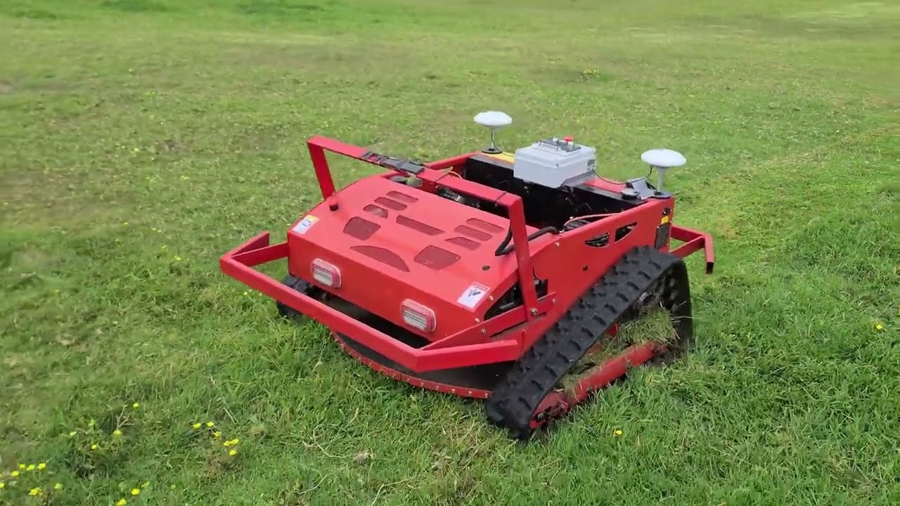

Thanks Randy and team, i upgraded to 4.4 beta11 and ran the auto-tune script.
I haven’t downloaded the log or looked in too far but the lines its now mowing are excellent. Cross track error is well within 50mm and mostly 10-20mm. The tune messed up the speed pids - (bucking bronko) so needed a quick manual tune.
Video of mower driving round and round here.
Great, thanks very much for the feedback. Nice location and nice mower!
