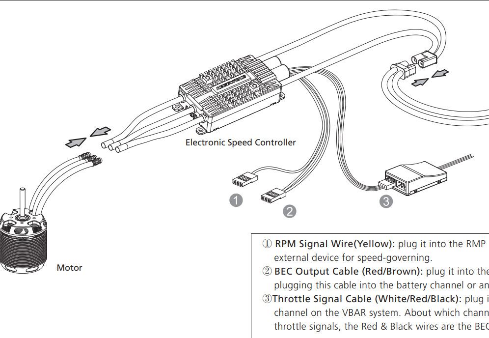

Can you please explain to us how did you achieve this? This will help alot here in the TradHeli hobby.
I read somewhere in the form that they use this cable:
https://www.amainhobbies.com/align-beastx-plus-flybarless-unit-governor-sensor-agnhegbp002/p1539100
but how to wire it and where to plug it?
also what are the parameters need to be changed?
also are you able to read the RPM in your radio through the telemetry screen?
I am using Yappu telemetry connected to the RX trough the CSFR, through the Debug port in the 6c Mini.
Thank you for any help.
Ozzy
Hi @flyingdragon , I’m using HW PlatinumV4 120A on this heli, so followed the connection scheme reportep on their manual, connecting Yellow cable to rpm input of the flight control:
For parameter setup & config follow the “Hall Effect sensor” bit
I Havethe same ESC, 130A platinum OPTO V4 and 200A OPTO V4.1
both have yellow cable also on the side; where is the Fan plug-in gose; the yellow cable for sending the Telmetry info to the FC.
now the yellow cable you used in the pic is for Governing RPM, this will go to the GPIO’s aux Ch?
I need to read the link you provide it to set everying correctly.
Thank you so much!
Ozzy
That is correct @flyingdragon
