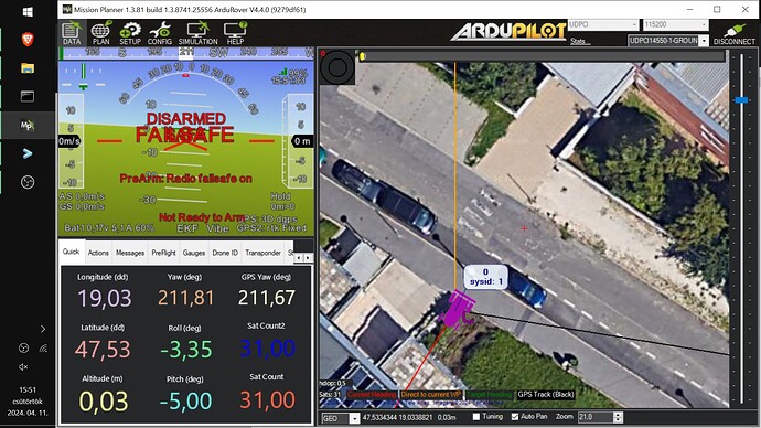

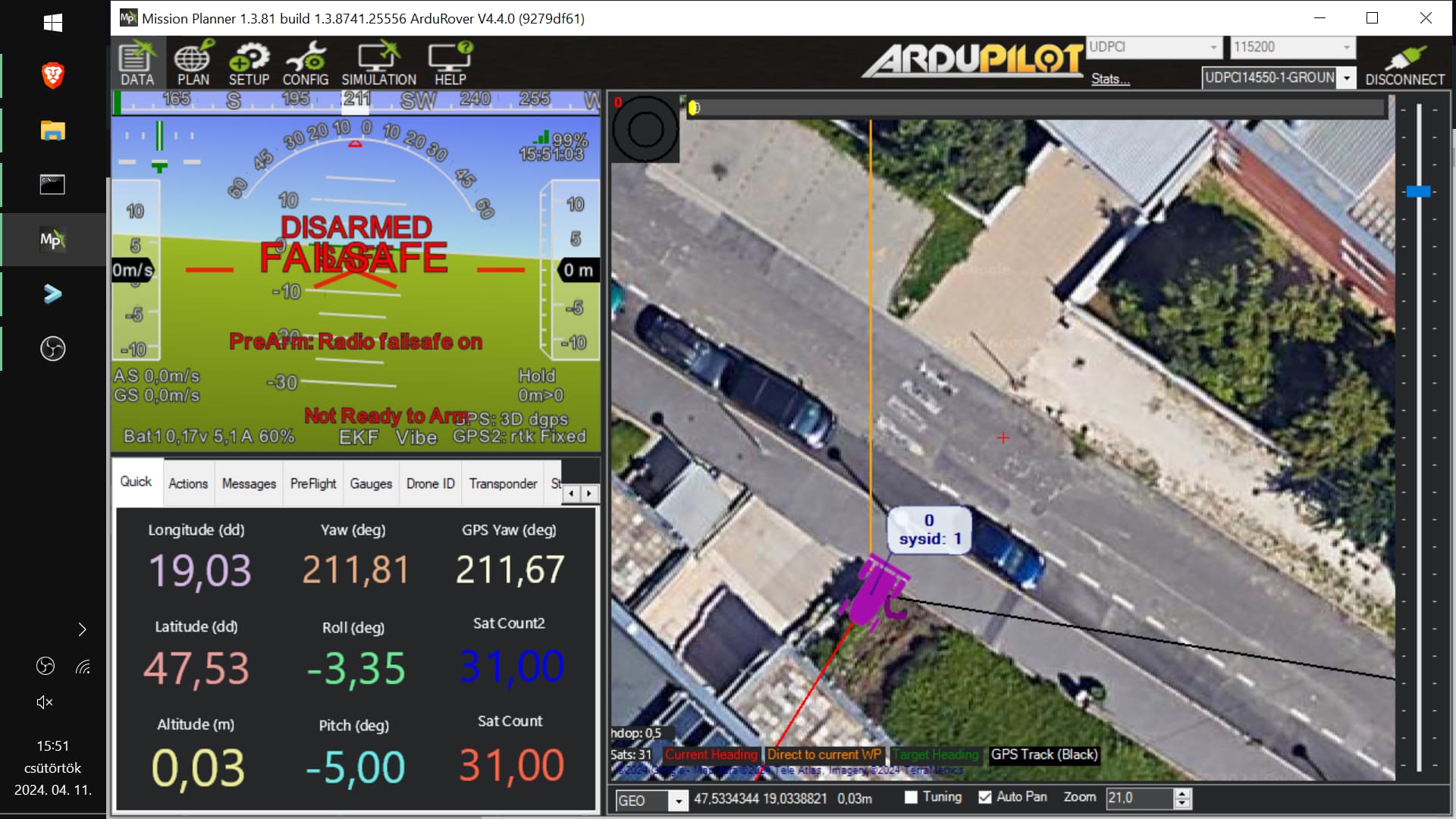

Now the heading works fine! Thank you for this Ardupilot-based configuration!

I can happily tell that today’s test was a success!
We received RTK Fixed positions + yaw from both GNSS-modules, finally.
This last solution works just as it should.
