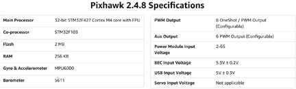

Good morning Andy.
So as previously suggested I installed 4.5 under the dev section and as you can see Dshot on the IOMCU is not recognised.
![image](https://discuss.ardupilot.org/uploads/default/original/3X/8/3/831cca27060d536fa08483d1c7a607378fffb435.png)
andyp1per
(Andyp1per)
106
F100 only supports up to dshot300 - so you need to use that
Did you set BRD_IO_DSHOT = 1?
