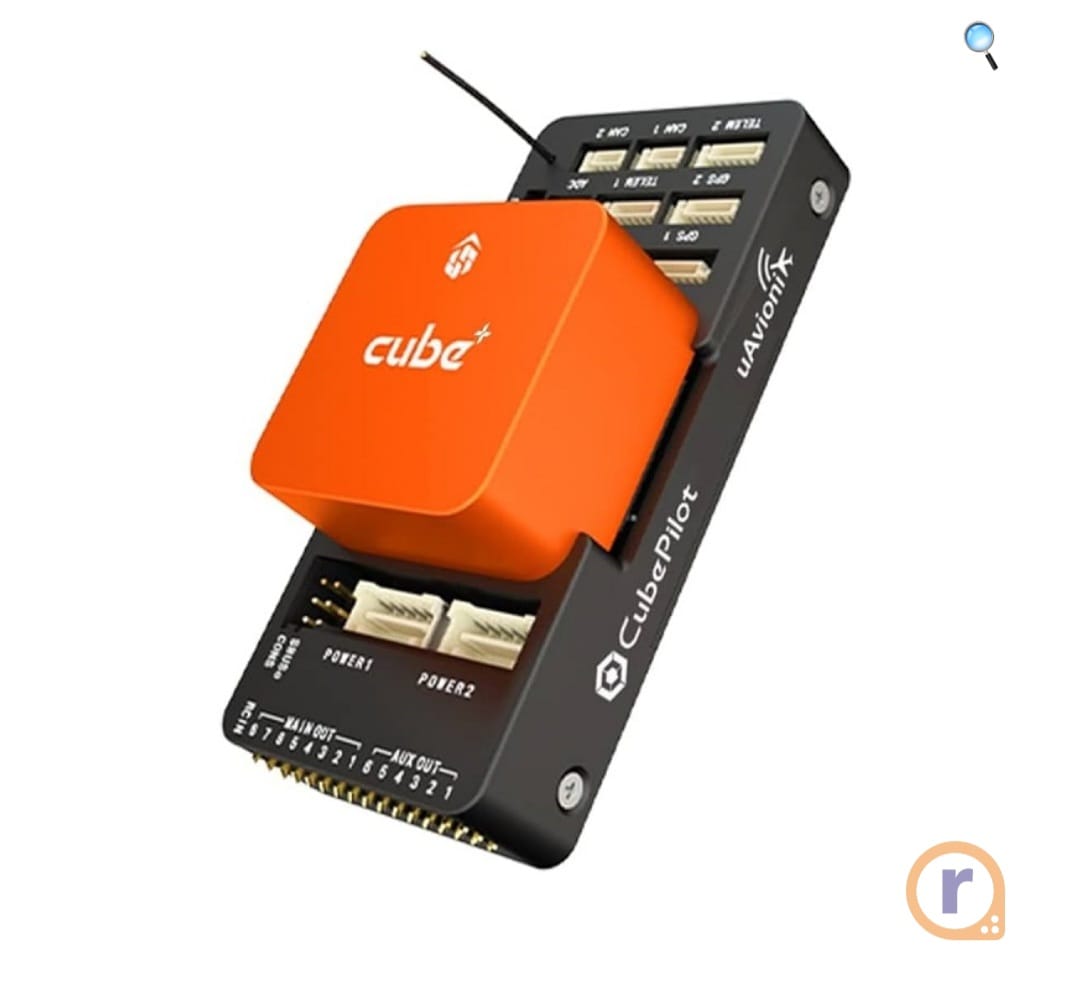

CubePilot CubeOrange+ I2C2 with Lua and Arduino Problems
It works exactly as I said. The colors are standard per the notification library. You are over complicating this massively.
to the power pin i supplied from arduino mega,but the led is not glowing
okay . can you please say the steps how to do?
You may want to show your connection photo and Ardupilot-related parameters. What is Arduino mega capability and voltage level? What type of LED are you using?
Maybe this additional article helps:
I don’t know what else to tell you. You don’t need a giant Arduino + scripting to get notification colors with WS2812 LEDs. Connect the data pin to an AUX output, power them appropriately, and configure the parameters per the documentation.
thank you yuri,“power them appropriately,” i powered them using arduino mega or you have idea how do i connect them
You need a 5V source (like from a BEC) and common ground with the autopilot. Get rid of the Arduino.
Likely a power issue or a power + parameters setting issue.
Where does your LED power come from? Without the LED connection, check the servo rail power is healthy with a Voltmeter. Double-check your ground and signal pin; do not wire incorrectly.
OR
Most WS2812 style LED and strings will operate correctly when connected to the autopilot. However, if you get intermittent or non-operation, you may need to implement one of the configurations below. This is due to the fact that the autopilot outputs swing to 3.3V but the worst case input signal high spec for the LED is 4.3V at a 5V supply. So at extremes of tolerance/manufacturing spec, you can get a combination which will not work correctly. In that case the easiest solution is to lower the LED supply as shown below.
As @Yuri_Rage said, forget the Arduino Mega and try direct native support first.
My settings and did a step down voltage using a diode.
NTF_LED_LEN,8
NTF_LED_TYPES,123367
SERVO11_FUNCTION,120
thank you jai and yuri for your guidance. it helped me a lot. i got the output.
