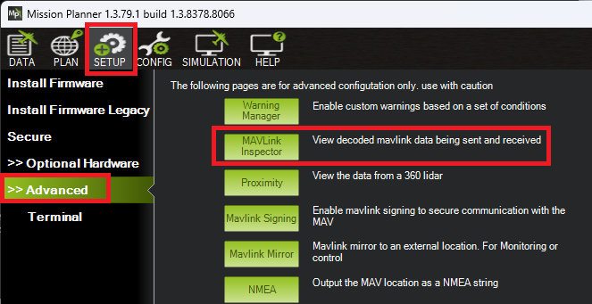

I am looking for verticle speed. I have connected RPI to cube orange. I am getting all data same on my screen which is on MP except verticle speed. I tried GLOBAL_POSITION_INT but still verticle speed speed is not matching with MP display value.
Basically, i am looking for current verticle speed.
@Bhanupratap,
Ok, you might try VFR_HUD’s climb rate field.
Already tried this but still getting different value
@Bhanupratap,
Maybe use Mission Planner’s Setup >> Advanced >> MAVLink Inspector to search through the various messages sent from the vehicle to the GCS.

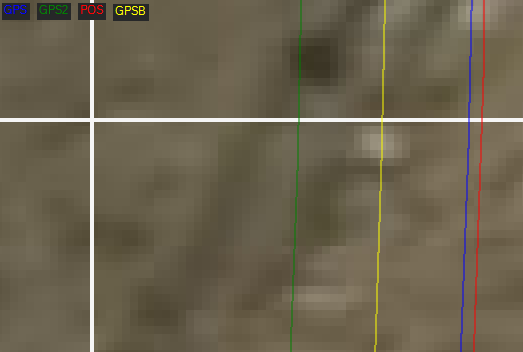

I use blended GPSs on my VTOL - the two GPS are Matek/uBlox MAX-M10S (primary) and SAM-M10Q (secondary). Looking at the logs, the blend seems to work very well, however the POS value does not seem to be following the blend - it is not even between the 2 GPSs! How can I correct this so that POS is making good utilisation of the improved accuracy from GPS blending?
Hi @LzREngineering,
It’s probably better to post in the Plane support forum but the most common reason that POS (which comes from the EKF) may not be between the GPSs is if the GPSx_POS_XYZ parameter have been set.
Less common reasons include other sensors affecting the position estimate (e.g. high vibration, maybe airspeed sensor?).
