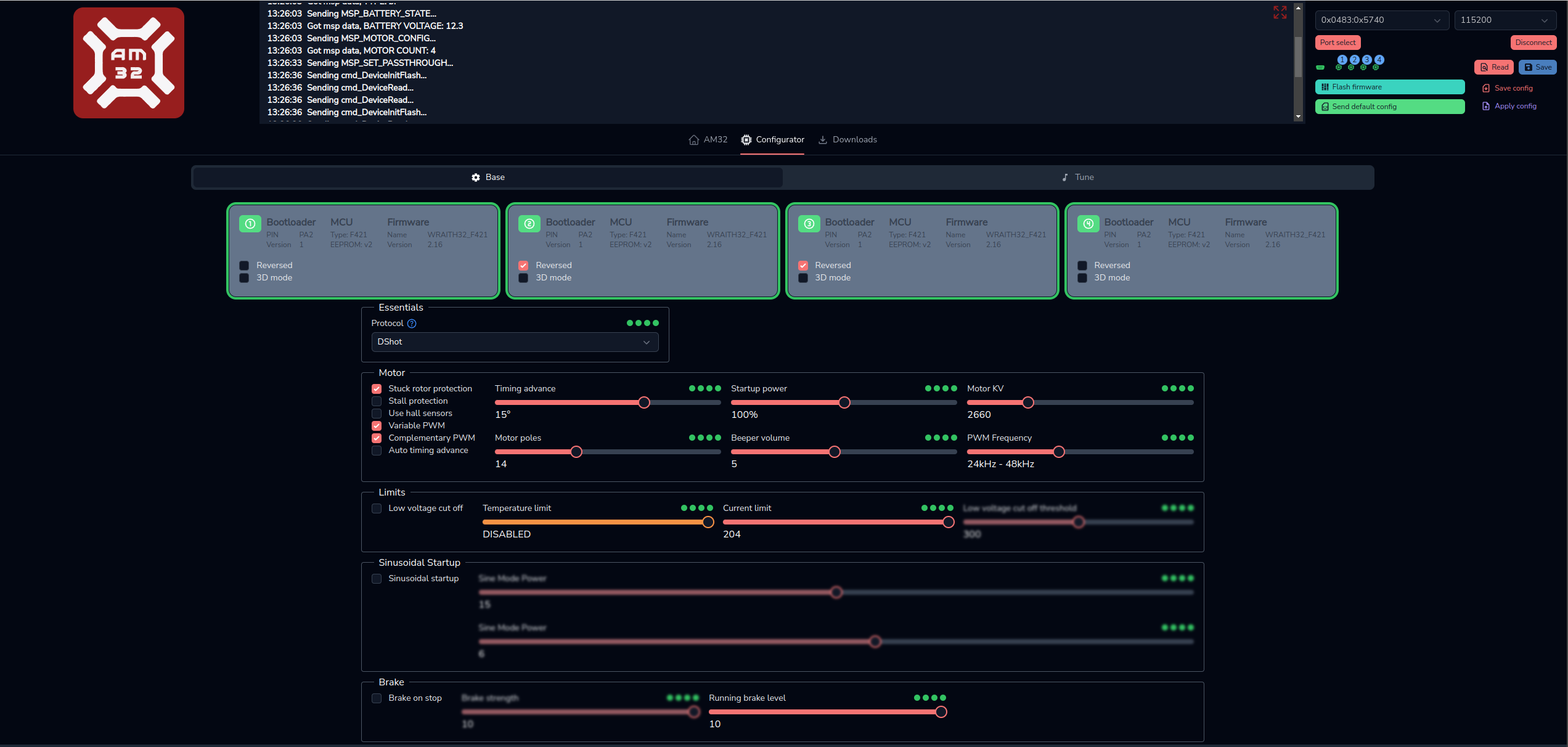

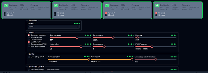

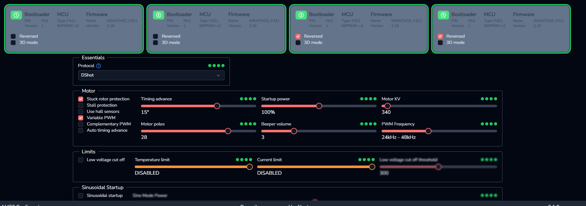

Try without Variable PWM, with these low kv motors you may hit some harmonic frequency of the motor rpm.
The other option is the Sinusodial Startup which is described as a soft start mainly intended for crawlers.
Is there any particular reason why you have disabled the Complementary PWM ?
I read that “Complementary PWM acts as a brake to decelerate the motor more quickly when the throttle is lowered. This is crucial for the responsiveness of FPV drones as it helps change motor RPM more quickly. Enable this for better flight performance.”

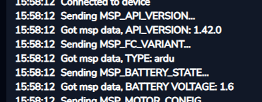

I am curious why at the top it says voltage is 1.6?

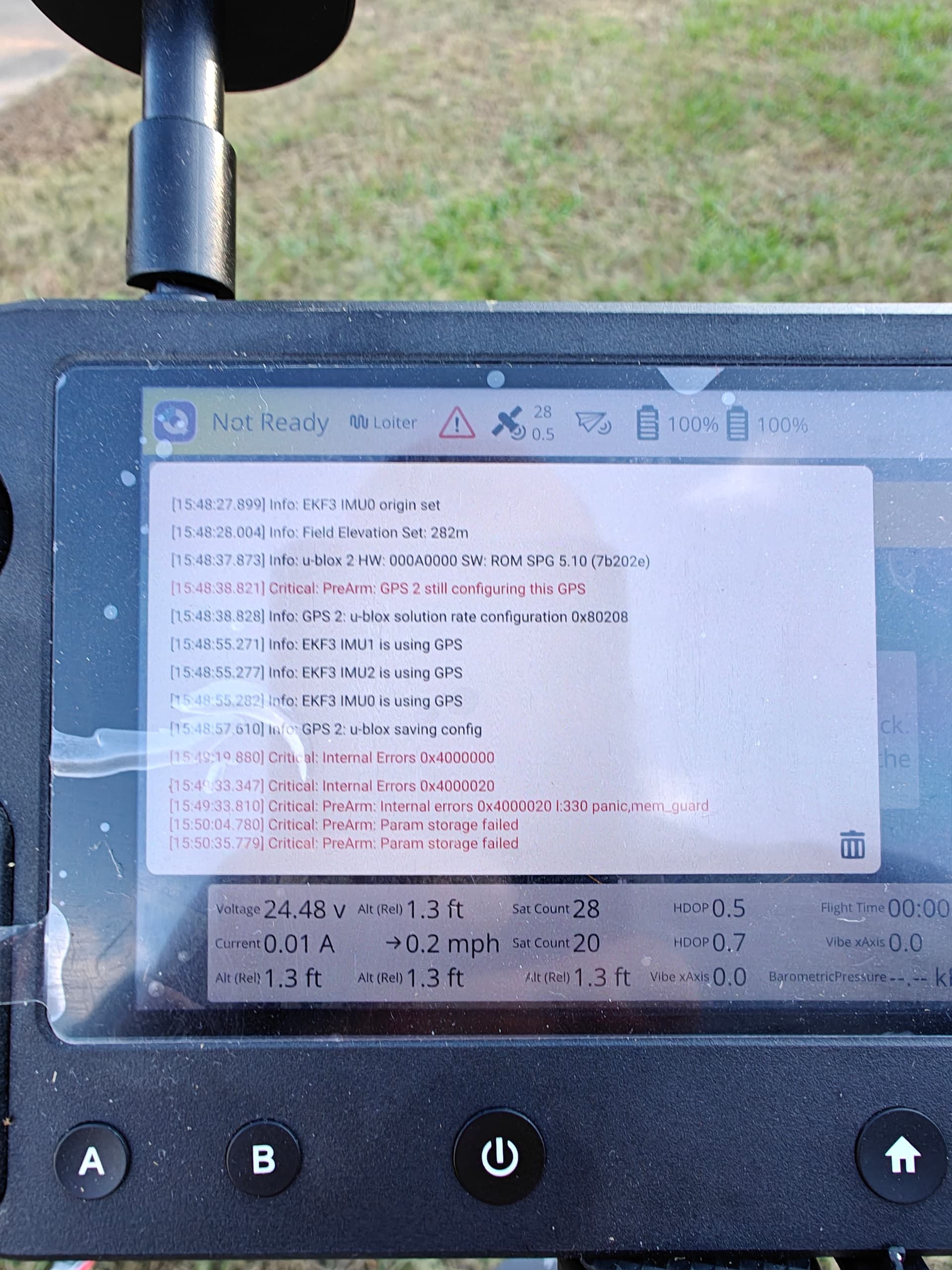

So I just went outside and arm it and they all started fine but motor 3 just stopped spinning after about 4 seconds no noise or anything.
Here is my esc config…
Here is that arming bin file.
Could Variable PWM cause that (what happened one post up) to happen with large motors and props?
In general the Variable PWM feature does change the pwm frequency in some relation to the motor rpm. BL_HELI32 does not have it, so if it ran with BL_HELI32, it is likely due to that.
As tor the Voltage, I checked the ARWingPro with Arduplane 4.5.7 and it also reports the wrong Voltage via MSP, so 1.6 must be 16.X Volts, maybe a bug in Ardupilots implementation of MSP.
The Tyrant S with Betaflight sends correct Voltage for a 3S.

If my esc is " * F4 MCU with AM32 firmware Dshot1200 up to 32kHz" and the variable pwm is setup for 24-48kHz but my esc is only up to 32kHz, then would that cause desync because it is sending the signal faster?
I also am assuming that it is compatible with DSHOT1200 and 600, 300 etc right? I am currently using DShot 600.

I armed without variable PWM and still had the same issues, when the motors stopped spinning this is the error I received. I have no clue what this means.

The errors you’re getting are identical to what I got with a Holybro Kakute F4 V2.4 while trying to get Copter working. The Matek H743SlimV3 did not show this behaviour. I assume it does indicate that you over-stretched the resources of your FC.
Try DSHOT300 instead. I assume you have a F405 based FC.
If the ESC recognizes issues on the FC control signal it will disarm and that’s what likely happens with the motor that just stops.

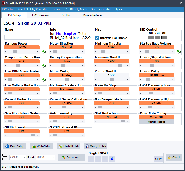

Not true. There is a “By RPM” setting in BLHeli32 32.9 and later

Here are the settings from the 4in1 esc what I changed out.
I found some holybro tekko esc’s with blheli32, same as the ones that I am having trouble out of with am32 on them. Zero issues so far.
