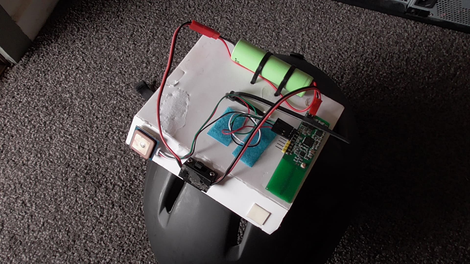

There is no laptop anywhere, I don’t know where you got that idea…
As I mentioned in the first post it’s a board of my own design. It uses a nRF51822 with LNA/PA stage for both transmitter (on my helmet) and receiver on the quad. This chip has many similarities with the nRF24 radio modules I’m familiar with, but it’s also a microcontroller.
Here’s what is stuck onto the helmet:
The long thin shape of the board is because it was actually designed for something else (tilt hydrometer for brewing) so it has many components (accelerometer, step-up regulator, high precision thermometer) which are unnecessary for this usage, and of course that battery could be much smaller. If the board was specifically designed for this purpose it wouldn’t be hard to make a small rugged unit that would be easily wearable (eg. as an armband) or attached to vehicles.
A phone would be large and clunky, not realtime, not necessarily easier to program, more expensive and fragile, and I’m not sure what radio method it would use to transmit over potentially hundreds of meters, pretty sure bluetooth would not cut it. I also would not expect the GPS in a phone to perform on the same level as a dedicated module with a patch antenna.

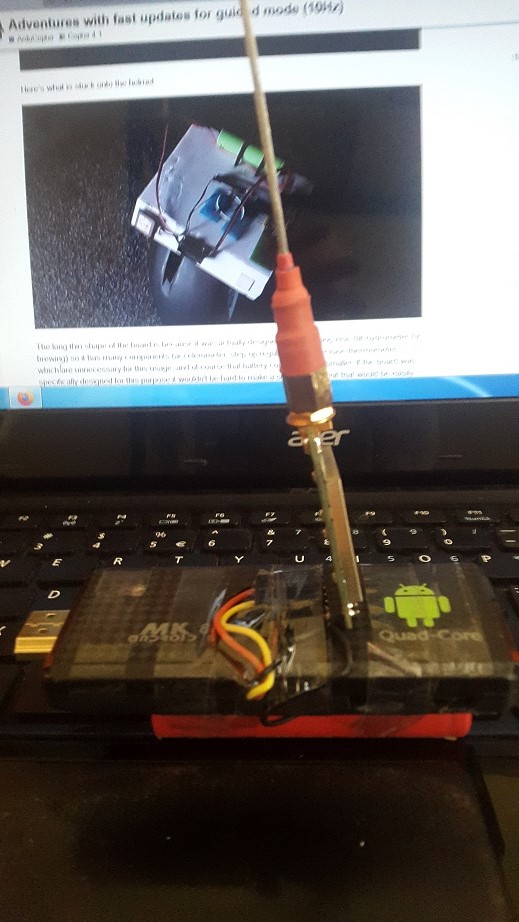

because actually we have some vision for doing this project
look a like isn’t it :slight_smile:
i made my own “companion computer” from my unused android stick, i replace the o/s with ubuntu and use mavproxy in it and use multi vehicle to follow each other (the finall goal)
i’m sorry for my mistake :pray:
