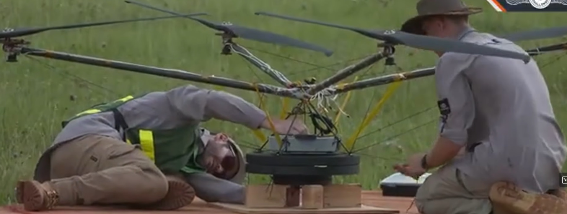

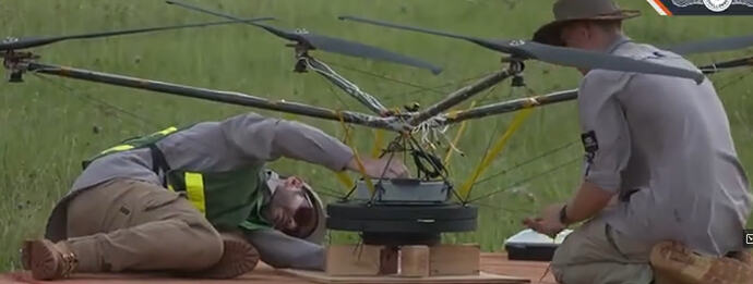

Do you have any pictures? Of the arms, of where the avionics are mounted to the frame?
Add some crosslinks.
