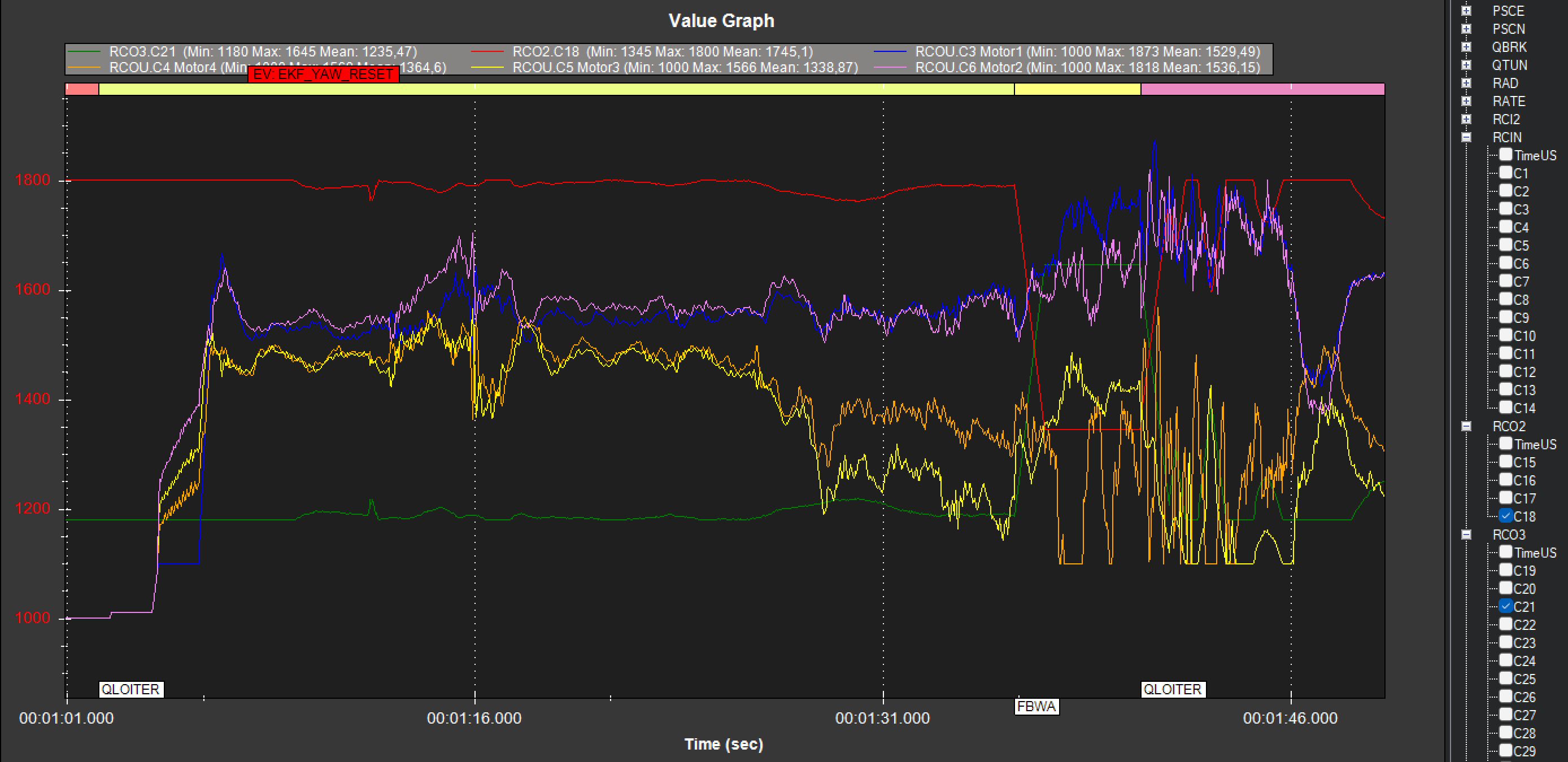

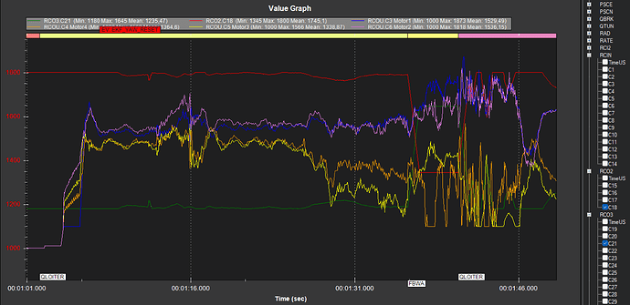

The log shows one motor diagonal ramping up while the other ramps down. However, I don’t think it’s a desync or a motor spinning out of control—I likely would have heard that. A mechanical failure is also unlikely, given that it is absolutely stable and controllable in QLOITER.

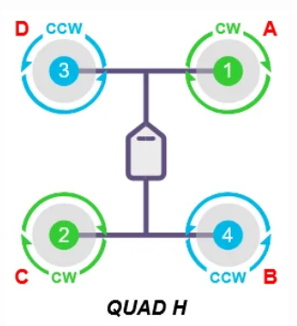

Change motor rotation direction to H mixing. (also parameter)
In X mixing, the two front motors act as if they form a strong false CANT angle during the transition process.
Q_FRAME_TYPE = 3 (H)

It was tried and proven. H worked. You just need to take some time and think about what he explained with pictures. You will realize suddenly.
