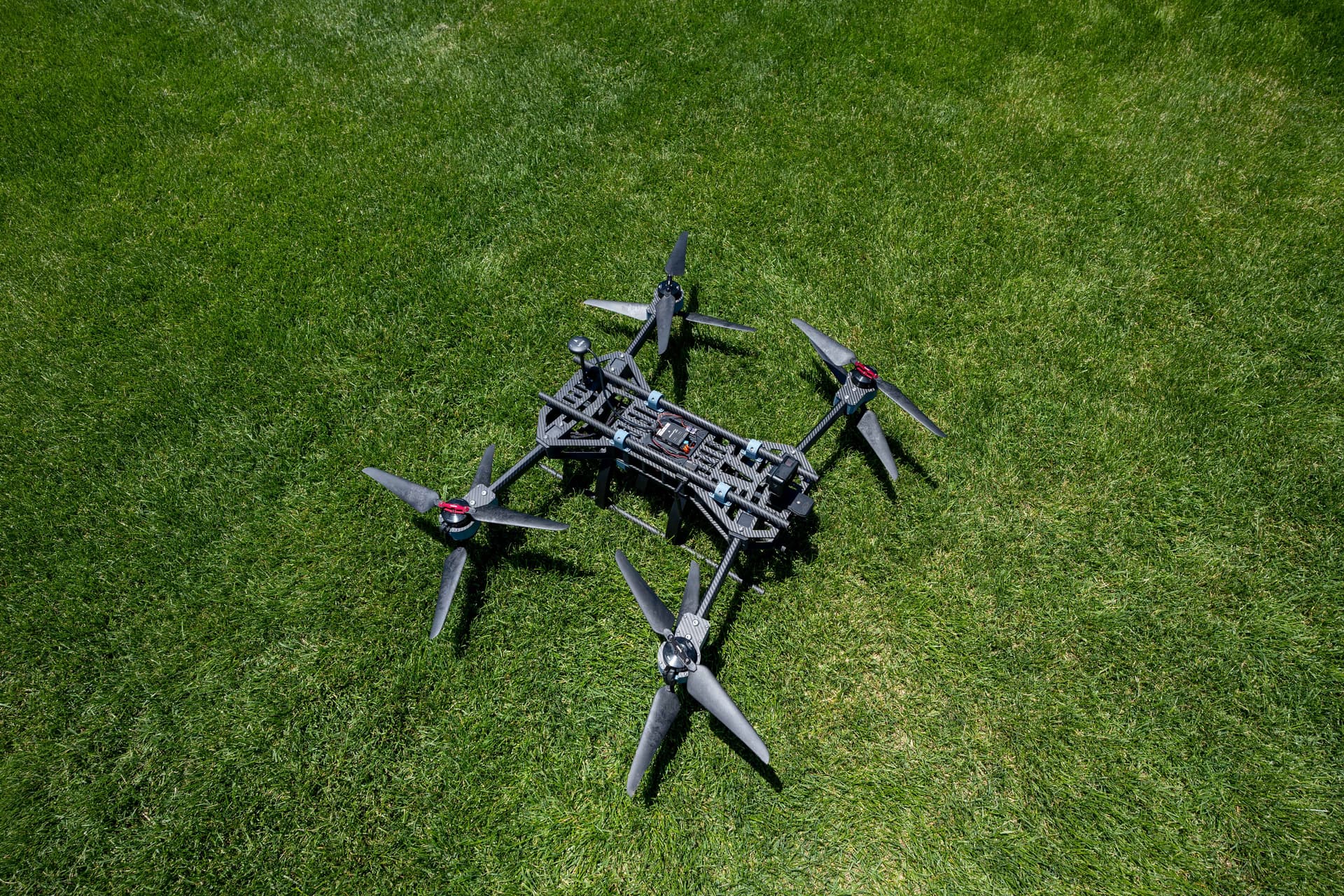

I’m running ArduCopter V4.5.5 on a prototype X8 octocopter and am having some issues with yaw, compass and GPS loiter that are stumping me. I was able to get pitch/roll tuned in acceptably, but the yaw issues are preventing me from doing more extensive test flights (stabilize mode) and the GPS loiter issues are preventing me from testing the autonomous functions.

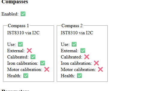

2. External Compass (IST8310) Calibration
  • Calibrated compasses
    • Internal compass calibrates okay, external never calibrates (gets about 67% done and never improves, even with “relaxed” fitness)
    • Swapped internal ↔ external compass priorities
    • Mags show some interference from motors running… not sure how much is too much, and I am hesitant to do the “reverse the props and run up the motors” trick to measure the interference per the online documentation

Frame Custom X8, 18x6.5 foldable props
FC Holybro Pixhawk 6c Mini
ESCs T-Motor 8-in-1, endpoints calibrated
Motors MAD 5005 IPE 280kv
Batteries 2x parallel 6s10ah Li-Ion (within current spec)

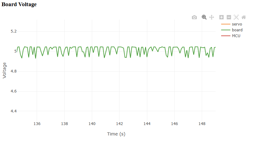

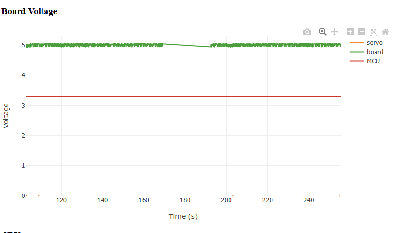

How are you powering your flight controller? Looks like your board voltage has tons of noise in it.
Powering from the current sensor that came with the Pixhawk 6c mini (PM02 v3 it looks like): Pixhawk 6C Mini – Holybro Store

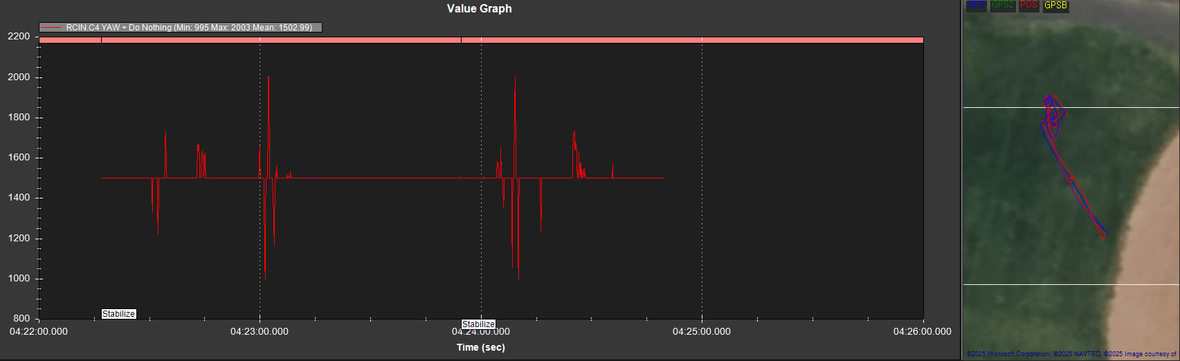

Looking at the logs, there is an interference signal on the rudder that is RCIN4 that does not look like what you intended. The signal is very short, about 0.3 seconds, and we believe it is a maneuver that is unlikely to have been intended by the pilot. It is also in the same timeframe as the sudden movement you described. What is the product of the controller and receiver you are using?

Those yaw spikes are probably me banging on the stick testing the yaw response. It’s slower than desired. For large coaxial aircraft like this, do I need to cant/twist the motors in? Right now they are all planar.
I am using the Pocket TX and ELRS 2.4 system

I attempted to calibrate the internal + external compasses via a long USB cable, no batteries attached. The internal compass wouldn’t calibrate unless I set fitness to “Relaxed”, and I couldn’t get the external compass to calibrate at all; the progress bar would get to 99% then jump back to 0%. I even changed COMPASS_OFFS_MAX from default 1800 all the way to 3000 and still no luck.
Do I have a bad compass/GPS module?
Could the carbon frame + aluminum mount + carbon mast that the GPS unit sits on be an issue?
