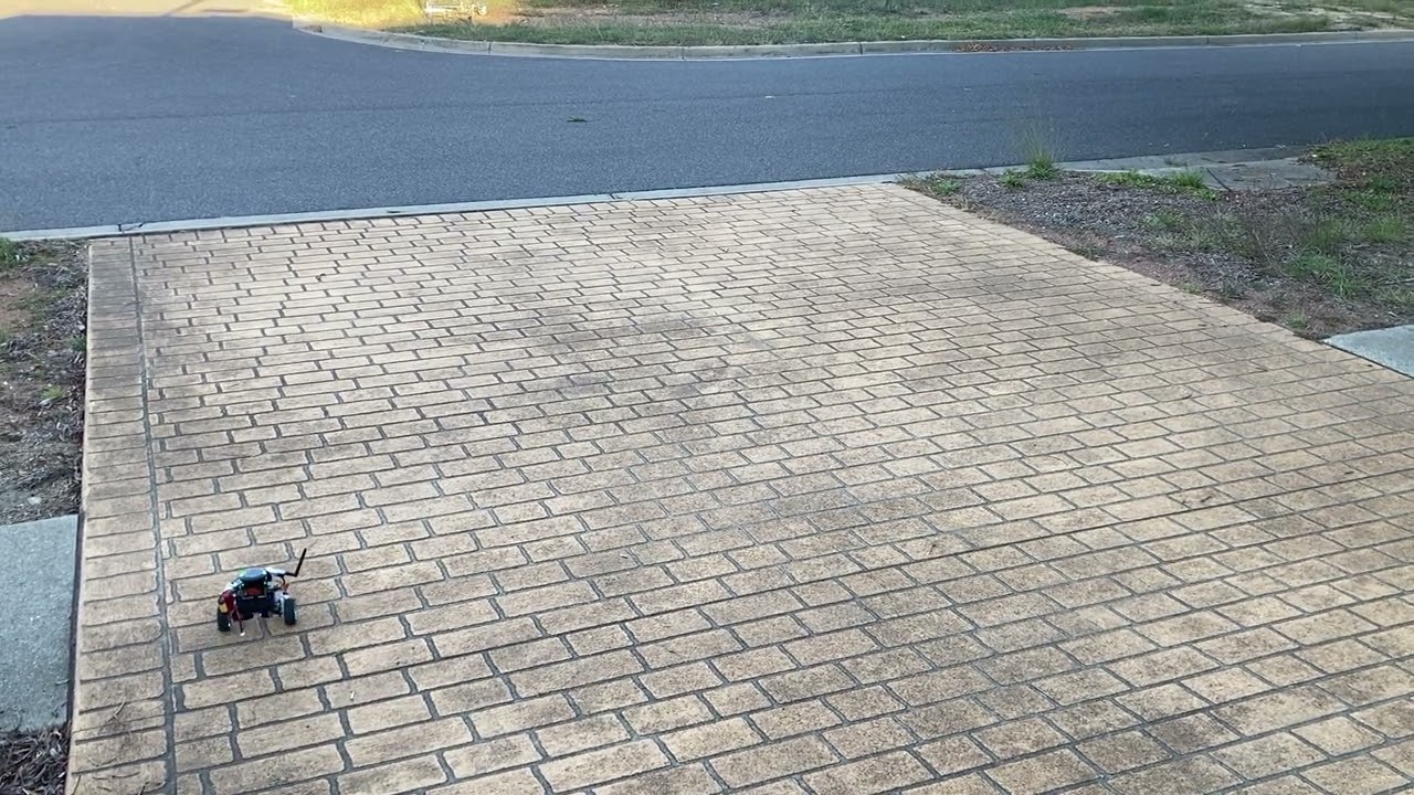

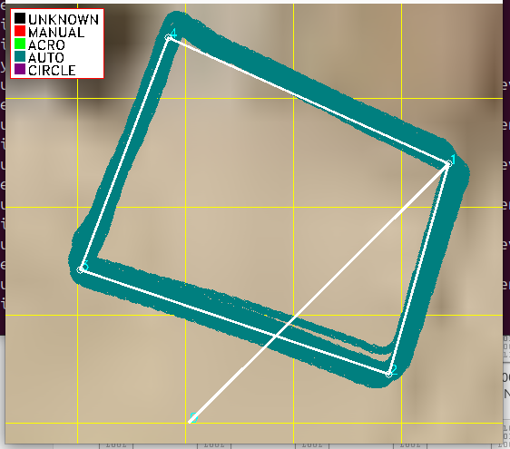

I set up a 3x2m mission on my driveway, set to AUTO and tuned as per
the Navigation tuning guide.
The final values were:
PSC_VEL_P   5
PSC_VEL_I       1
PSC_VEL_D       0.5
I did note that increasing PSC_VEL_P higher than 5 led to overshoot during turns.
And here’s a quick video of the rover:

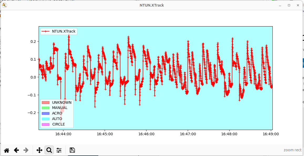

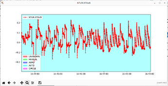

The Cross-track error was less than 0.25m and typically less than 0.15m, as shown on the following map and graph:
I did note that overshoot was greatest at the WP4 turn. I suspect this was
due to the WP4->WP1 being a downhill section and the vehicle overshot a little
with the sudden downhill change.
