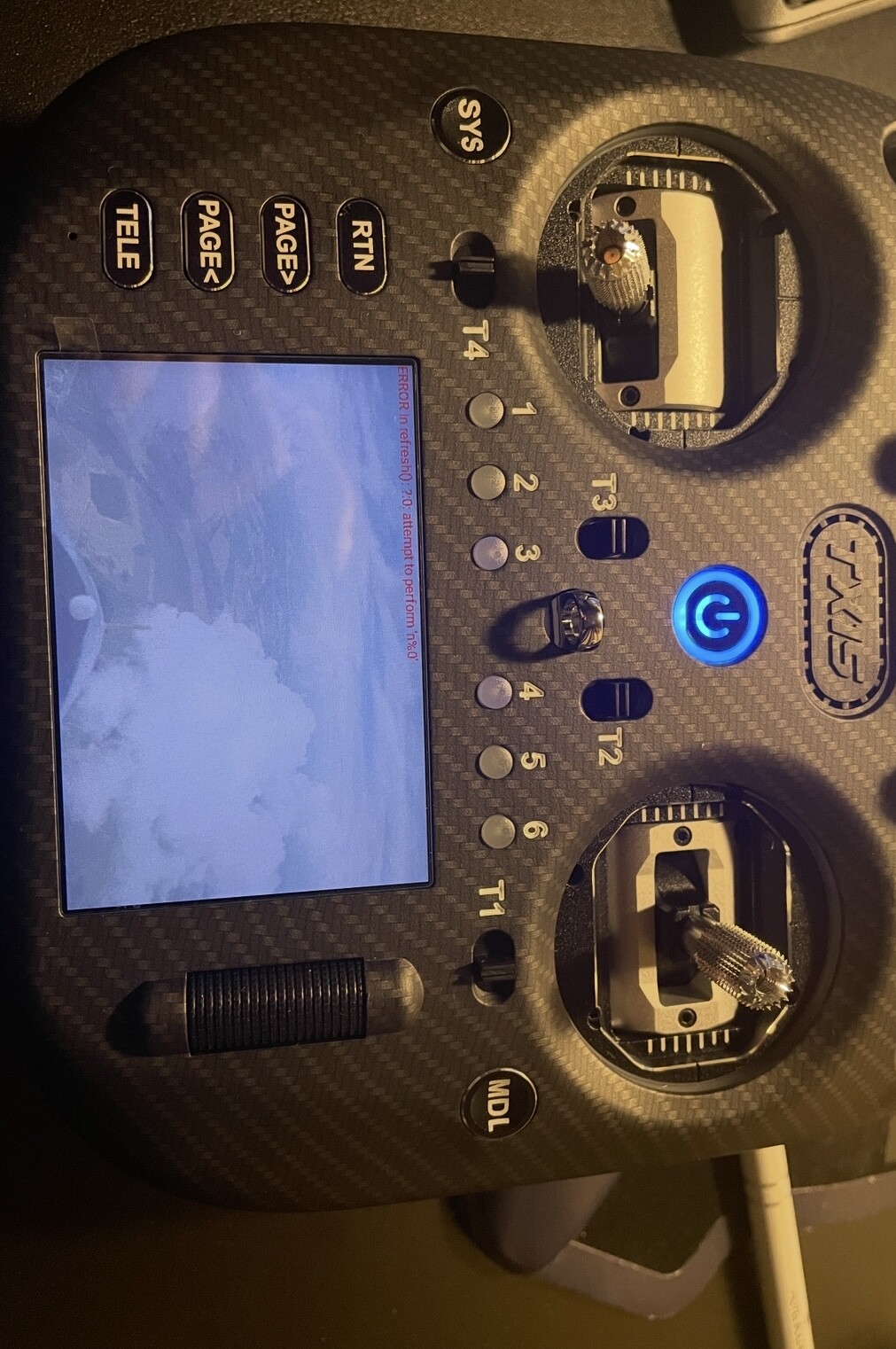

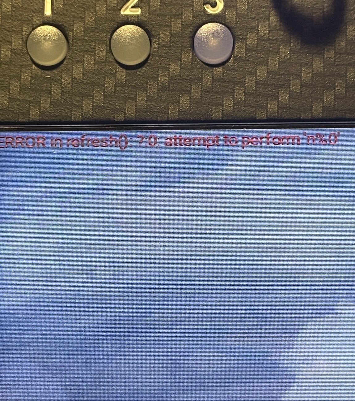

I am switch all my quads to Tx15 radio, I got the Yaapu working but as soon as I start to fly screen is crashing (see pics). Also I notice the messages are not showing up at the bottom but rest of the elements are updating.
SD card content were downloaded today (c480x272). I tried changing packet rates and telemetry ratio but same results.
Use Yaapu in the link below. Works fine with the latest EDGETX firmware/TX15.
GitHub - yaapu/FrskyTelemetryScript at pr/lua53
Try 480x320 instead of 480x272.
Thanks, files from the pull request worked. Problem solved!
Anyone landing on this discussion, TX15 has a 480x320 screen and don’t forget to also copy the color images file “Color_Common”
