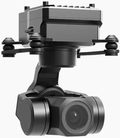

We’ve just recently added support for the XFRobot series of camera gimbals and we’d love it if some beta testers would be willing to give it a try and report back.
The setup instructions are here but one key thing that isn’t mentioned on the wiki page is that you’ll need to use the Custom Build Server to create a 4.7 firmware that includes the new driver

Hi @julled,
We’ve only tested with the Z-1 so far but my understanding is that they all use the same protocol so they should all work.

I got the Z-1 Mini working with TCP over PPP using:
NET_Px_TYPE = 3 (TCP Client)
NET_Px_PROTOCOL = 8 (Gimbal)
NET_Px_PORT = 2332 (from XFR documentation)
NET_Px_IP0 = 192
NET_Px_IP1 = 168
NET_Px_IP2 = 144
NET_Px_IP3 = 108
rtsp works using rtsp://192.168.144.108
(i.e. there is no tag at the end that most other cameras have)

Here is what is buried in the GCUPrivateProtocol.pdf in the GCU_Assistant download…
Network Configuration
UDP mode: The source port is 2337 and the default destination is the
LAN broadcast address. The target port is 2338.
TCP Server mode: The opposite end should be set to TCP Clint mode.
The remote IP address should be the same as GCU, and the remote
port should be 2332.
