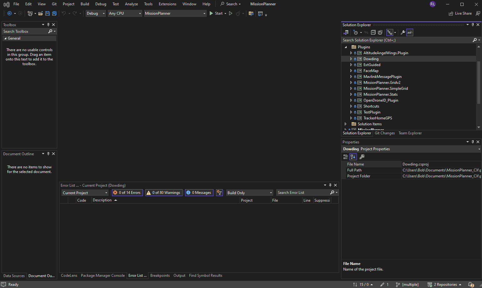

  1. Add a new project in the Plugins folder.
    a. Create a WinForms project.
    b. Move the project location within the plugins folder of the repository and give it a name.
    c. .NET version selection does not matter (we will override the project file in the next step)
    d. Double click the project to open its .csproj file.

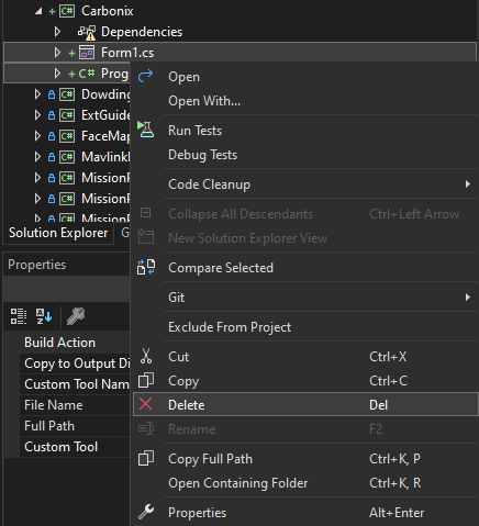

  3. Create the base boilerplate code.
    a. Delete the existing code files.
    b. Add a new Class item to your project for the _plugin class definition, name it something like Carbonix_Plugin.cs.
    c. Edit the file to look like the example plugins we discussed in the first post:

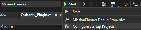

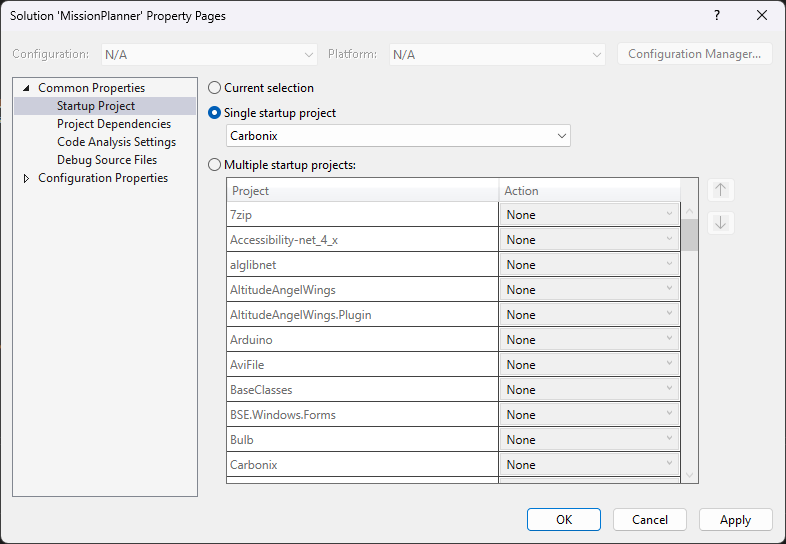

  1. Create a launch profile for the plugin. This makes it so the plugin compiles automatically when launching the debugger (when launching the Mission Planner project, only the dependent projects get built).
    a. Open “Configure Startup Projects”.
    b. Select your plugin and hit “OK”.

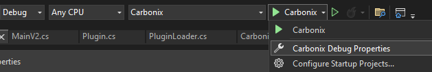

    c. Select “Debug Properties” for your plugin.

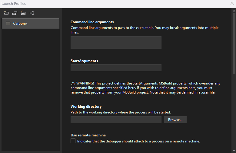

    d. Create a new executable profile that executes ..\MissionPlanner.exe
    CarbonixLaunchProfile

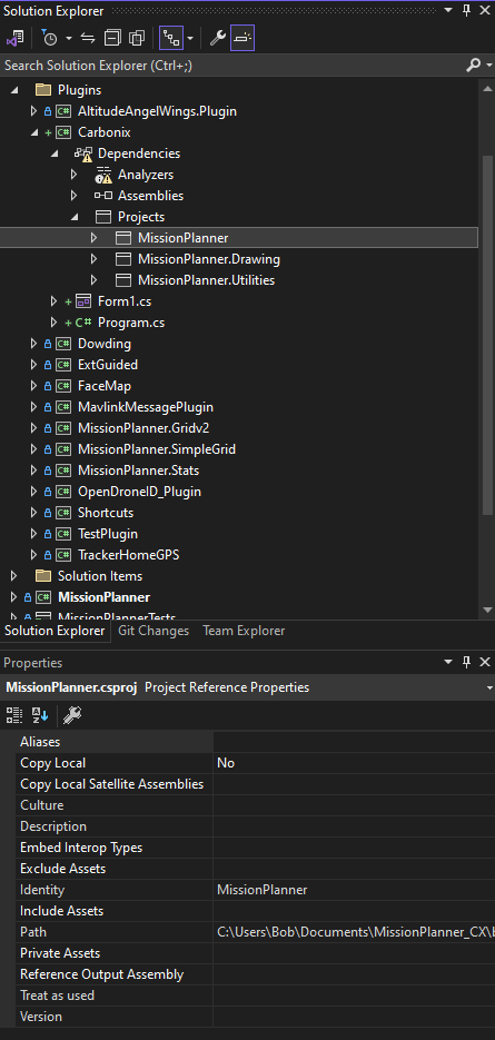

If you need to add more dependencies later, don’t worry about doing it in this file, you can use the Solution Explorer and Properties panes instead. When you do this, there are two important settings to get right:
  1. MissionPlanner.Drawing needs the Alias Drawing, or you will get build errors complaining about the ambiguity between System.Drawing and MissionPlanner.Drawing
  2. “Copy Local | No” (or, in the csproj file: <Private>false</Private>). This stops Visual Studio from making unnecessary copies of dll files for each of these references and dumping them into the plugins folder. Don’t forget to change this setting every time you add a new reference (whether it’s a project reference or an assembly reference).
