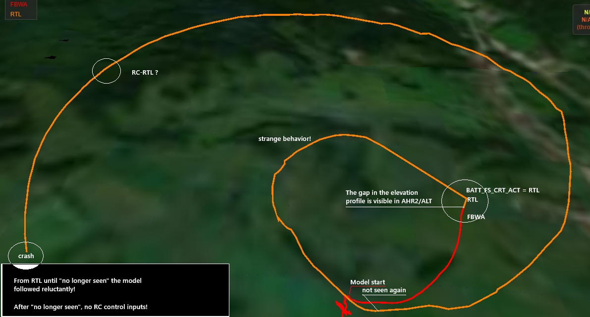

After starting (FBWA), the model seemed to follow the control inputs, but after a planned 180-degree turn, the model reacted unusually, and the motor apparently wouldn’t shut off.
After checking the transmitter, I lost sight of the model and switched to RTL.
The model didn’t appear at the RTL/Rallypoint position.
According to RTL, the autopilot automatically switched on the motor (RC TX Motor off) but did not respond to the pre-selected altitude of 60m.
The model then crashed to the ground with the motor running.

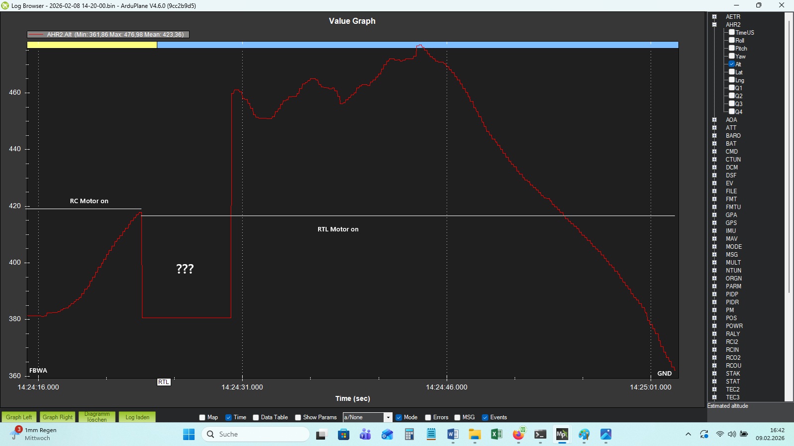

The altitude graph shows signal drops, which shouldn’t be the case given the flight path.
I couldn’t find any correlation between these drops and the map recording.

Something went awry with the AHR2. (There are other estimates of altitude onboard, and they did not “zero out” like that.) I did not look specifically into it yet. Assuming by “the kink” you mean the sharp corner which precedes an unrealistically straight portion of flight, I assumed that’s merely connecting the dots which are missing while the estimator has stopped functioning. The aircraft (of course) did not actually fly that sharp-corner-then-perfectly-straight flight path.

The gap in the elevation profile is visible in AHR2/ALT, but not in BARO/ALT!?
Something seems to have gone wrong in AHR2.
The model’s flight path was controlled and observed until the southern part of the map recording. Here, the flight path apparently matched the control inputs on the RX-TX.
What was wrong was: the motor was switched off at the RC-TX, but it could be seen that the motor continued to run (apparently BATT had already switched to RLT here).
After checking the RC transmitter, the model was no longer visible. No further control inputs were made on the RC-TX. After a certain period, the RC-TX was switched from FBWA to RTL (only).
Now, after analyzing the timing, it can be determined that RTL (14:24:25) was triggered by the “voltage under load” (<11 volts). The RC transmitter only switched to RTL at 14:24:46. Therefore, the model should have flown to the home position (RTL_RADIUS=25m / RTL_ALTITUDE=60m) at 14:24:25, but it did not.
Instead, the model entered a stable circular path with a radius of 125m. The impact was at 14:25:03.
RTL (triggered via RC-TX or BATT) had always worked flawlessly with this model until now.
Why it didn’t work this time will probably remain a mystery forever.

The autopilot was activated at 14:19:09 under open sky. An engine test (ARMIN-OK) was performed at 14:19:13. The model remained at rest for 5 minutes (BIN/Bat/0/Volt) before being launched at 14:24:15.
At 14:24:25, the autopilot itself activated RTL (BATT_FS_CRT_ACT=RTL / <11Volt). RC-RTL was activated at 14:24:46 (FBWA / RTL), using channel 5 (BIN/RCIN/C5). Crash on 14:25:03
From launch, the model flew steadily from 380m(?) (field altitude 360m) to 468m and then descended steadily to 360m (BIN/AHR2/Alt). See also BIN/AHR2/Alt for BIN/BARO/Alt.

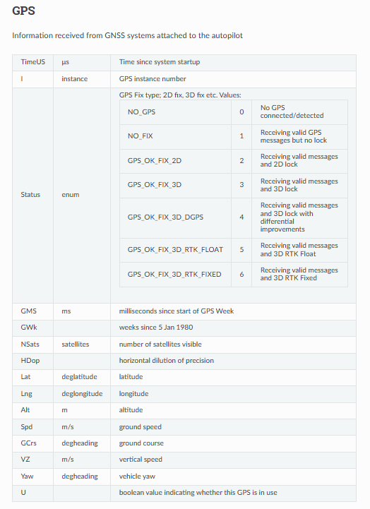

Is the following information stored in the BIN file, and where? […]
Number of GPS satellites
The fact that Rolf knows you reached a maximum of 4 satellites says “yes”. I think it would be a great task for your current level to attempt using the documentation + available tools to find this yourself.
After you try for a while, if you still can’t find, post back explaining what you were able to find successfully in the bin, and how you searched for the GPS # satellites info but could not find it. (I believe you will find it, and won’t need further help with that.)
I second Rolf’s recommendation: reset to stable + default params, revisit the basics, and build from there.
Here’s a good resource for decoding the data points in the .bin file.
For example GPS.NSats:
