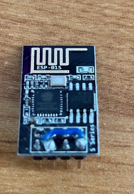

I use ESP8266 radios on a few models. They work great. The ESP-01 version that cost ~$1.

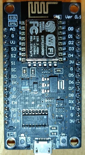

Do you recognise the model on the picture?
It seems it has not boot-loader at all. I want to flash it with original first to make it working.
Got it: NodeMCU v3 it’s ESP8266 not ESP32…
Let play so …
Yea, it’s a breakout board for the ESP8266 chip with USB support. But this is really all you need:
Got your point but have two of them.

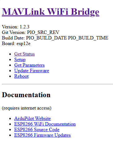

ArduPilot/mavesp8266: ESP8266 WiFi Access Point and MAVLink Bridge
It was easy, as for first time with ESP8266
Can’t get it running. I lack sufficient knowledge in MAVLink connections using TCP/UDP
Edit: Running !!

My board is hit by GPIO1 Low issue so I have to power it up first then connect TX …
GPIO 0, GPIO 1(TX) & GPIO 2 should not be pulled ‘LOW’ at boot, that means anything you connect to those pins as an output, should be connected ‘Active LOW’
This equipment can be used with the Ardupilot. I made a video of how you can do it. Installation of telemetry for the Matek-743 WING flight controller with a Wi-Fi ESP8266 module on the Ardupilot platform. Video link: https://youtu.be/uVl9arYoZhU Module description, firmware and link configuration: ESP8266 wifi telemetry — Plane documentation Adding Wi-Fi telemetry to the Pixhawk flight controller with an ESP8266 module - Ray's BlogRay's Blog MavESP8266 firmware: ArduPilot firmware : /Tools/MAVESP8266/2021-10-15 Firmware Software: GitHub - nodemcu/nodemcu-flasher: A firmware Flash tool for nodemcu
Thank you!
I made it running but have to tweak code a little.
Serial port has to be moved to other pins to avoid GPIO1 LOW lock on boot.
It was strange it was included in the code but commented out by debugging define
Could be author used to debug all the time or had other board.
