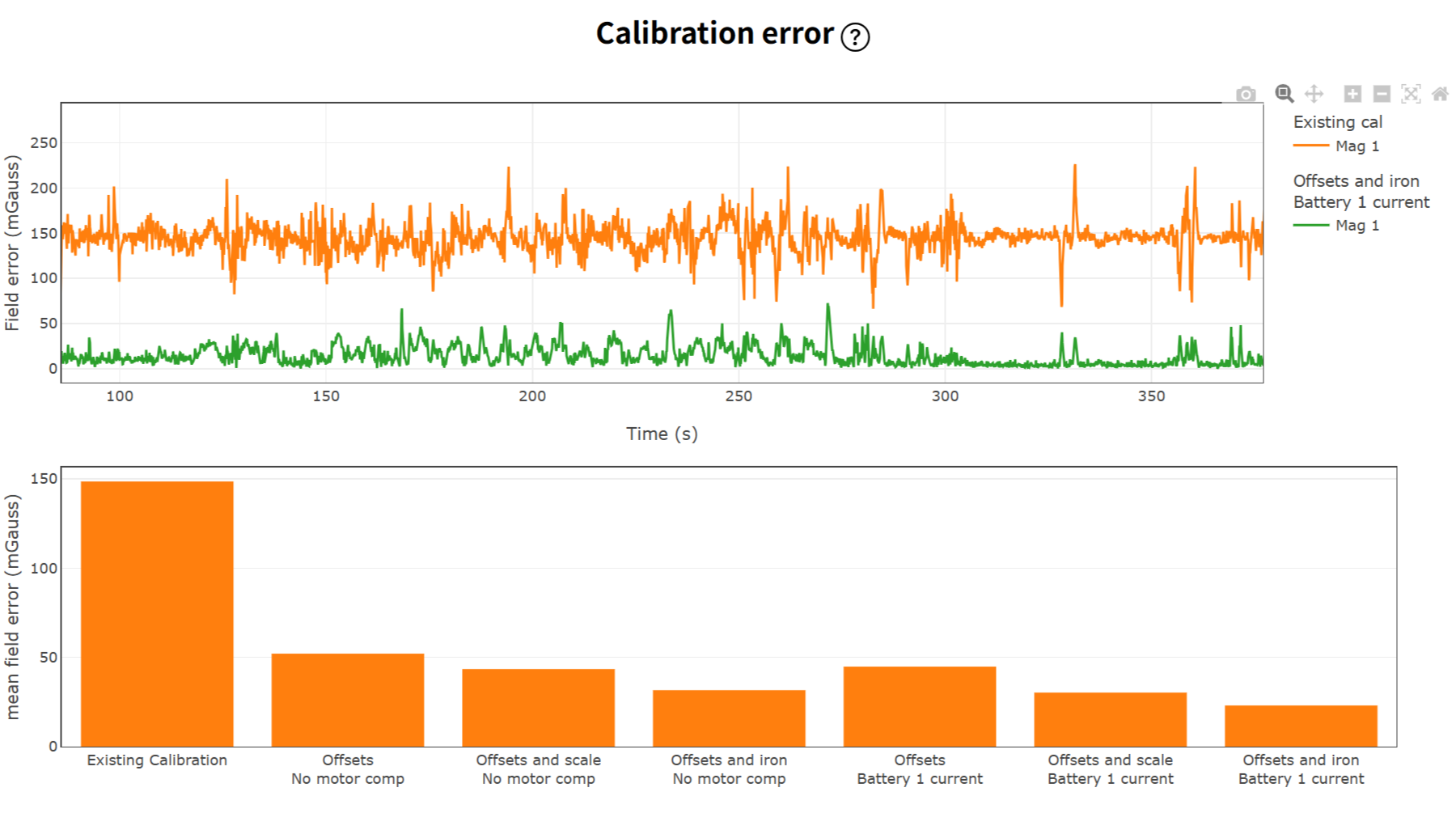

Hello everyone,
I have a question about ArduPilot MAGFit in-flight compass calibration, and I’m hoping to get some guidance from the community.
I have two flight logs analyzed with MAGFit, as shown in the attached screenshots:

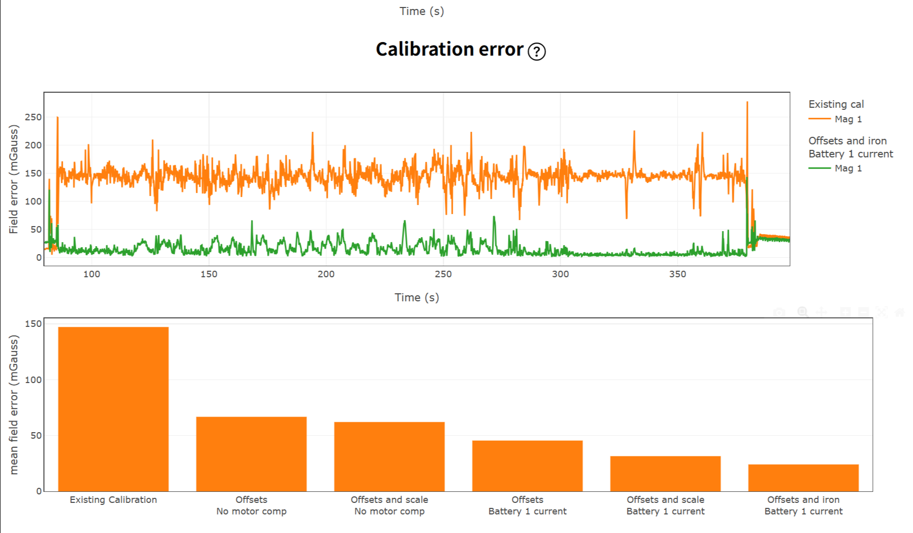

  • First log (024): This is the flight data after performing a ground compass calibration. When I analyzed this log in MAGFit, it showed that the average heading error of the ground-calibrated compass was over 200 mGauss. MAGFit predicted that if I applied the “Offsets and iron + Battery 1 current” calibration (current compensation + soft iron correction), the average error could be reduced to around 24 mGauss.
  • Second log: I then uploaded the MAGFit-generated calibration parameters to the flight controller, performed a second flight (manually flying figure-8 patterns, with coverage >30% for both compasses as shown in the tool), and re-analyzed the new log with MAGFit. However, the actual average heading error after calibration is still around 150 mGauss, which is a huge difference from MAGFit’s predicted 24 mGauss.
I’m confused about why the predicted error reduction from MAGFit is not achieved in actual flight, even though I flew figure-8 patterns and the coverage percentage meets the requirement. Could anyone help me figure out the possible reasons for this discrepancy?
Thank you in advance for your help!:MAGFIT SCREEN SHOT IMAGE

I have already calibrated the BATT_AMP_PERVLT parameter by the following method: I flew a fully charged battery for 10 minutes, checked the discharged capacity shown in the ground station, then recharged the battery to full and compared the charged capacity with the discharged one. After multiple flights, I found the difference between the discharged and charged capacity was within 100 mAh. After such calibration, is it still possible that inaccurate current readings from the current sensor are causing the poor compass correction results?
Thinking out loud and someone correct me if I’m wrong here… if the stock BATT_AMP_PERVLT was incorrect, then your discharge capacity would be incorrect on the ground station from the start. Wouldn’t you want to check how much discharged or, alternatively, how much got charged on the charger?
You used the correct battery current calibration method, that should not be an issue.
For magfit to work well do a flight with plenty of yaw, circle and some ascent and descent - generally give the copter a good work out.
Try choosing the “Offsets and scale, Battery 1 current” calibration. I’ve found that choosing the “iron” calibration can be overly sensitive particularly if changing payloads that may affect any magnetic fields.
