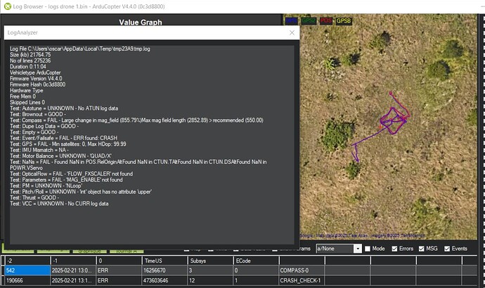

Hi, I would like to ask for help analyzing why my drone is shaking so much. I wonder if it’s just a “balance weight” issue or something else
Here is the log file
And a screenshot with logAnalyzer + filter by “ERR” messages type:
The last ERR msg reporting a CRASH is related to another issue (in fact the drone landed very well before).
I’ve seen that compass complains about mag, I’ve got two of them configured:
  • Primary: AK09916
  • Secondary: the internal inside the pixhawk 4 mini

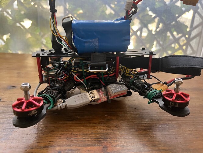

As you can see in the following pics, I’ve mounted the external gps far from ESC, so why I still have mag issues ? is it’s related to the shaking issue ?
I can add more details if required !

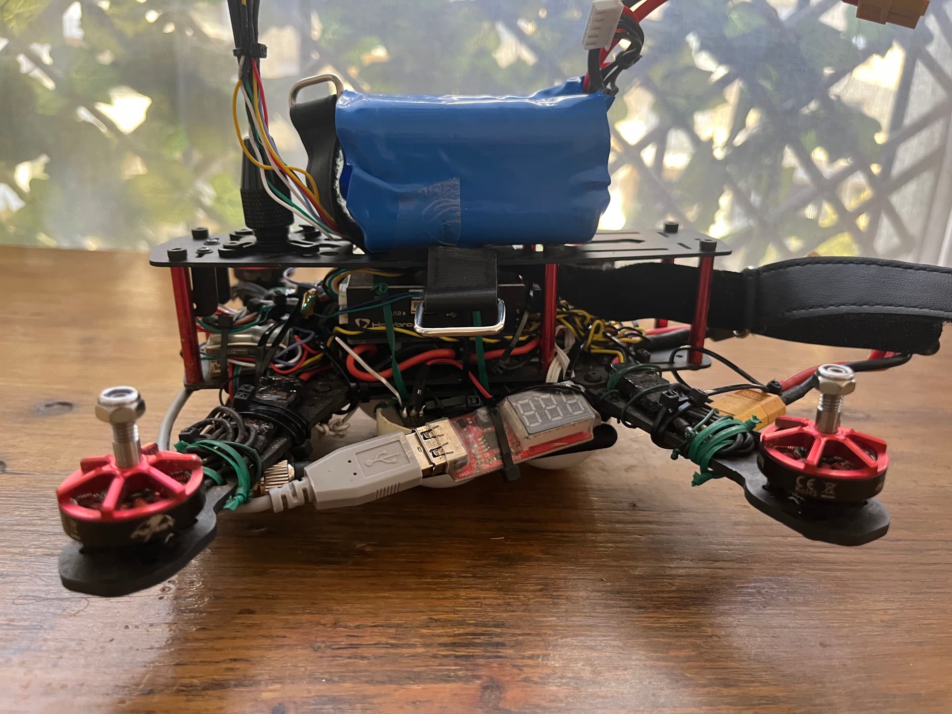

LiIon on top of pixhawk? They tend to generate some mag fields.
I would start from disabling internal pixhawk compass.
PS - did not take a look into logs, but had similar issues with own build.
And… do some cable management - keep wires between power hungry parts as short as possible. Making a coil from motor wires for sure does not help :wink:
Thanks for the help !
Yep, it’s li-ion. Better using lipo to avoid mag fields ?
EDIT: also I’ve noticed that the “dampers” (under the pixhawk mounting) are not made of rubber but are plain plastic as presented on the holybro commercial picture
I think your FC already has internal dampening. Possibly try hard mounting with two sided tape.

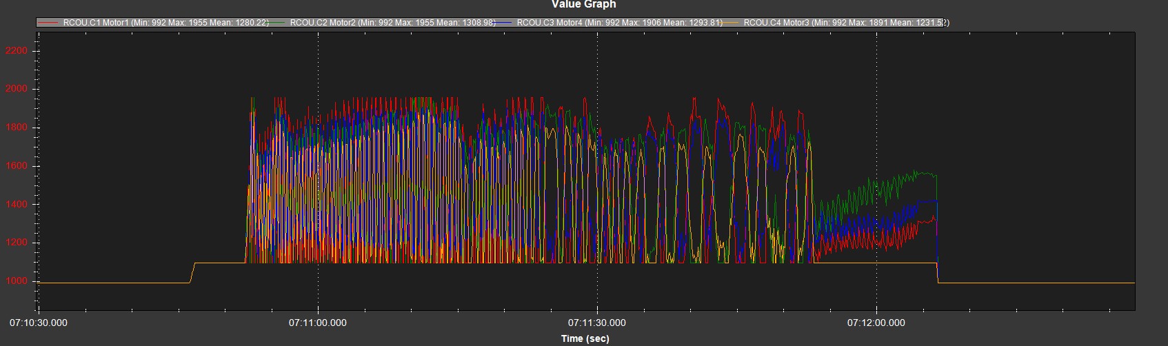

You are on old firmware and using default parameters. And this is the result of using default parameters for that craft.
Massive output oscillation. Note that this has nothing to do with levels of vibration which are not high.
Update to latest Stable version and at your level of knowledge work thru the Methodic Configurator. Use search here on the forum to find it.
BTW-The Auto Analysis Tool is useless. It is way out of date.

Also, can you explain me how you find this oscillation graph, ideally from my .bin file ? and how It should looks like to get cleared of the oscillation ?
EDIT: I’ve just started reading the hardware to avoid pixhawk 2.4.8 :rofl:
It’s a PH4-Mini right? Just use Mission Planner and update it to latest Stable. Then start with the Configurator.

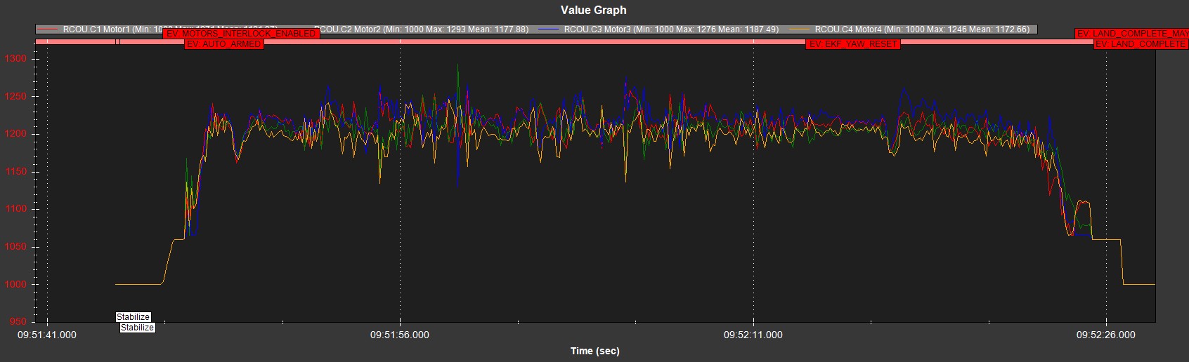

The filed to graph are shown in what I posted. RCOUT. It should something like this at hover not oscillating between Min/max output:
