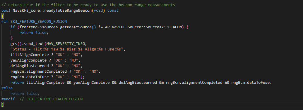

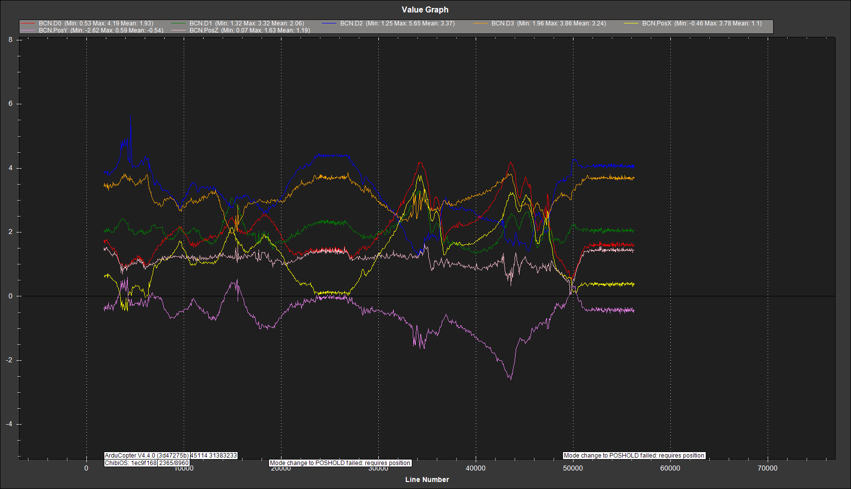

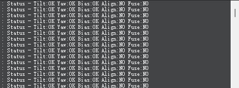

sorry,I configured the relevant parameters according to the official website. The log can read the data from the beacon, but when switching from the althold mode to the poshold mode, an error occurs and it requires position.I am using the F405aio main controller.
You need to provide a dataflash bin
What is the reason for this? Is it because my UWB has too high a delay?
