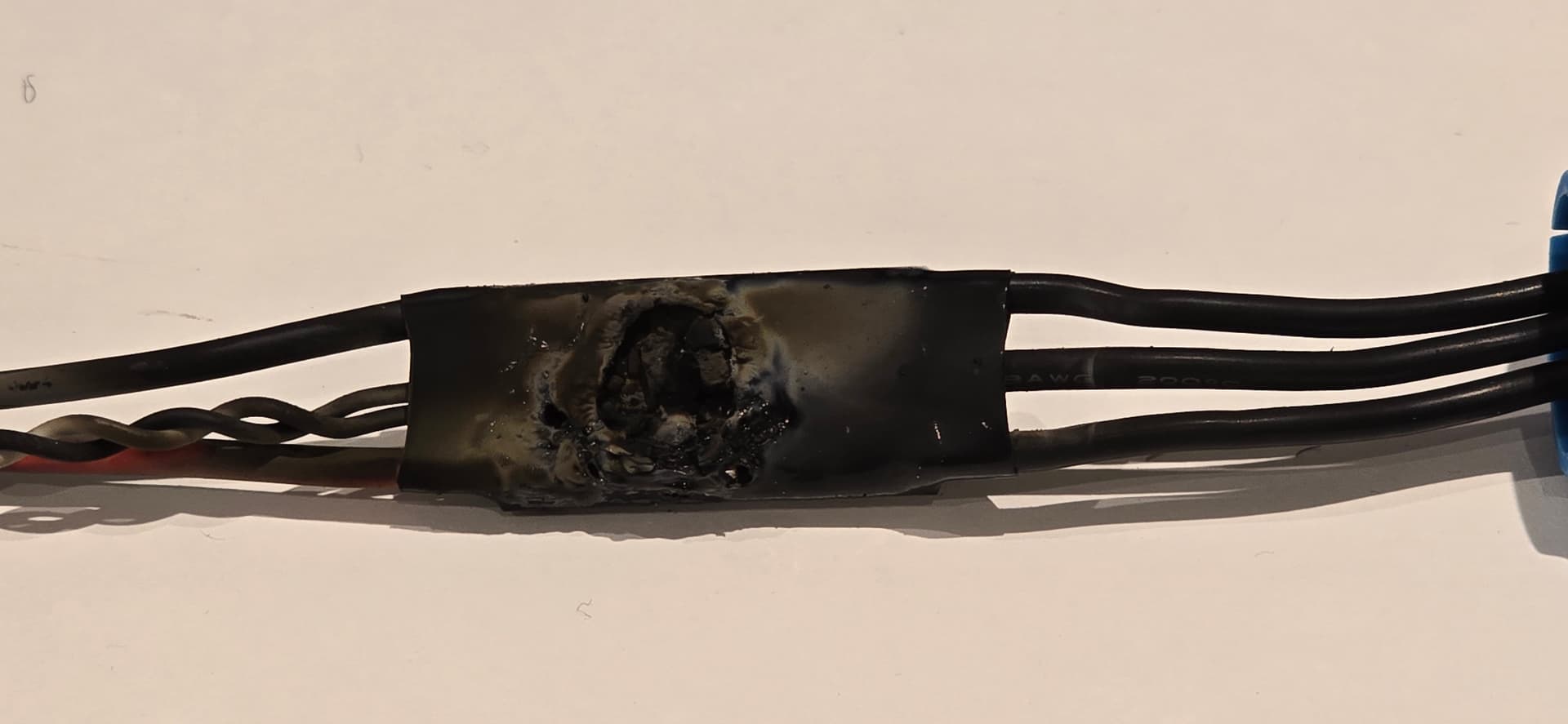

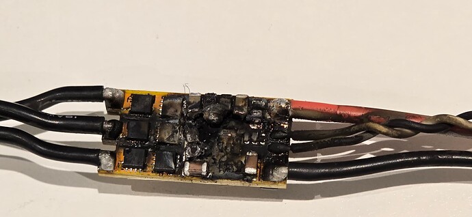

After connecting the battery, I noticed a spark and quickly disconnected the battery. To see where the spark came from, I had to connect the battery 2 more times until I noticed it came from M1 arm; there was a lot of smoke on the 3rd time. Not my proudest moment! Pictures of the toasted ESC are attached. After doing some research, I now know that DShot ESC’s do not require calibration.

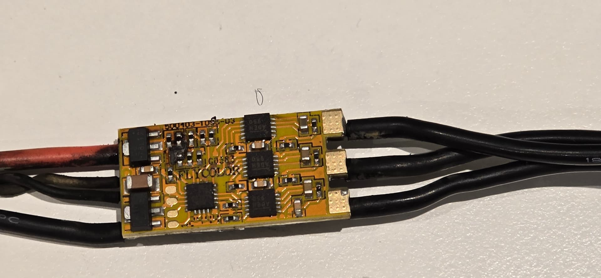

Only M1 motor was damaged. I inspected the other ESCs and there is no sign of damage. However, to limit any more ESCs from getting toasted, I’m only working with 1 ESC at a time for now. This ESC is constantly beeping and I’m not sure how to move forward. I’m guessing that the ESC calibration has changed the values on the AP only (and not on the ESC itself) but I’ve had enough magic smoke fill the room for one day.

That looks like a plain old fashioned electronics ESC failure. Just about nothing you can do with the autopilot can cause that, especially if the copter is not flying.
ESC calibration doesnt change anything in the autopilot, it just signals the ESCs to “understand” what the full range of PWM the autopilot will be putting out.
Agreed, electrical failure on input side. Maybe voltage rating exceeded, missing external capacitors, you name it. Happened while the motor was not actively controlled, otherwise you would see self-desoldered mosfets on the motor side.

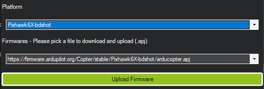

Just to be sure the BDshot version.
My bad! Yes, I am using Pixhawk6X-bdshot firmware - I thought it was dshot (missing b). Thank you for catching that!
Alrighty! I just set up everything and it seems like things are working; all motors are running nicely at 5% and they can all run at the same time when I run ‘Test all motors’. Not going to tempt fate and I’ll leave it as is until I flight test it.
