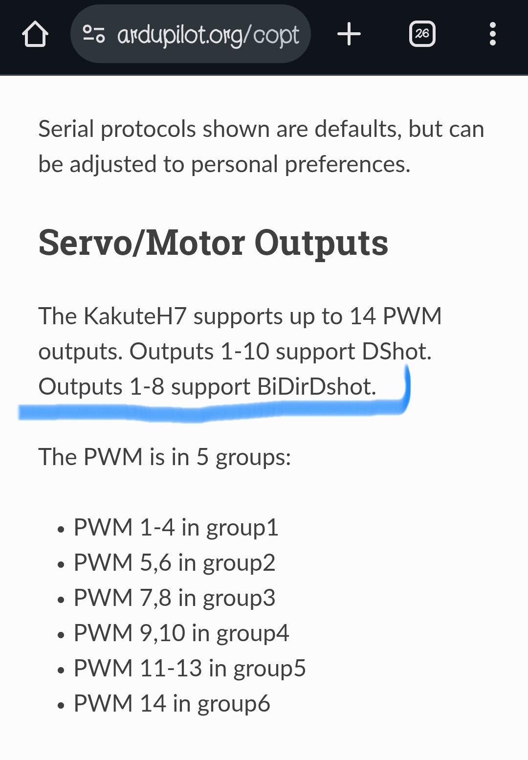

I am having confusion regarding which pins of the Kakute H743 wing support BDshot. The cause of confusion comes from these 2 sources:

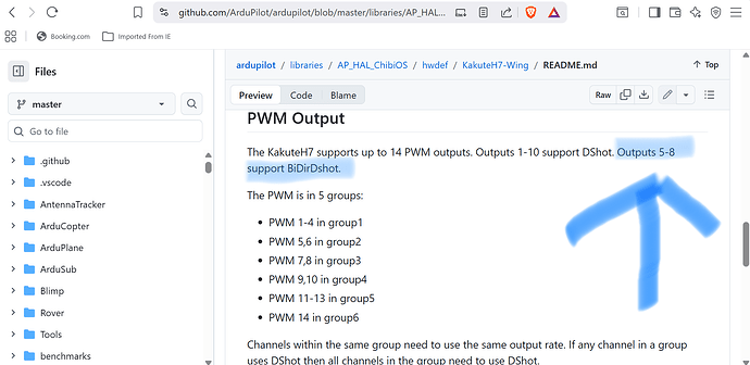

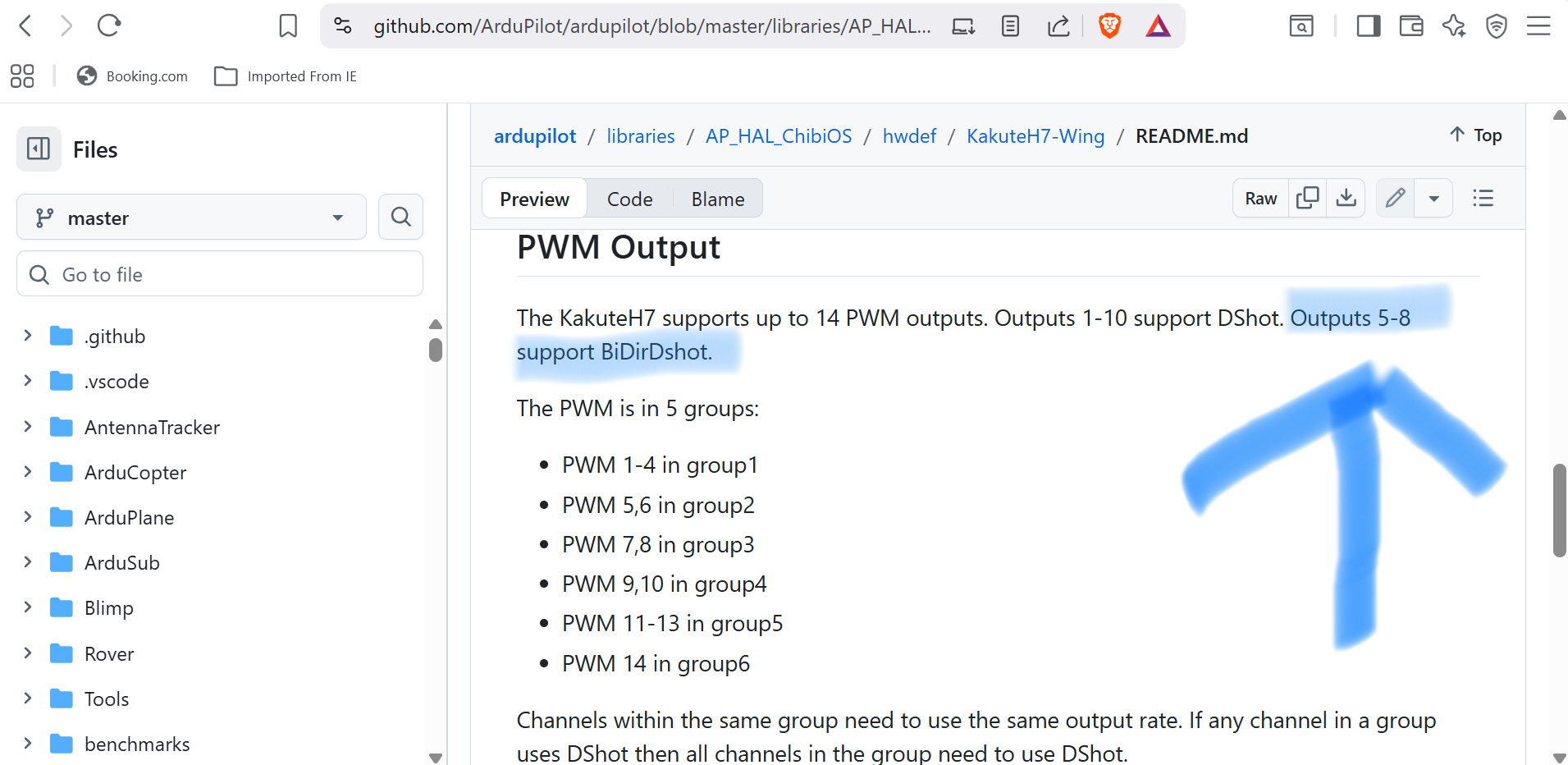

One is the official ardupilot wiki, where they say “Outputs 1-8 support BiDirDshot” and the other is the GitHub documentation which opened up automatically when I created a new template of My quad in Methodic Configurator, which says “Outputs 5-8 support BiDirDshot”.
The question is, what’s the truth?

But, there does seem to be a discrepancy between the README (board description) and Hwdef.dat for this board.

And the README and Hwdef do not agree.

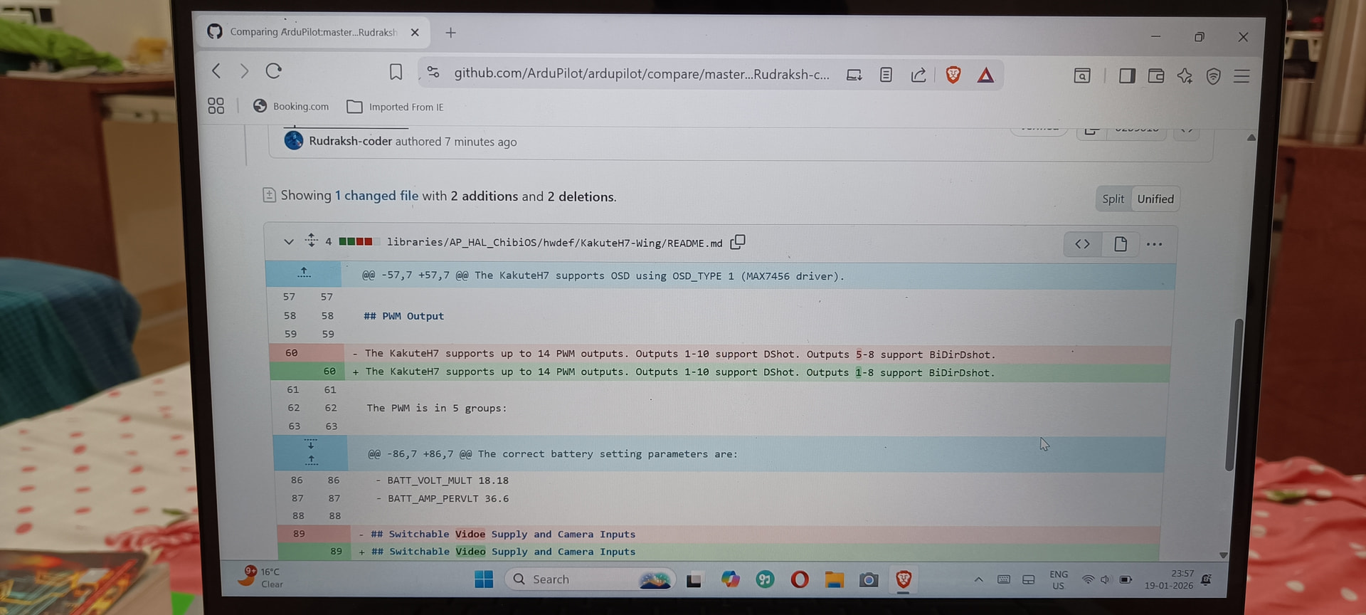

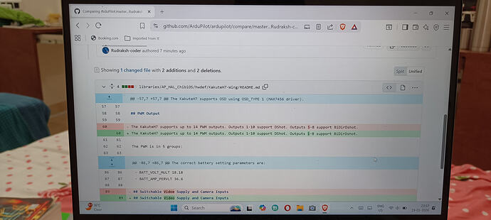

As for the readme and hwdef file, I have proposed changes on GitHub by correcting the number “5-8” to “1-8” =>
