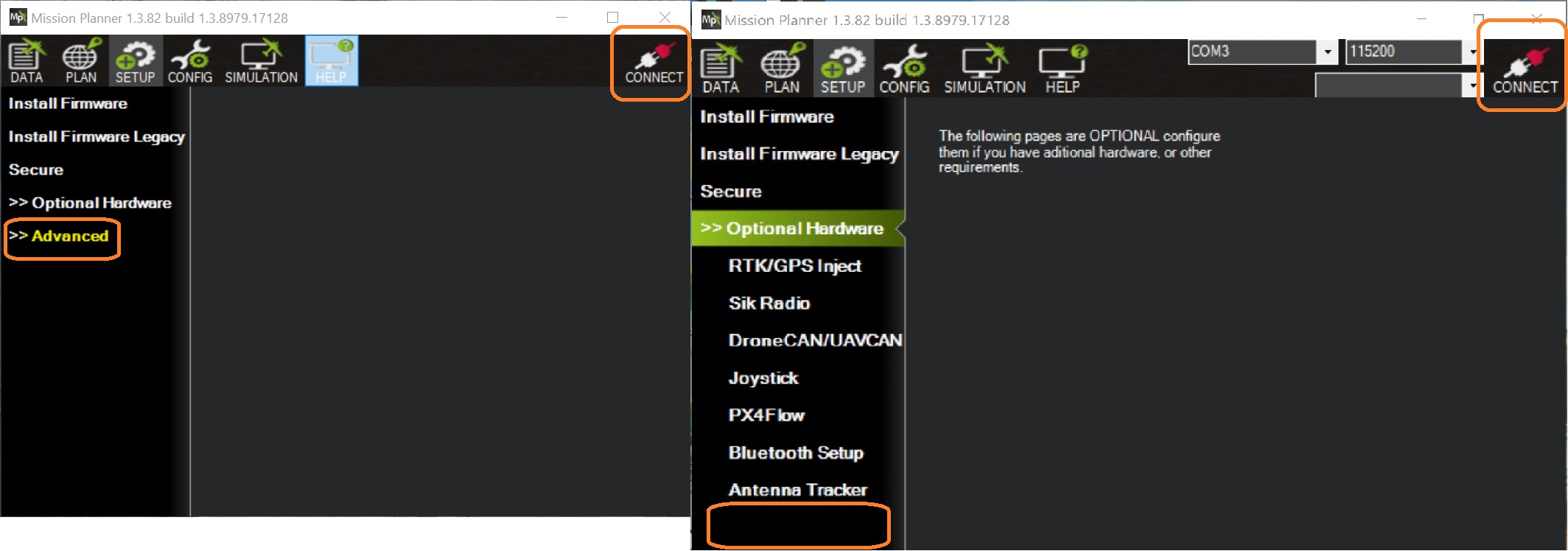

Can someone explain why the identical Mission planner installer stable version has a missing interface when it is not connected to the flight controller unit on a different computer? Where is the Advanced?
one had a previous install and enable advance mode in the Mission Planner options.
I never remember if that is in Help or Config
Config>Planner>Layout>Advanced
