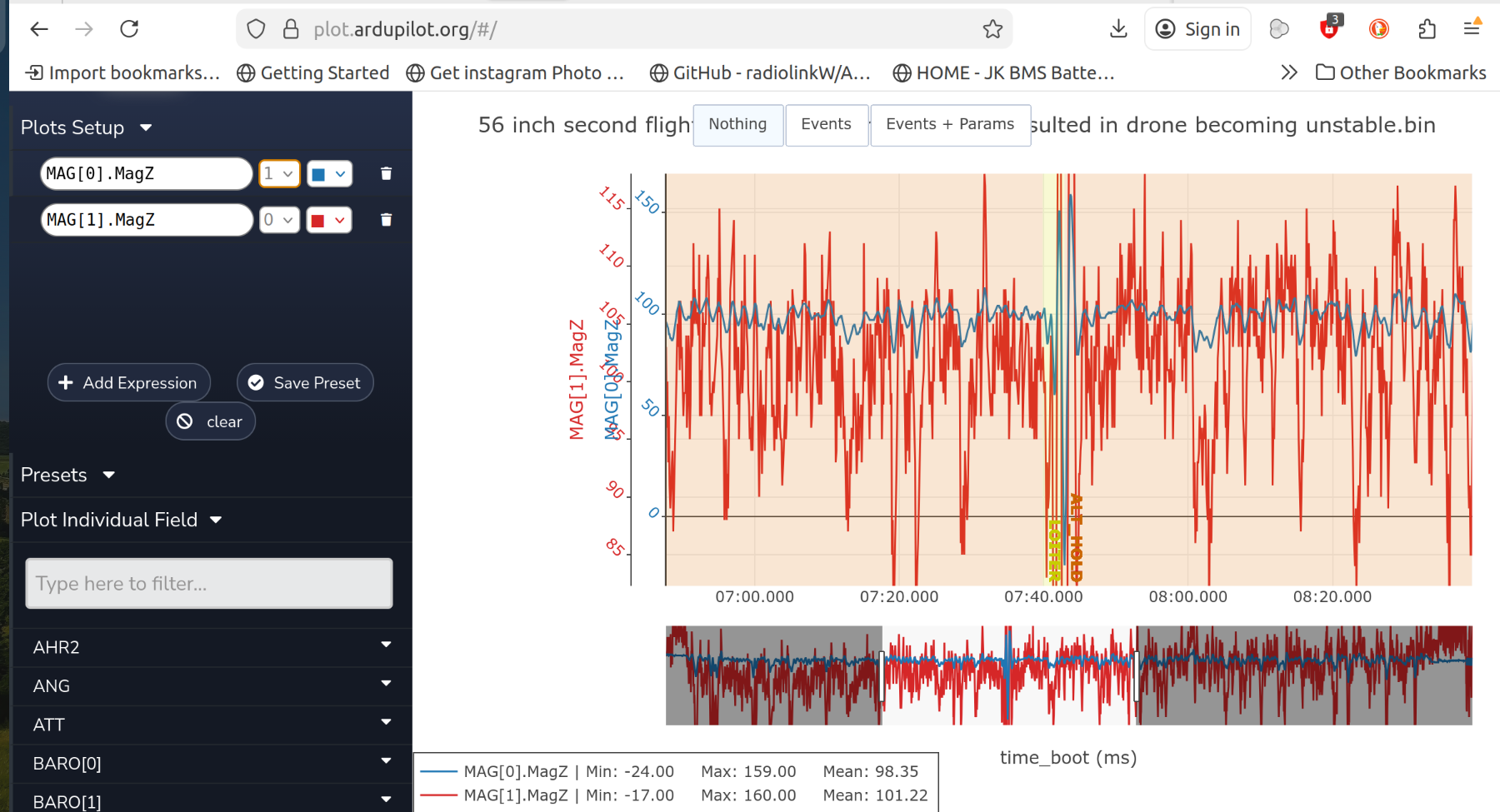

Hello Team,

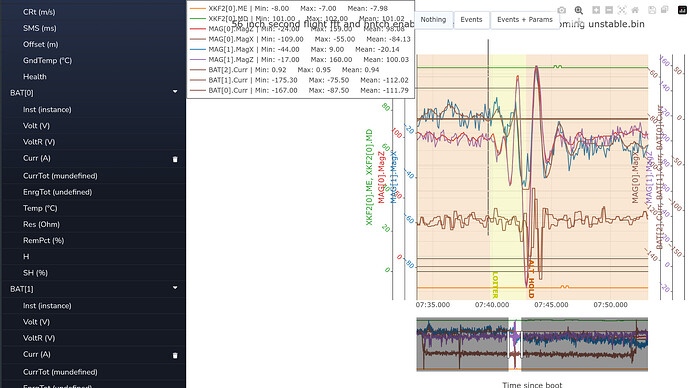

During the second flight of a large Octaquad-X copter with 56” Props where GPS module’s compass is the primary and only source for heading, switching from alt-mode to loiter resulted in copter becoming unstable. the plot below shows mag-x and mag-z field changing rapidly for both used-external compass and for unused-internal-compass. BTW, gps has been mounted at a very far off place from motors(0.75m away) and batteries(1m away). Because of sudden mag-x and mag-z changes yaw is getting induced which is resulting in current shooting up/down by around 40%-50% but it is phase lagging mag-x and mag-z changes and hence the suspicion that current changes causing sudden mag field changes is not intuitive from log plot. After switching back from loiter to alt-hold the copter becomes stable.

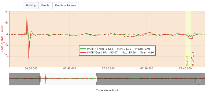

Feared giving yaw to the copter. is it safe to do with compass calibration not being good? well the copter is being flown very close to a sheet-metal warehouse(25 feet tall) and on the other side have street electric lines which is ~15m from flying zone.
Sure disabling compass for now could be one thing I can do to get data for magfit.
You performed a yaw earlier in the flight in althold mode. If you didn’t notice issues then, then it should be safe to do so regardless of the compass state.

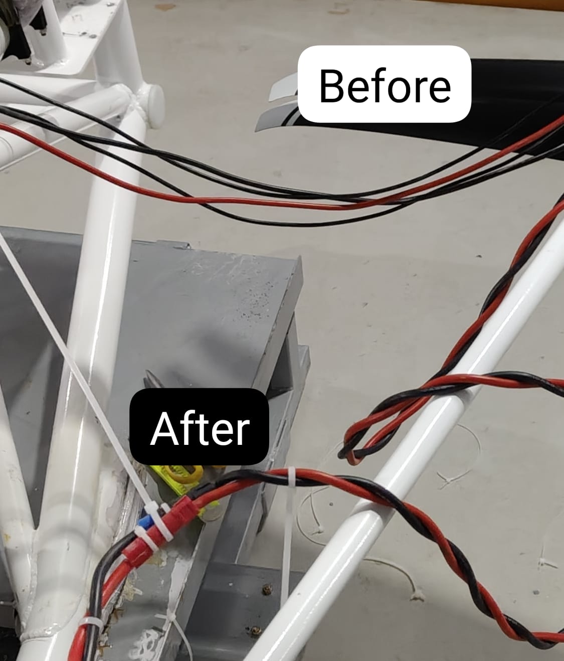

As a first measure, the wires(red/black) are running straight so before next flight will get it twisted to see if it can help reduce the magnetic flux near compass and get a better MagFit.
Can you also have a look at internal compass it is way to erratic compared to external one. is it because of the high current or is it bad? Internal compass is located in the middle of two 18S-Batteries around 400mm apart.
I doubt that it is bad, just affected by noise, but if you have the means to build a large system like this you’ll have to figure out how to get a safe space to conduct testing. If you have a log you want looked at then call it out
