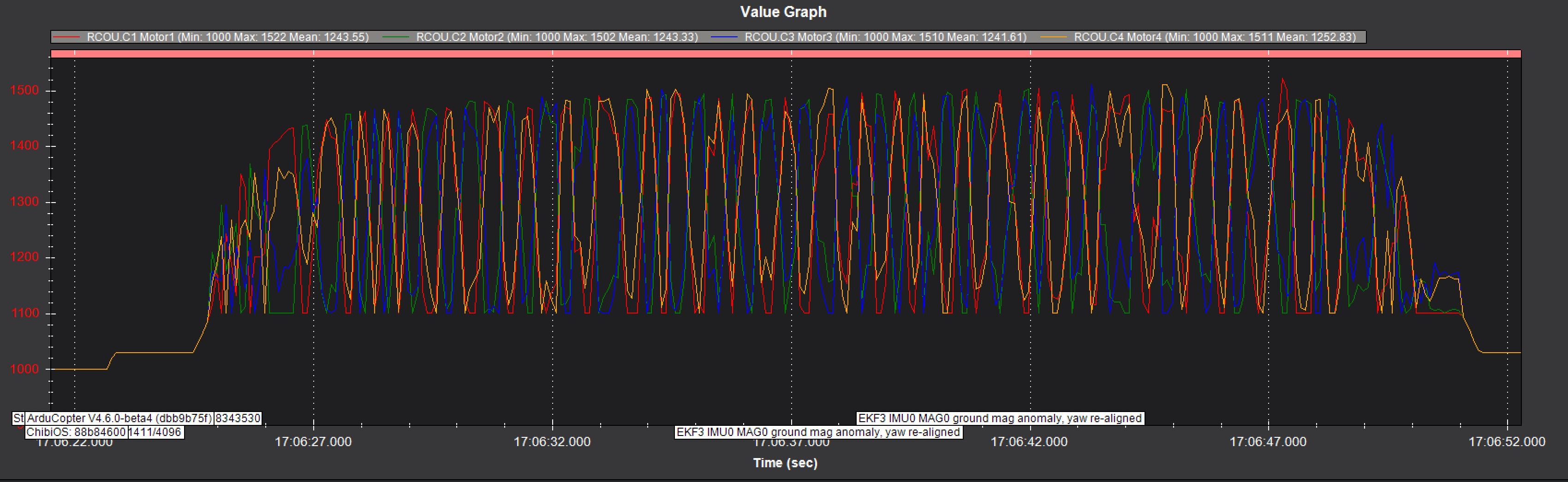

What are the first 2 things we want to look at in a log file? Levels of vibration and RC Outputs. This 4" has a very rigid frame and a well isolated FC so nothing to see for vibes.
RC outputs on default parameters:
This is what output oscillation looks like and you cannot advance with tuning until it is corrected. This was unflyable with visible oscillation.

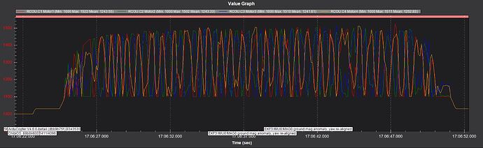

Well, what about the Initial Tune Parameter Tool in MP? Great idea, let’s looks at that:

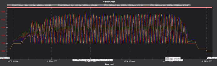

Hmm, doesn’t look good at all. Why not? Because for this craft, and many like it, the rate PID’s and the Vertical Acceleration Controller gains are too high. This had no visible oscillation and it’s similar to what we occasionally see with the pilot saying “it’s flying great” or some such comment.
The Hover thrust on this craft is ~0.125 so let’s adjust these:
Start by cutting the Rate defaults in half. These have been lowered further after testing.
ATC_RAT_PIT_D,0.0015 (Same for Roll)
ATC_RAT_PIT_I,0.05 (Same for Roll)
ATC_RAT_PIT_P,0.05 (Same for Roll)
Set these as per the wiki based on the hover thrust value.
PSC_ACCZ_I,0.25
PSC_ACCZ_P,0.125

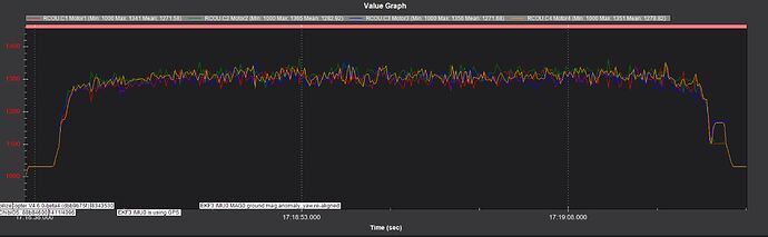

Now what do we see?
What we want to see. Now the tuning process can really begin!
