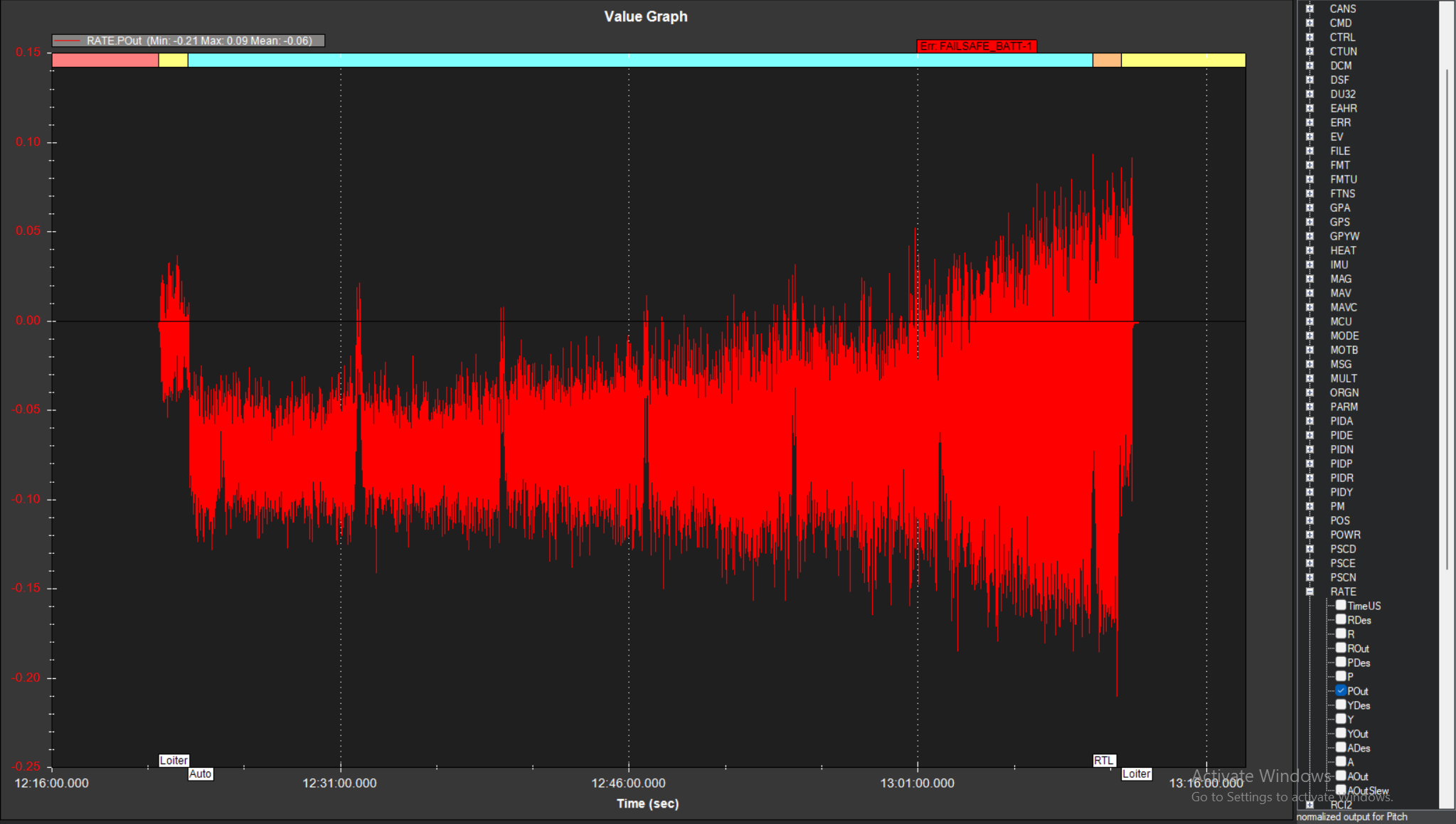

I got another copter which has been experiencing audible vibration near the end of long flights (30mins plus). When it is coming back, I can hear pulsing humming sound (but vibration level wasn’t increased.)

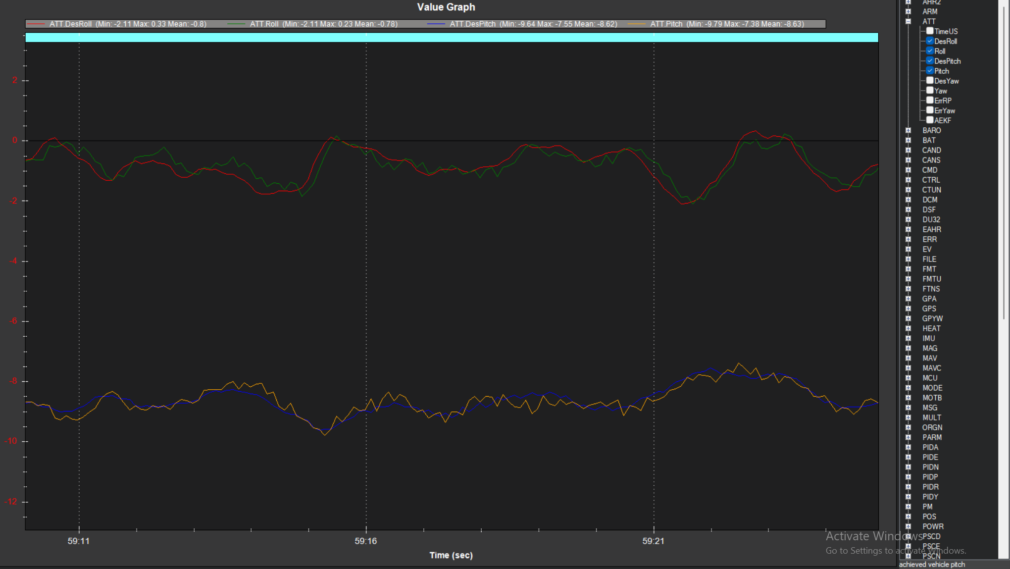

There is higher(around 20~30) X-axle vibration when it is flying into wind but it is not too bad without wind at around 15.
Rate.Pout is increasing like this. If I understood correctly, it increases when error between Desired and actual pitch increases. Then, why would the error gradually get bigger? There wasn’t increase in Rate.Rout. Would it have something to do with X-axle vibration? I also found Desired Pitch graph is not as smooth as that of Roll.

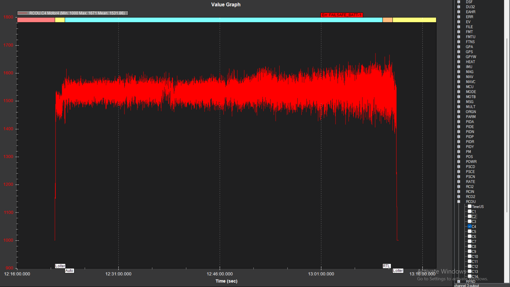

PWM ranges of all 4 motors look slightly wider at the end than begining of flight as well. This is only an example of motor4.

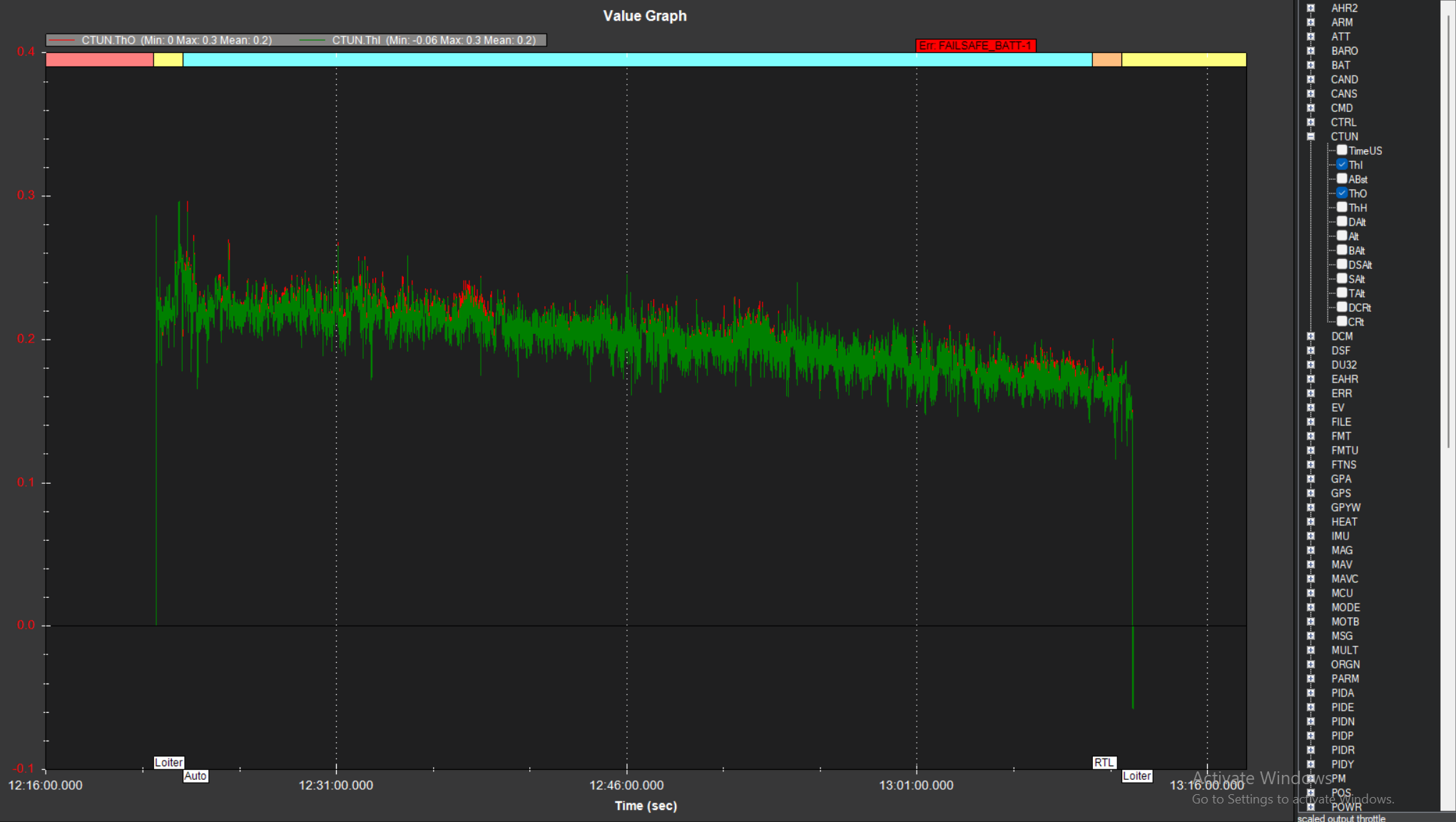

Throttle input and scaled throttle output values decreased. Would it have something to do with sagging battery voltage?
Someone said symptom could have something to do with MOT_THST_EXPO parameter. It is set as 0.65 now but Hobbywing X9 ESC might already has a linear output which needs 0.01 instead of 0.65 in that case. I couldn’t find a right answer for it yet. Or could it be MOT_BAT_VOLT_MIN/MAX params?

You have terrible oscillations in your motors. reduce pids and that will get better. your high vibrations are probably a result of the oscillations.
Also upgrade to the latest 4.6.3 firmware…
Thank you for taking time to look into logs.
You’re right. It needs proper setting from the scratch.
I was just wondering why oscillation wasn’t present at the beginning but gets worse as flight continued.
PIDs are scaled up based on your voltage drop, that’s might be why.
Thanks Mike.
That’s what I was suspecting too and that’s why also I wanted to set out correct MOT_BAT_VOLT_MIN/ MAX values. Is there any other params which can affect PID change on battery sagging?
I also was thinking MOT_THST_EXPO might have something to do with the symptom.

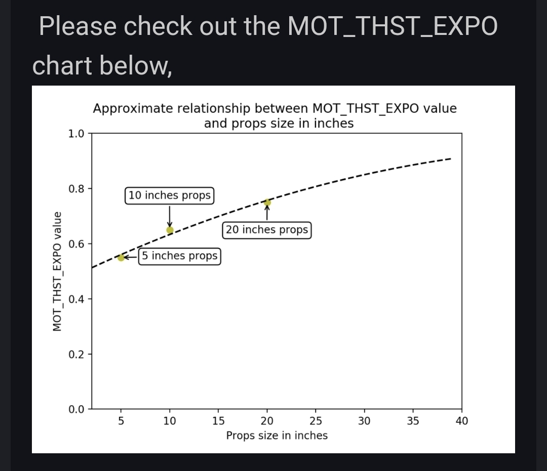

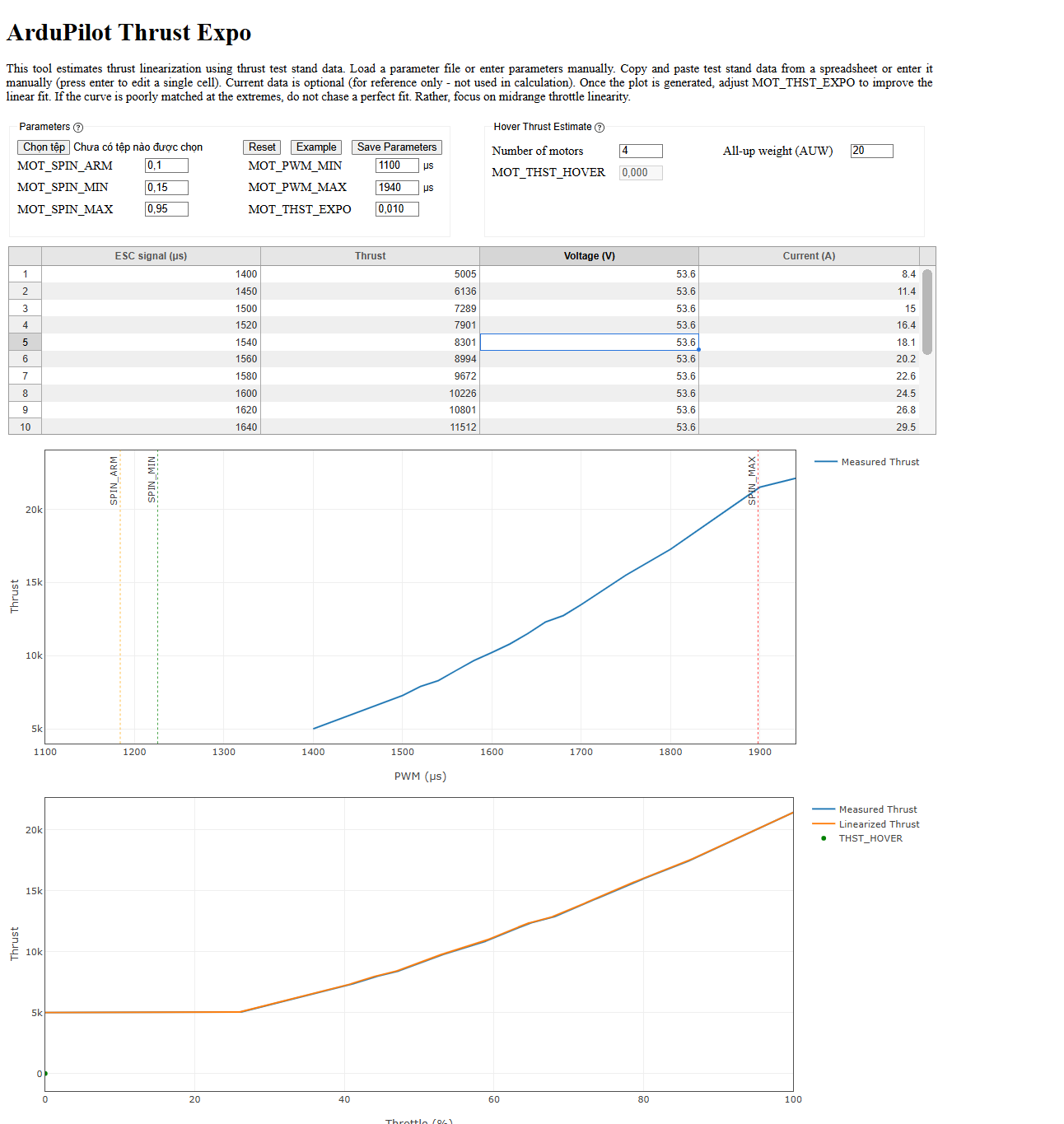

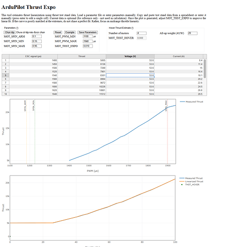

I referred to THIS thread first and also tried myself with data table on their website which resulted as below.
Later, on the other hand, when I asked hobbywing, I got only one graph from them.
And the staff I was talking to said yes when I asked him whether 0.9 would correct value for 34 inch copter. I couldn’t tell which is correct yet.
LOL. The graph from the Arducopter Tuning Guide. Thanks for the help Hobbywing!
I tried MOT_THST_EXPO 0.01 today and it worked. After several long flights, copter didn’t show any symptom of noise and visual vibration at all compared to previous value, 0.65.
It seems Hobbywing X9 motor/ESC package does come with output linearization.
