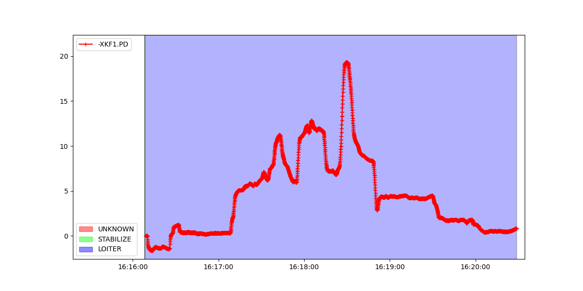

Here’s the time vs altitude plot. Can you identify the behavior you’re wanting me to dig into?

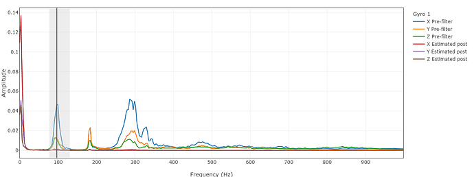

There’s noise in the RATE.xOut values. Start with the easy one.
From the wiki:
Your MOT_THST_HOVER is 0.13, so set:
PSC_ACCZ_I, 0.26
PSC_ACCZ_P, 0.13
You also don’t have any filtering enabled.
Do a flight to record the log data and then we can set up a filter.
INS_LOG_BAT_MASK,1
INS_LOG_BAT_OPT,4

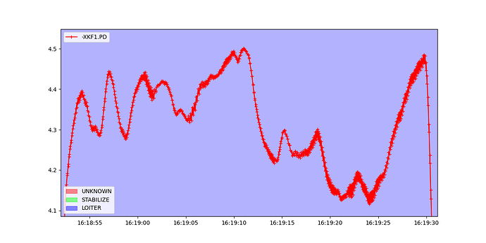

I zoomed in on 16:19 segment. I’m looking for ~10cm, 4Hz oscillation. I don’t notice it, but perhaps the EKF is filtering that out. Before I go digging for other traces of it, I want to make sure I’m in the right area.

Vibrations are high. You should look into fixing that, on the X and Z axis. Look for loose hardware or something bouncing on the flight controller.

i do not know the section in the chart… unfourntalty i am not super aware of how to read logs, thats why i am paying someone else to haha. i do not know if the EKF Is filtering it out?
where i experienced it most is the 16.19. where i was just flying forward 10ft then letting the drone brake (where it would do the jumping thing i am talking about)

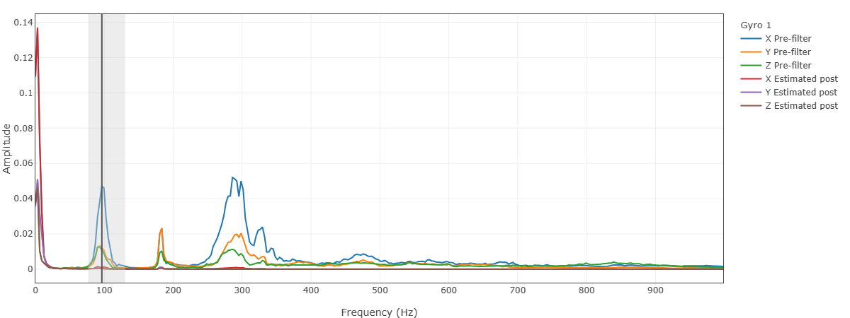

Vibrations are a mechanical issue. The filtering will help deal with some of the issues caused by high vibrations, but some of what I see in the logs is a mechanical problem and can’t be solved by parameters. Here’s some reading about it: Measuring Vibration — Copter documentation

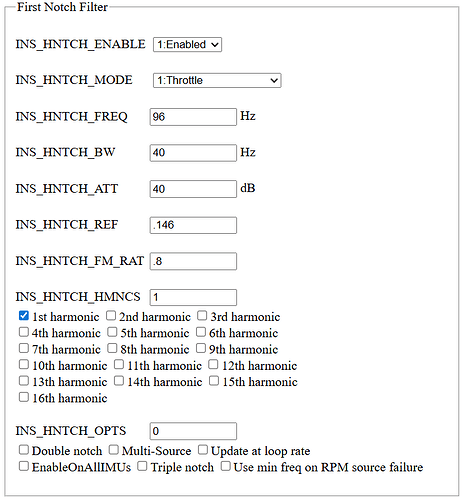

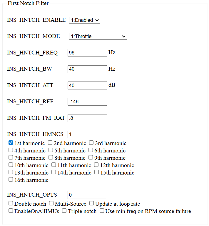

Here’s the filter settings I recommend:
