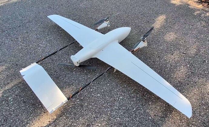

I have recently been constructing and tuning my own vtol tricopter. Here is a picture:
It is 2m wide, has a AUW of 3kg, uses 3x 5010 360kv flycat motors with 15x5.5 inch props and a 6s 8400mah lion battery.

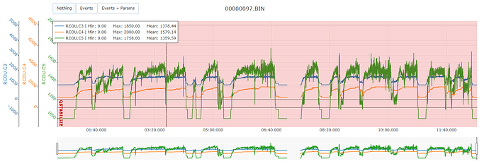

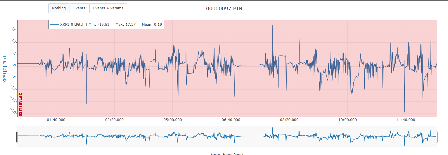

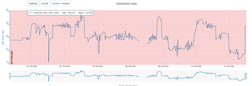

Here is the logs of the Roll, Pitch and Yaw outputs:

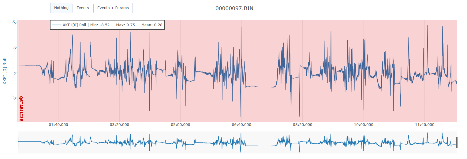

Roll

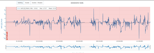

Pitch

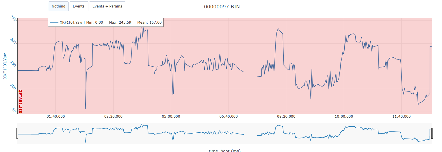

Yaw:

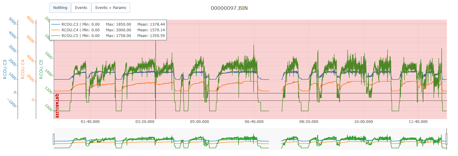

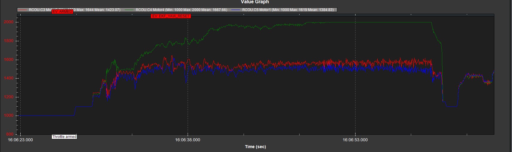

Here is the logs of the motor outputs.
Here are the outputs

The rear motor is commanded to max so I don’t think that’s what’s happening. Based on the components, weight and battery power it’s overweight/underpowered. Or in any case unbalanced power.
Yes I believe It is simply unbalanced, I will try to put the center of gravity much forward and that will probably resolve the issue.

Looks clean, what is the weight by chance?
Yeah it work, just 14A in total for hover now, so It got even more efficient. I moved the CG but more importantly slid the booms back so the front motors are closer.
about 2.9 kg, with 850g battery
:+1: Let’s see a log of that at hover.

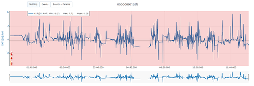

(Ardupilot bin file - Google Drive)
I have added it, .bin 100
I was not able to get much flight since there was a lot of wind yesterday and rain today, but we can still see that the RC output 4 is a lot less than before.
