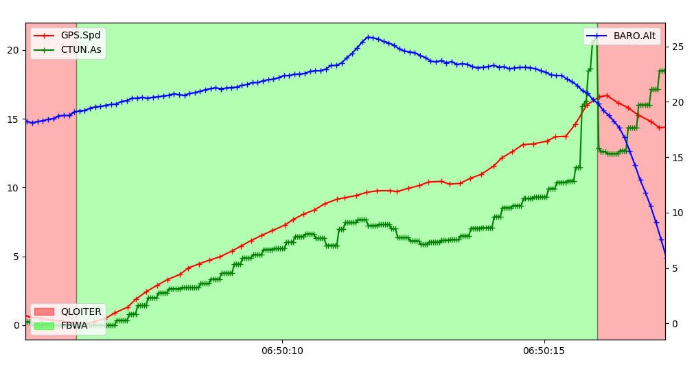

I am currently working on a tilt rotor reverse tricopter design and found that when transitioning to forward flight it nosedives into the ground and I could not make it pull up.
I have attached the video of the crash and will try to upload the log file as well, but have you ever seen this before?

The forums won’t let me put the .bin file up for some reason so I’ve uploaded it to dropbox.
Here is the link: https://www.dropbox.com/scl/fi/efjnyztladge9sq3jxs23/00000083.BIN?rlkey=ye99lpeencaq04prts7jo10mn&st=lj9p1s8y&dl=0

The plane never made it up to speed.
I don’t know what that plane needs, but looking at it’s shape on the video I’m going to guess it needs something closer to 15+m/s to fly, and by the time it got close to that it was already in a dive with a planet in the way.
You could try to increase the Q_TILT_MAX so the plane will use the quad motors longer and it might give you more time to accelerate, but I think there’s bigger issues.
