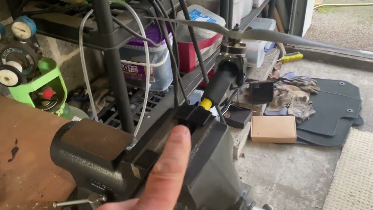

I also have one more question , currently im using 35kg dual shaft servos on flycat 5010 motors . How much thrust can the servo sustain before it fails?

Good question. I did a bit of testing. It seems a spinning prop does not significantly increase the torque required to tilt it. I think it’s more important to get a quality servo, preferably with a brushless motor. It seems the brushes are a weak point. I’m now using savox. Here is one of my testing vids.
oh wow. Now that I think about it when the prop rotates the force is always perpendicular to the tangent of movement arc and generally if im not wrong the torque is calcuated by liftiing something tangential to the servo arm arc and no change in the direction of force either
