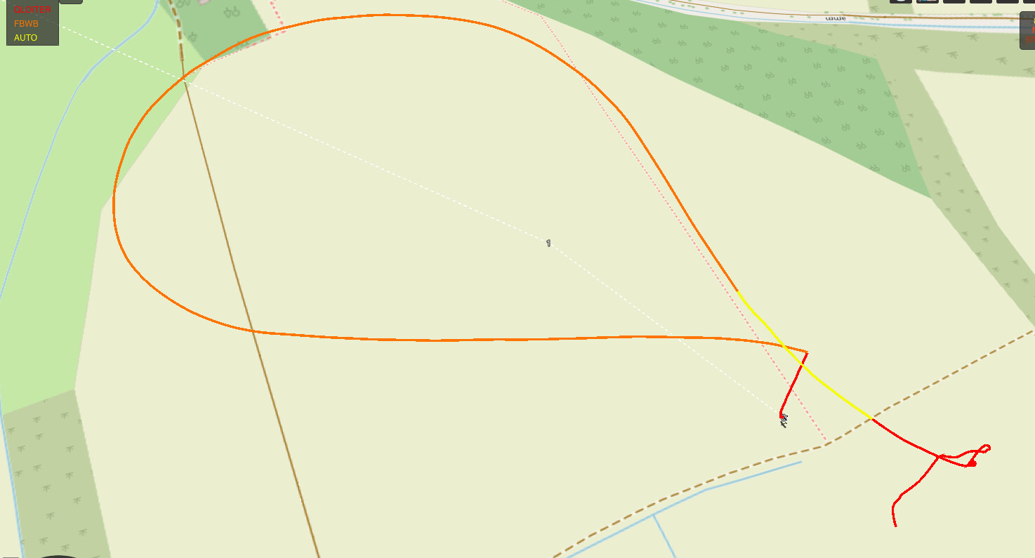

After multiple successful flights on our testfield there was another flight started: Takeoff in QLoiter, climb to safe altitude, transition to FBWB, fly a curve, switch to Auto, noticed the hovermotors started spinning (despite a plane waypoint mission being loaded), switched back to QLoiter, transition was a bit more rough than usual and there was quite an aggressive pitch back moment which resulted in the loss of a foam piece of the fuselage cover - which at least audibly did not hit any propellers or anything else from the plane and is in it self not neccessary for the plane to function normally, although it appeared to have damaged the downward facing lidar on its dismount as we were getting unhealthy lidar messages. Afterwards it almost seemed stable in hover for a quick moment but then became unstable again, flipped on its back, went full throttle on the hover motors, extremly stable, no amount of RC Input did change anything, a few seconds later it crashed into the ground in that state.

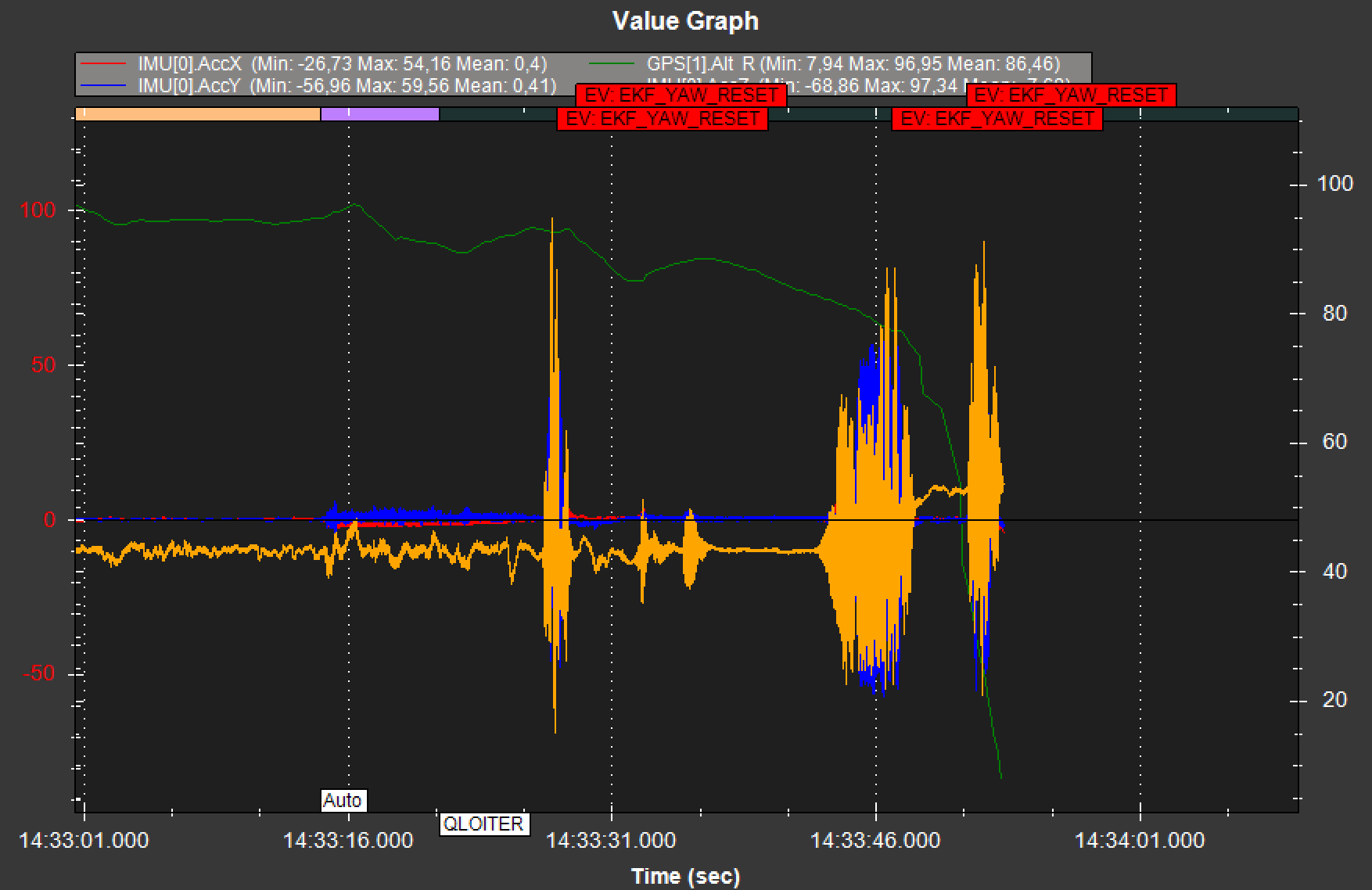

Since I’m short on time, just a quick look: Could it have been a mechanical problem? Take a look at the acceleration sensors:
Rolf
Thanks for the suggestion, i’ve seen those as well, but I can’t explain them. After the crash very few things survived but it is visible, that the FC is still mounted in its original place, the cruise motor as well, the props survived - and during the malfunction there was no vibration audible from the spinning motors, or at least no change to the usual sound profile - so I am really baffled how these huge acceleration spikes came to be.

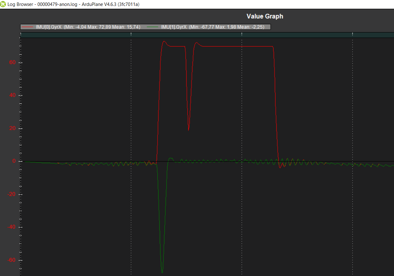

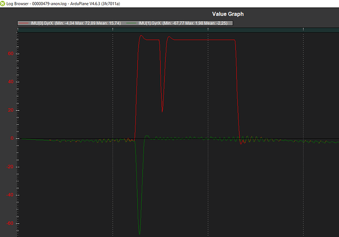

Hi! This looks very much like two crashes i had with an Pixhawk 4 which had a defective second IMU.
The attitude was completely wrong, exactly as in your case.
At a certain point, the GYRO values switch axis:
I am currently writing from my holidays and don’t have time to dig into your log any deeper. I was just triggered because your crash sounded very similar to mine. Maybe @Rolf will remember the crashes, as he helped me to find the cause.

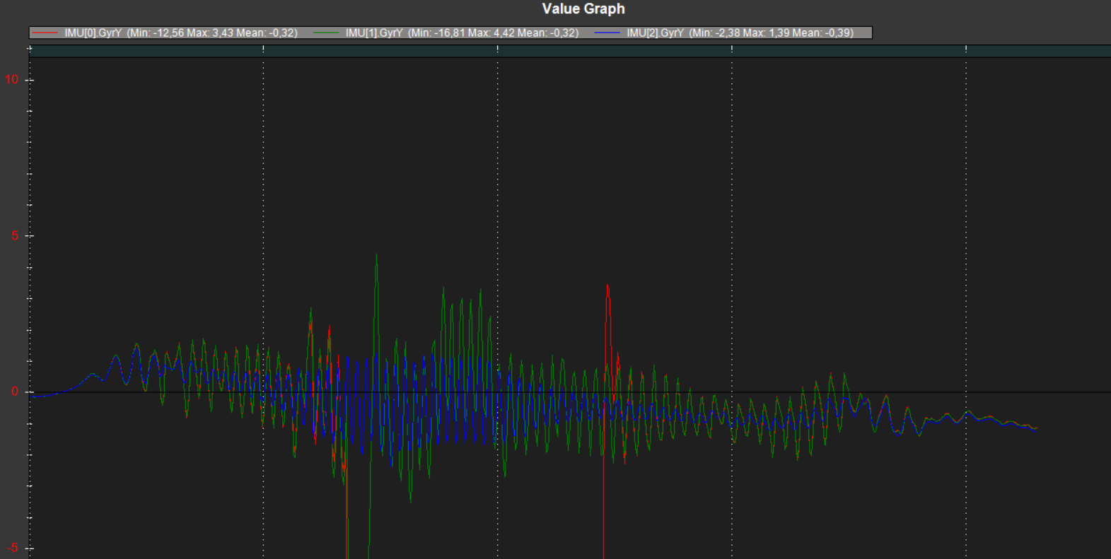

Edit: In contrast to my crashes, your Gyro values don’t switch axis but simply do some wrong output. First guess would be some problems with your soft mounted IMU 0 + 1:
The hard mounted IMU 2 (3rd one) looks plausible.
Maybe you could open your Cube Orange and check if the soft mounted IMU PCB had any issues or better ask CubePilot for help.
For me this looks clearly like a hardware fault.
