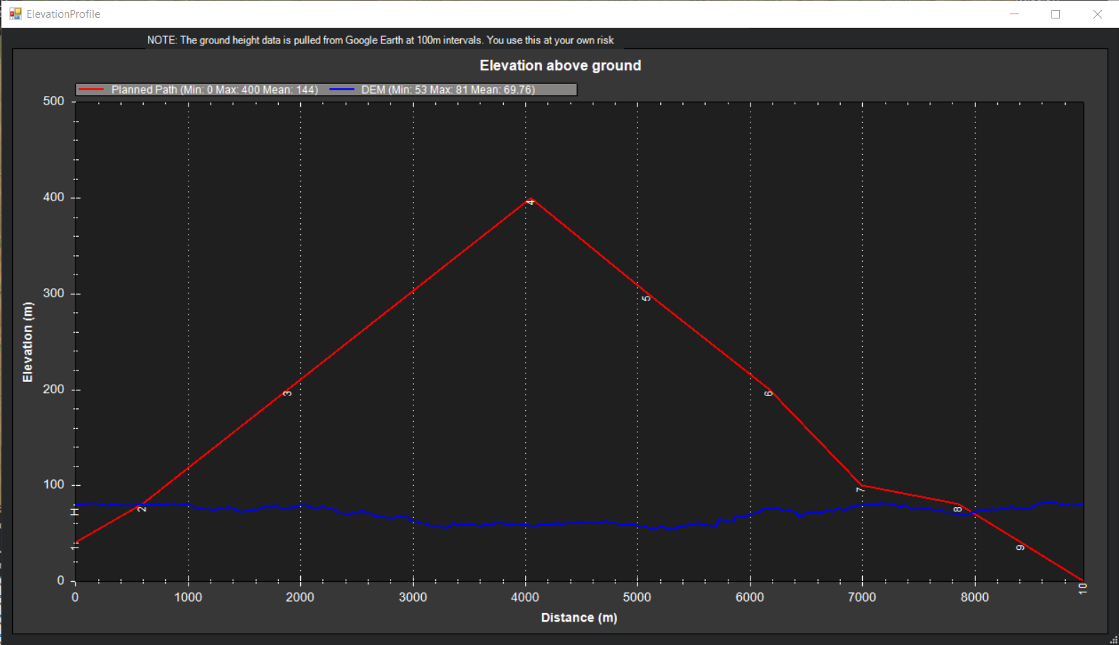

I need some help understanding why the VTOL(3.5m wingspan) loosing altitude after a successuful transition.
log file: log_66_2025-10-25-10-38-14
Best regards

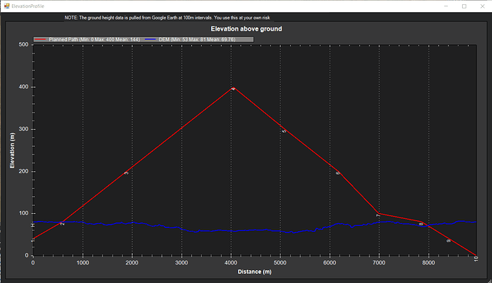

The elevations for all the waypoints were set to absolute. Once the take off was completed and the plane was on it’s way to waypoint 2 it was descending down to a height that was very close to the ground.
Change the altitude Frame in the mission from absolute to relative or terrain. Make sure you change each waypoint.
Thankyou very much Allister that was exactly the mistake.
