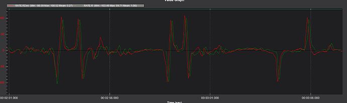

What do you think? I tuned the pids to the best of my abilty. Is it to aggressive for a vtol?
Motors came down cool. I changed the yaw and pitch pids from my last log
Roll looks better than pitch with less overshoot.
This looks good:
This isn’t bad and you don’t expect as much Pitch Authority with a Tri. You could try increasing the Rate Pitch P&I values a bit more.

Check out that beautiful yaw authority. Feedforward of the tilt servos was the key. I keep hitting the throttle up when yawning
Wow, that looks solid!

Yes i did it. Took a while but it worked. Using the uav web tool didnt work until i logged gps. My feedforward was off. It ended up at .31 then everything else easily tuned with the transmitter. Now the tilt servos move quickly and smooth with yaw. Would qautotune do anything? Especially now that the ff moves the tilt servos.
