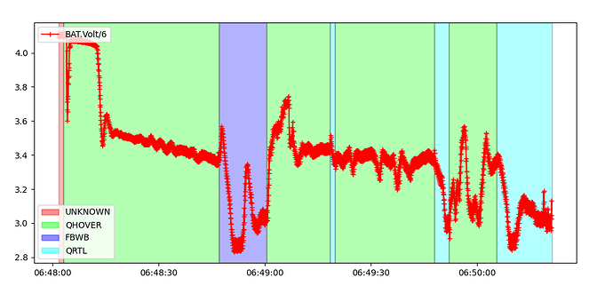

The battery voltage was really getting drawn down during the attempts. I haven’t dug too far, but at those voltages it’s possible in any Q mode there wasn’t enough power to maintain flight. Looking at the commands to the motors, they are at max while the voltage is plummeting.

Yes, I thought that having Q_Assist enabled during the first seconds of FBWB (since I activated FBWB at 38 m and Q_Assist alt was set to 40 m) could be beneficial until the plane, with my pitch‑stick input, climbed above 40 m and Q_Assist turned off. But as you mentioned, with the hover engines running the aircraft cannot perform reasonable level flight, which I didn’t take into account. On top of that, the current draw becomes even higher, and judging from the battery voltage drop, it seems the battery couldn’t supply such high currents, which made the situation worse and ultimately contributed to the crash.

I used a 6S2P Li‑ion pack with a total capacity of 9000 mAh and a maximum nominal current of around 50 A, which seems to have been exceeded during the flight. So yes, the Li‑ion cells were stressed a lot as well.

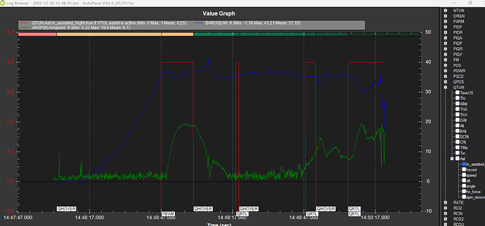

Looking further into the log, I’m struggling to understand what happened during the last 10 seconds before the crash (around 15:50:08 and onwards). Based on QTUN.AST.in_assisted_flight, the hover motor assist was active. When I check the motor outputs RCOU.C5 to C8 (which correspond to the four hover motors), I see that the flight controller was sending low PWM commands to motors 4B and 1A, while the other two motors were receiving much higher PWM values. These motors are located on the right side when viewed from above in a typical quad-X configuration. So I would expect the aircraft to start banking to the right.
However, ATT.Roll shows negative values, which would indicate a left bank instead. I can’t reconcile these two observations. Am I missing something here?

Comparing the target roll with the actual roll (e.g. ATT.DesRoll and ATT.Roll) shows that the left quad motors are controlled more strongly than the right ones the more the roll deviates to the left from the target roll. So completely logical.
