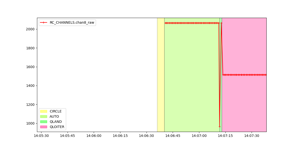

Hi everyone,
I’m having an issue with my VTOL (QuadPlane configuration) during the transition to forward flight.
When I command the transition, it starts normally — the plane begins pitching forward, the forward motor starts for a short moment, but then it immediately stops and the vehicle switches back to QSTABILIZE mode (vertical flight).
Sometimes it looks like it starts the transition successfully for a second, but then the forward motor cuts off and the VTOL “gives up” on transition.
Here’s what I’ve checked so far:
  • All motors and ESCs work fine during manual tests.
  • Battery voltage seems okay.
  • I have an airspeed sensor
  • Firmware version: ArduPlane 4.6.2
  • The issue happens every time I attempt transition.
    tlogs
Please unlock your Google Drive. It would be more helpful to have a *.bin log file from the SD card than a tlog file.
Check your Q_TRANS_FAIL time is not too short or the AIRSPEED_MIN is not too high. .bin file would show the problem

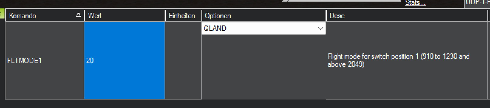

A *.bin file would certainly be better for evaluation. However, even with the tlog file, it is possible to determine that QLAND was triggered by your RC transmitter.
FLTMODE_CH is set to 8 and goes down to 965:
This corresponds to the flight mode set with FLTMODE1. In your case, this is QLAND.
