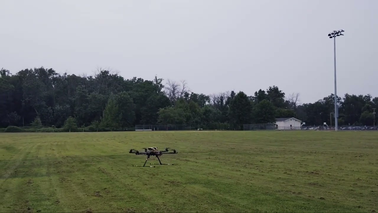

Vertical Bouncing (new build, stock tune)
I’m getting this vertical bouncing, most times when I fly in Stabilize Mode and seemingly even more frequently when in Loiter Mode. I’d really like to get rid of it before I try to QuickTune and AutoTune. Have never tuned any drone before because thus-far, I’ve only built 5" and below, using BetaFlight Presets.
In this video, it flies ok, but is still very unresponsive to throttle input (pitch, roll, and yaw seem very responsive) https://www.youtube.com/watch?v=z6txoZ_vUV0
But in this flight, the problem starts 42 seconds in, then RTH’s on its own and I turn on LAND mode. https://www.youtube.com/watch?v=8oE4p3GPMcI
And here, I show how it happens in Loiter Mode https://www.youtube.com/watch?v=suTxeErZ8ko
Firmware is 4.7.0-Dev (I think I got it from the Latest folder, which MicoAir told me to do.
The frame is a Tarot FY680 (the cheapest/simplest version) Generally pretty clean build, but I hadn’t put a couple of screws into one plate which I’ve put back in last night and had a couple of loose zip-ties which I’ve also fixed after the flight. 6x 3115 900kv motors running DShot600. HQProp 10x5x3 props. 6S voltage. Photos of the build here Daniel Yusim on Instagram: "Autonomous Hexacopter This one was honestly a pretty tough build."
Stock settings from the Initial PID Setup in Mission Planner and from the Param Configs in Cris Rosser’s first video. Same logging settings, as well.
(log https://drive.google.com/file/d/1IAmuJvc_E-ifpY8_owabAcPxfa3-5yys/view?usp=drive_link)

It seems my vertical controller is way off. It could also have been an issue in loiter because of the learn-and-save procedure trying with a default MOT_THST_HOVER of 0.2 when I’m seeing much lower values from this log. (I think this one was a flight in Stabilize Mode) https://imgur.com/a/QHkDegt
It looks like MOT_THST_HOVER should be around 0.06? Though my MOT_SPIN_ARM is 0.08 which doesn’t make sense because it arms fine without flying away.
(Idk, should I set my MOT_THST_HOVER to 0.06, lower MOT_SPIN_ARM, and recalculate my vertical controller PIDS using methodical configurator? Than, I’d probably try to re-upload my MissionPlanner params and manually set up the new throttle/altitude controller values to retain the main MP Params)

It seems my vehicle is overpowered. The CTUN.ThO seems to be just above 0.05 from the graph linked in the imgur link

I did not realize that when I ran it, but here’s what I did and the drone just flew beautifully. (ready for tuning!)
Saved original Param File, ran Methodic Configurator, screenshotted the new params for PSC_ACCZ_I and PSC_ACCZ_P, re-loaded my original param file and loaded it to the FC, manually updated param suggestions in MP, wrote them, and flew.
Param Changes:
MOT_THST_HOVER from 0.2 to 0.055
MOT_HOVER_LEARN from 2 to 0
MOT_SPIN_ARM from 0.05 to 0.04 (now I know why it felt so floaty when landing)
MOT_SPIN_MIN from ? to 0.043 as suggested by AMC
PSC_ACCZ_I from 1 to 0.11, as suggested by AMC
PSC_ACCZ_P from 0.5 to 0.055, as suggested by AMC
