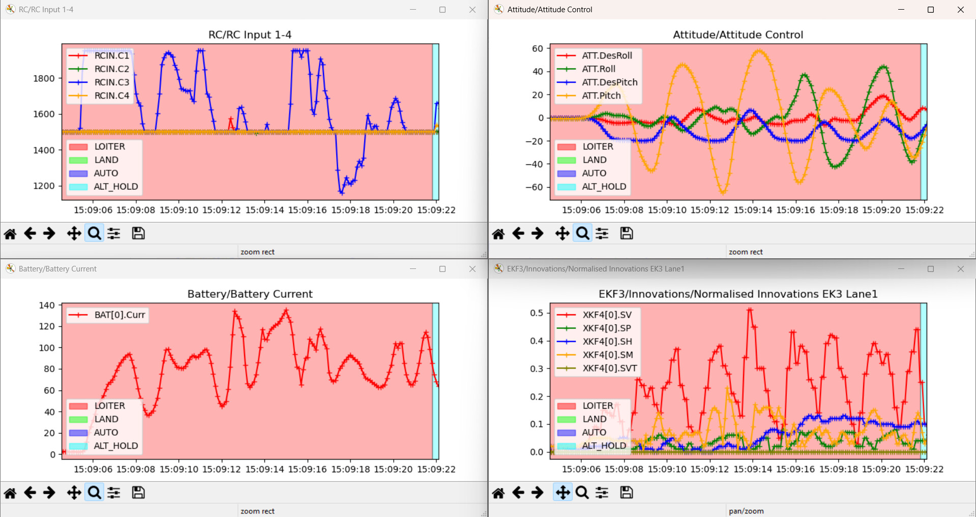

Velocity innovations suddenly peaked up causing erratic behaviour
Hexacopter (Spraying drone)
FC: Cube orange plus
GNSS: custom board (M9N)
Motors: X6+
MTOW: 25 kg
After take-off the drone in Loiter mode, there was weird behaviour which caused erratic pitch oscillations and uncontrollable, switched to AltHold and landed. After analysing the logs, there was sudden velocity innovations. May I know why it caused and consequences? Attaching the log here.

Was the vehicle tuned acording to the documentation or was it adhoc tuned?
I would be interested in the Tune question also. The vertical controller gain parameters are not right.
That is some very old firmware.
only basic tuning was done as per documentation.
