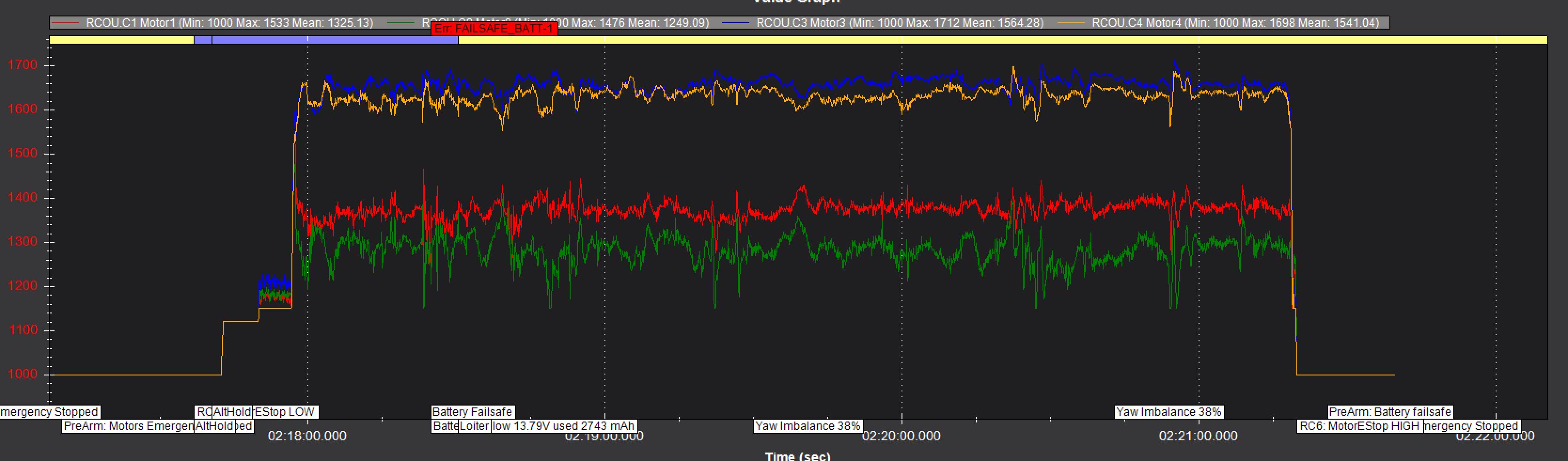

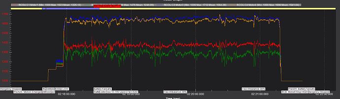

Hi there, I am currently flying a V shape quadcopter . It is flying well but the desired flight time is not coming, like by theory if I should get 20 mins, I am getting 12-13 mins. Also one more thing I have noticed in my log that, two diagonally opposite motors are rotating at 1600-1700 pwm where th eother two are at 1200-1300 pwm. I am attaching the .bin file drive link. Can someone help me out please?

And there is a huge Yaw bias:
Thats impressive with how much yaw authority it should have.

Yes…according to log the RCOU shows yaw trend throught the flight but in real scenario it had yaw just after it lift from the ground, then there was no such yaw behavour is seen
That matches what happens if you have yaw imbalance, integrator takes out the error over time and then it flies mostly straight. You shouldn’t have significant yaw imbalance because it negatively affects the control loops. I wouldn’t be surprised if you had noticeable roll trim.
