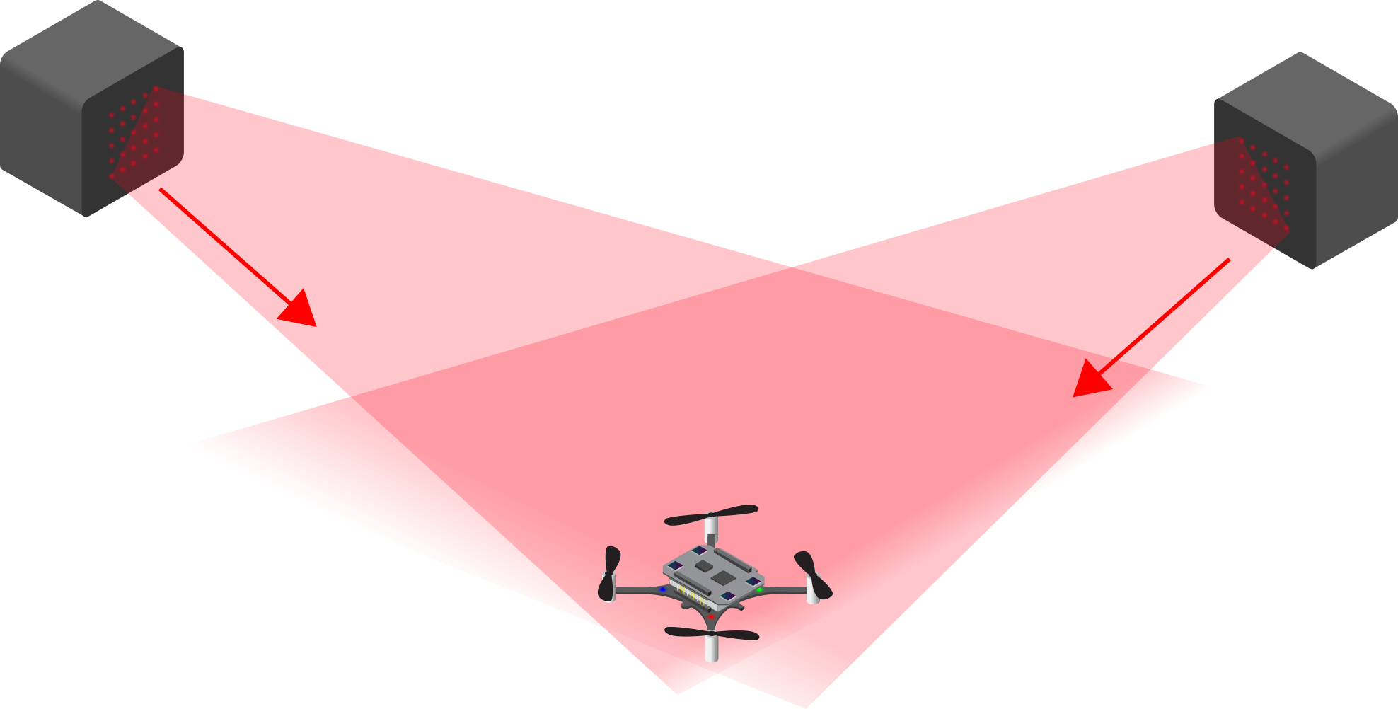

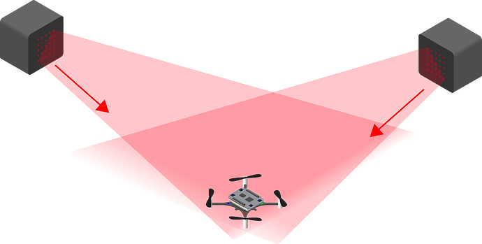

Coming from the VR world, the Lighthouse V2 tracking system inverts the perception problem: base stations sweep the room with infrared laser planes, and each drone only needs a cheap array of photodiode sensors to detect them. The intelligence lives in the geometry, not in the onboard hardware.
Each base station uses a single fast-spinning rotor that produces two angled “V”-shaped sweeps per rotation. Our receiver board uses the TS4231 light-to-digital converter paired with compatible photodiodes. Because Lighthouse v2 modulates its laser with a unique identifying code (no optical sync flash required), the receiver can recognize which base station it is seeing and recover timing from the sweeps alone.
By measuring the interval between the two sweep crossings, the system computes the azimuth and elevation of the sensor relative to the base station. With four sensors rigidly mounted on the drone and known base station poses, the full 6-DoF pose (position and orientation) becomes observable.
