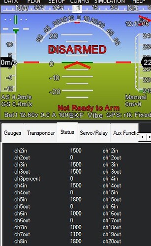

So, on Mission Planners Status screen (below the HUD) ch7in and ch7out go high when you flip the Tx switch?
In the setup screen, servo output it’s working, when I go to Data screen, servo/relay there staying green, assuming this is where you mean, it’s been along time since I last used MP so feel I’m having to start again.

Status Screen. But from what you are describing it’s configured correctly.

Thanks, yea it is working when switching, double checked and im plugged in to the correct RX7 on the board.

It would never have been Mission Planner. MP is just a way to interactively display what’s happening with the hardware.

Confirm you have the white wire soldered to S7, the red wire soldered to any pad labeled either 5V or 4v5, and the black wire to a ground pad?
RX7 is a serial port and has nothing to do with servo output.
Oh blimey why am I thinking RX7 when all my other servos are connected to the ‘S’, I’ll go and redo it, thank you
