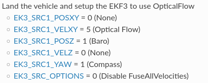

That error should be solved once you set EKF origin. You should see a drone icon on the map where you clicked. This is like a false location of the drone so that the EKF has an origin to do its calculations with respect to. If you still are getting the error, I think you may not have configured EK3_SRC1 to use OpticalFlow for the position estimate. Set the altitude source to either rangefinder (preferred) or baro.
Here, read this: OF setup
I don’t see an option to set opflow as a position source. Only XY velocity. Is there anything else I should do? I’m still getting the Need Position Estimate error.
Yeah right, velocity source.

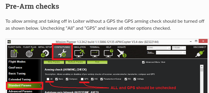

I have it set up exactly like this shows, and still cannot arm in guided due to “Need Position Estimate”. All arming checks skipped, altitude source set to baro. :frowning:
Can you try setting GPS1_TYPE to None? And you really need to enable arming checks though
Arm: Need Position Estimate
It’s so frustrating
Disable GPS arming check. And try to set ekf origin somewhere else and try one more time. If this doesn’t solve your issue, I’m sure someone else will sort it out.

This? MatekSys Optical Flow 3901-L0X — Copter documentation
Yup, this one exactly
It has a rangefinder. Please set up all parameters as stated in that doc
