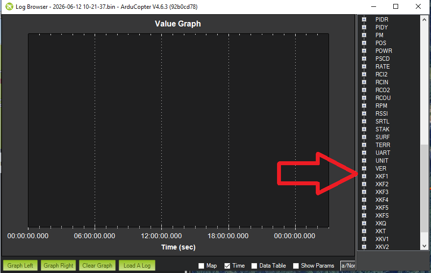

Using INS_RAW_LOG_OPT - no VIBE data is available
I’m using the new INS_RAW_LOG_OPT parameter to tune my notch filter. The Filter Review Tool website reports good success.
I’ve noticed however that I’ve lost my VIBE data:

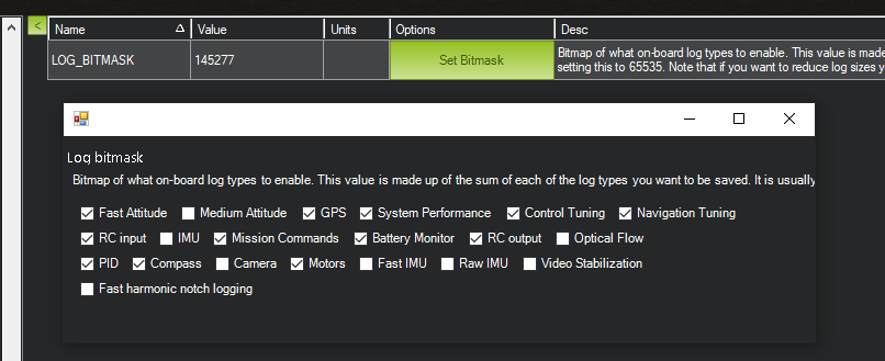

And here’s how I’ve set LOG_BITMASK.
Can someone please help me find what I’m missing - to get the VIBE data back in my log?
Thanks!
By checking the IMU box.
