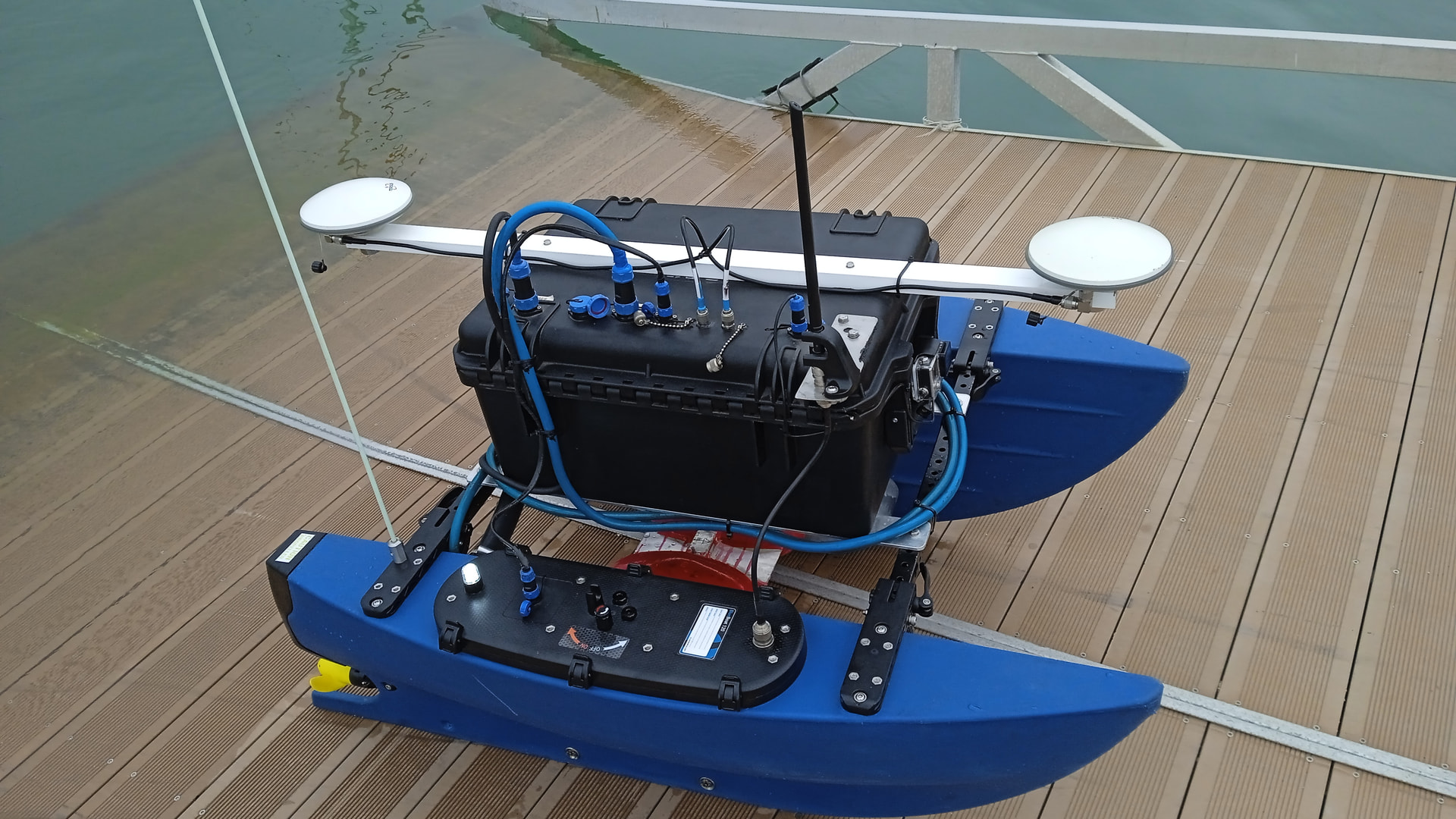

I would like to know how I can, using an external GPS that provides me with NMEA sentences of position and heading (GGA and HDT), pass them to Ardupilot so that it uses this heading (HDT) and disable the compasses, which give me a lot of magnetic problems.
It is a GPS that has two antennas, but I don’t want to send the GGA position of each one and have Ardupilot calculate the heading; I want to send the HDT sentence and have Ardupilot take that heading directly.

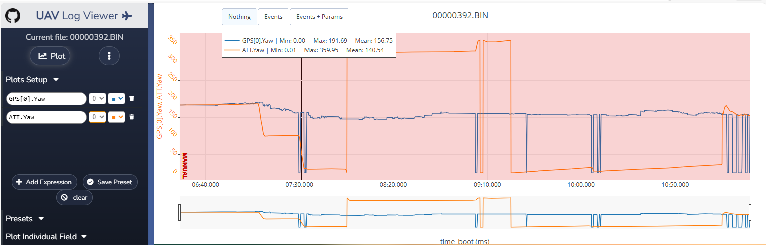

I have a bin:

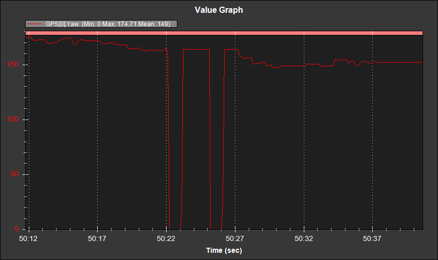

Your GPS is sometimes failing to update yaw.
I think your message rate may be set a bit fast (20Hz?). Set it to 5Hz.
We believe it was because they took the boat to test that the course was correct and they turned it between two people, and when they picked it up, since they covered the antennas, it gave some incorrect value.
In any case, I understand that GPS[0].Yaw is the heading that comes directly from the HDT sentence. But what is the actual heading value that the AP uses to steer the boat?
What do the values mean AHR2.Yaw and ATT.YAW?
Thank you.

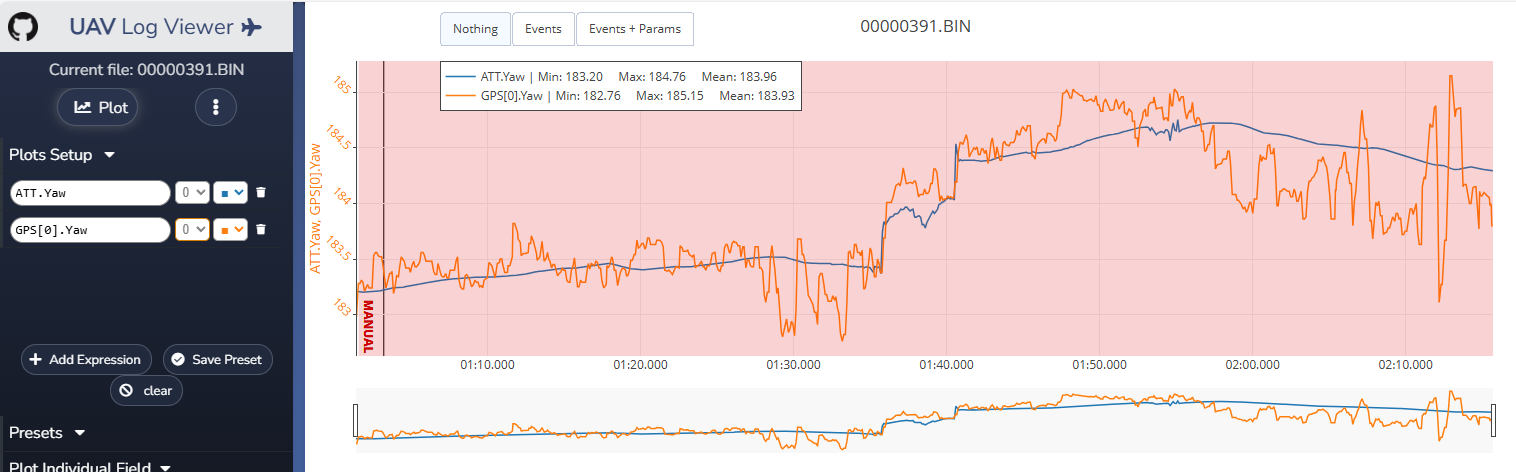

Looking at a previous log where the course (HDT) didn’t give zeros, I think that seeing how ATT.Yaw behaves, it seems to me that it is the actual course the boat takes. Is that right?
It’s just that when I see the one that gives zeros, I don’t understand why it started to change before GPS[0].Yaw changed abruptly. Then I see that in other areas it has a hard time recovering because it must be a somewhat slow filter. Is there any way to make it respond more quickly?

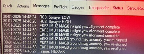

I missed a key point in this log. It appears your test began before the EKF reported yaw alignment complete (that only happens in the last few seconds of the log, likely upon disarm and state reset). So this test was basically just invalid. Wait for the initialization sequence to complete before moving the vehicle.
Also, if you’re going to push the vehicle around, wait for EKF alignment and do your testing disarmed (with LOG_DISARMED,1 configured for analysis). Arming the vehicle likely places some kinematic constraints on EKF state management that won’t be met with zero throttle input.

And what message should I expect? Is it the one shown in the image? I mean, if the message doesn’t appear, I shouldn’t arm yet, right**?**
Thank you :slight_smile:
Another thing, today we tested in navigation and heading, and since it’s not covered, it works much better, but I notice that sometimes 1 or 2 zeros in HDT still come through every few minutes… is there a way to filter that data when it reaches the ArduPilot?
Those messages are entirely irrelevant to Rover (and happen after arming anyway).
The key indicator for you should be AHRS: EKF3 Active, but there is a better way to determine ready for arming.
Enable the GPS bit for ARMING_CHECK (or just leave the default of 1 for all!) and select a position-dependent mode like LOITER. If you can arm, all is well. Alternatively, you can enable fences with FENCE_ENABLE (even if you don’t want to use them), and prearm checks will fail until the system is healthy enough for navigation.
