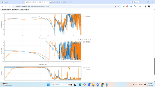

@spova You really should never have to lower Ang P below 4.5 on smaller heli’s. Ang P is very important to ensuring the aircraft maintains the requested attitude. I generally try to get this to at least 6. The other thing you should be very careful with is not putting in too much Rate I gain. This is very dangerous for the heli when it lands or is ground turning before takeoff. Any error in the requested rate and actual rate would cause large integrator buildup. This is caught by ILMI or IMAX depending on the integrator scheme you choose (Leaky Integrator or not through the param H_OPTIONS). So as a rule, I never increase Rate I more than 0.1.

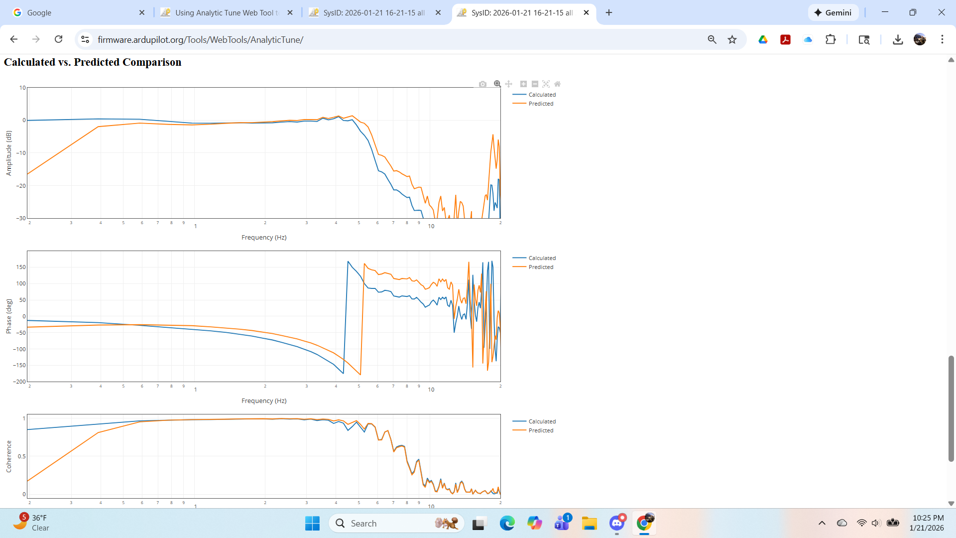

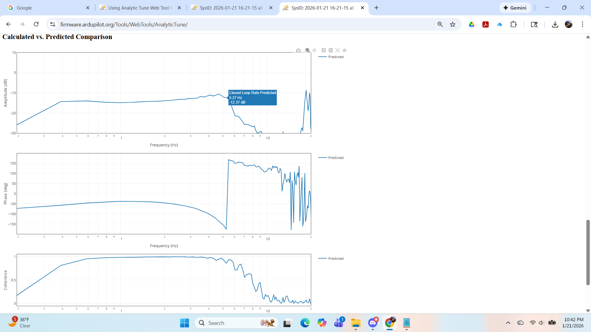

Looking at your data, the pitch axis doesn’t show any rise in gain at a particular frequency. The gain plot with Rate P and D set to zero and the FLTT filter removed shows bare response to be pretty flat. There is a small rise of 2 db toward the point at which the gain then drops off. This is good. Se the plot below for that starting point with these settings
ATC_ANG_PIT_P,6
ATC_RAT_PIT_FF,0.14
ATC_RAT_PIT_P,0
ATC_RAT_PIT_I,0.05
ATC_RAT_PIT_D,0
ATC_RAT_PIT_D_FF,0
ATC_RAT_PIT_FLTT,20
ATC_RAT_PIT_FLTE,0
ATC_RAT_PIT_FLTD,0
I start tuning by reducing the Rate FF gain so that the rate gain is -4 to -5 db. Which when you view the angle with FF plot, it looks pretty good near 0 db. Then I start raising the Rate D gain while I watch the Rate controller plot. As the rate D gain is raised, the drop off will start moving to the right and then the gain will start to rise. As soon as I see an appreciable rise (1-2 db) which was around 0.0006, then i stop. next I raise the rate P gain while I look at the rate stability plot. You will see that the phase goes from -180 to 180 deg. This is the frequency that you look at in the gain plot to ensure it doesn’t go above -10db. I raised it to 0.03 and I am getting -12 db on the rate stability plot. You can see where my pointer is on the plot showing the gain at -12 db.
At this point I look at the attitude controller with Feedforward plot. This shows the response that you will observe when you fly.
I already have the Ang P at 6. You could go out and try this. You may notice a fast oscillation when you make sharp inputs. To remove that then you can lower FLTT. I Iowered it to 5 hz and I got the gain plot to flatten out before the drop off. here is what it looks like.

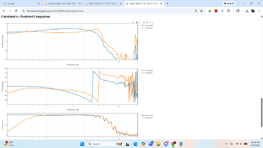

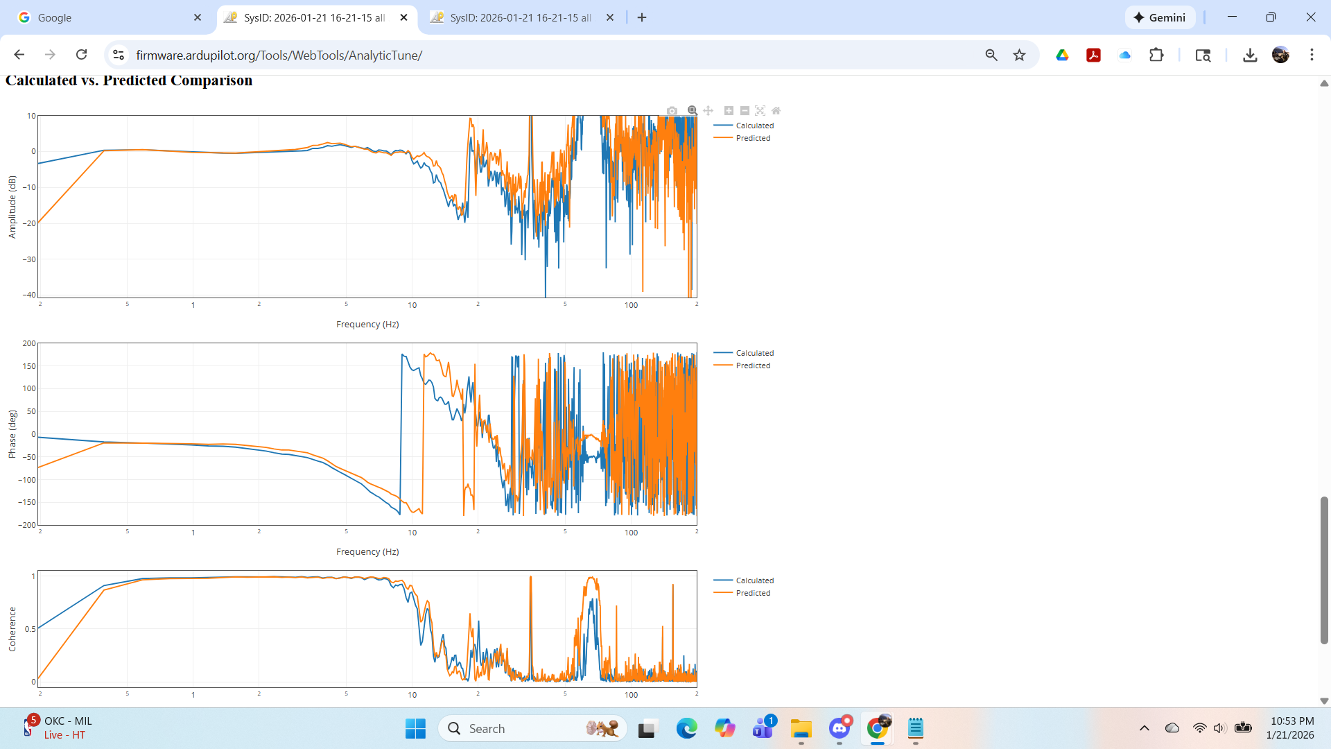

Looking at the roll axis, you can see the gain rise around 5 hz for the tune with only FF gain and Rate I gain.
here is the attitude controller with feedforward plot after tuning it
and the parameters

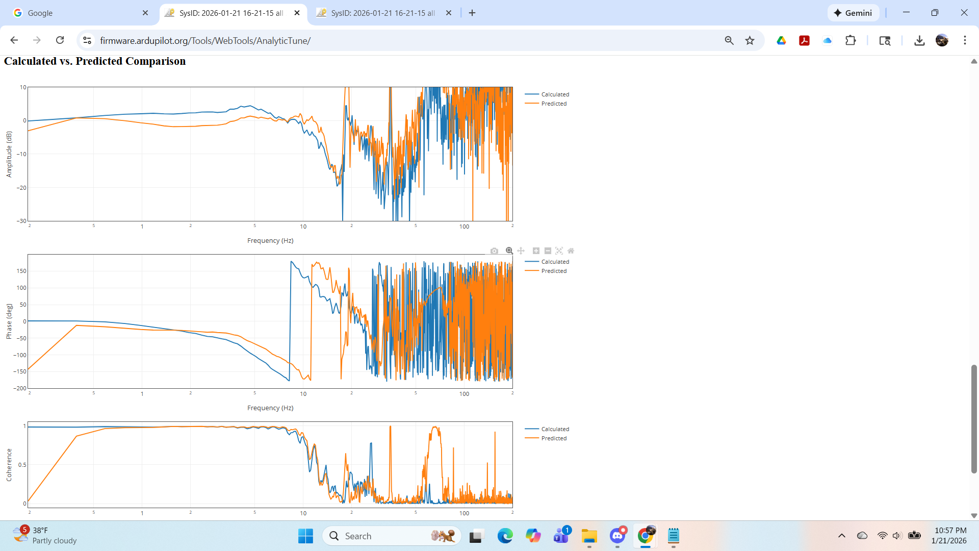

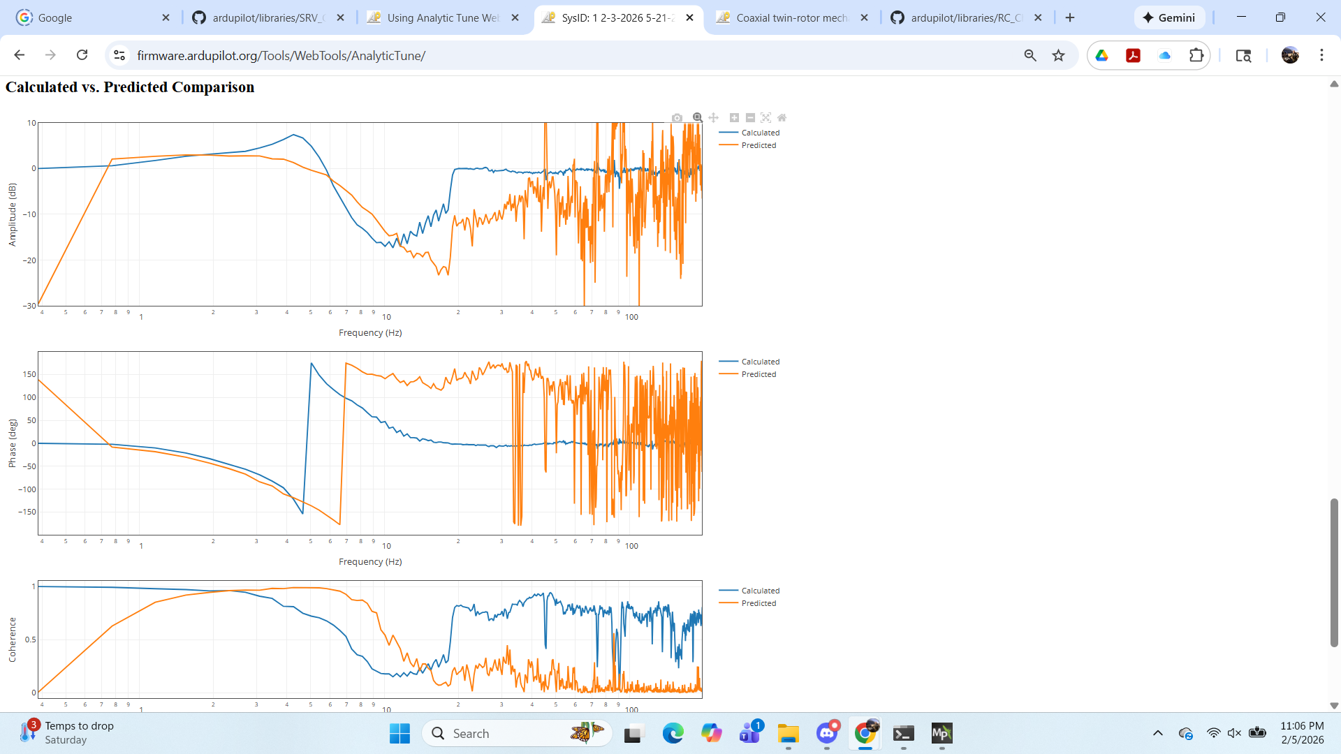

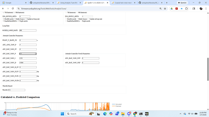

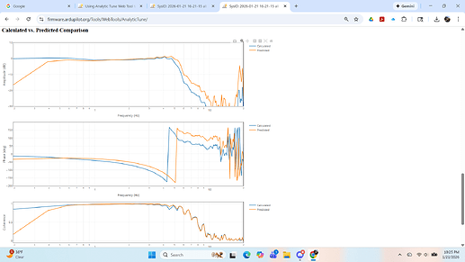

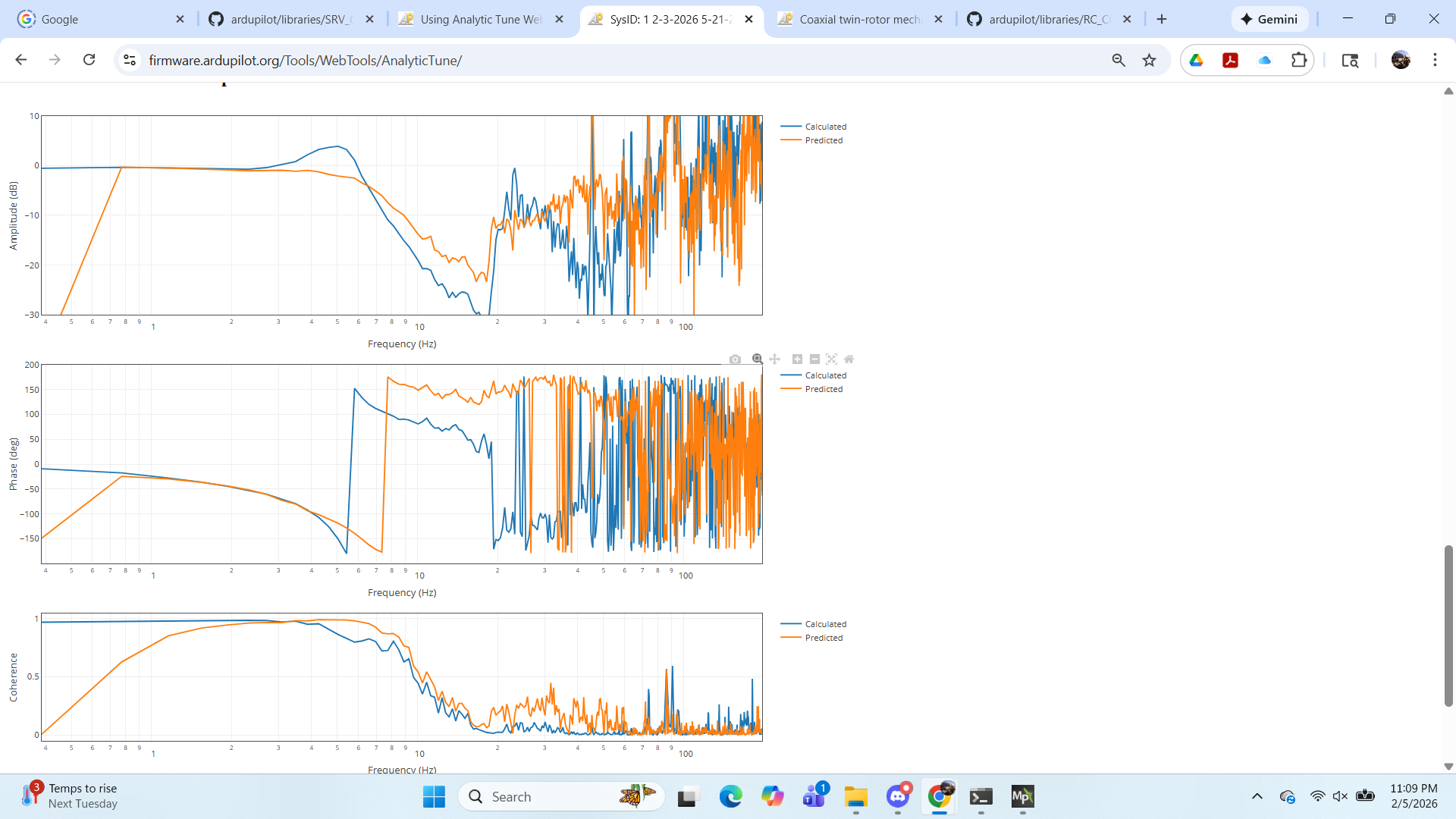

The yaw axis is coming out a bit wonky on my DDFP 450 class heli.

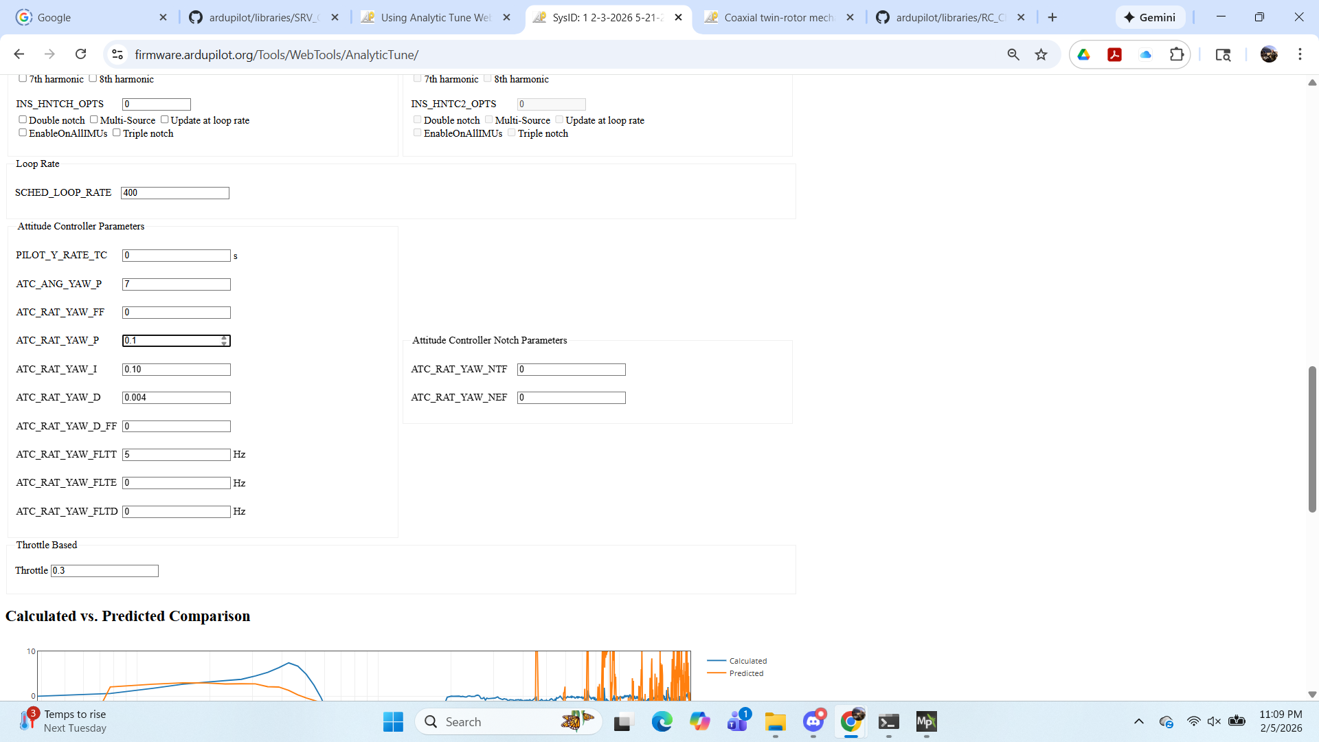

I can set p and d to max in the sid tune and then fix it all with lowering the FLTT to 5 on the yaw.
This doesn’t seem right. LINK to the sid run log.

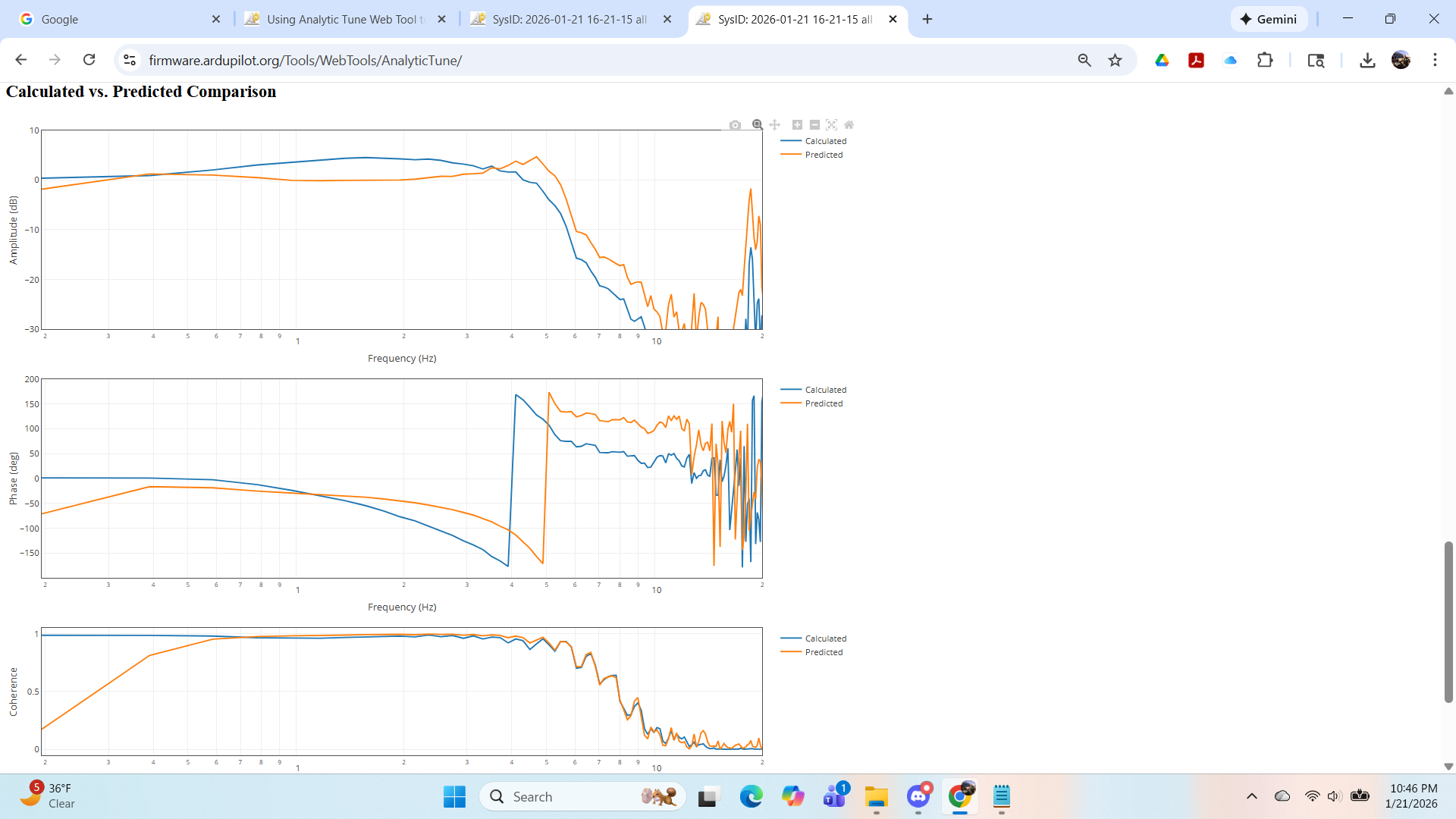

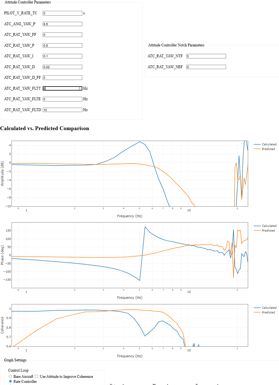

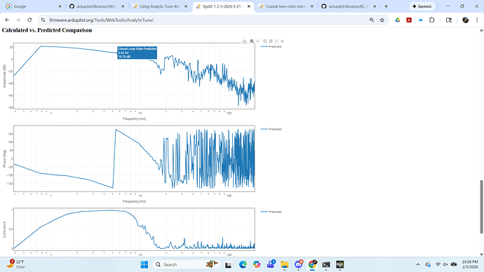

@spova took a look at your log file. As far as the predicted response that you posted, be very careful in setting the rate P and rate D gains. Notice that the predicted phase plot shows the phase increasing out past 5 hz. That is very indicative of an instability meaning that you added too much P or D gain. You can make sure that the rate controller is stable by looking at the rate stability plot. The gain in that plot should not be greater than -6 db at the frequency where phase crosses -180 deg (in the phase plot is jumps from -180 to +180). For you settings this is what the rate stability plot looks like.
You can see the gain is +10db which is very bad.
First thing to note when you load a new data file. be sure to see how well the calculated and predicted follow each other. You can see the predicted doesn’t follow the calculated around 5 hz
So the predicted response after tuning may not be that accurate. so be careful and gradually approach the settings you determine.

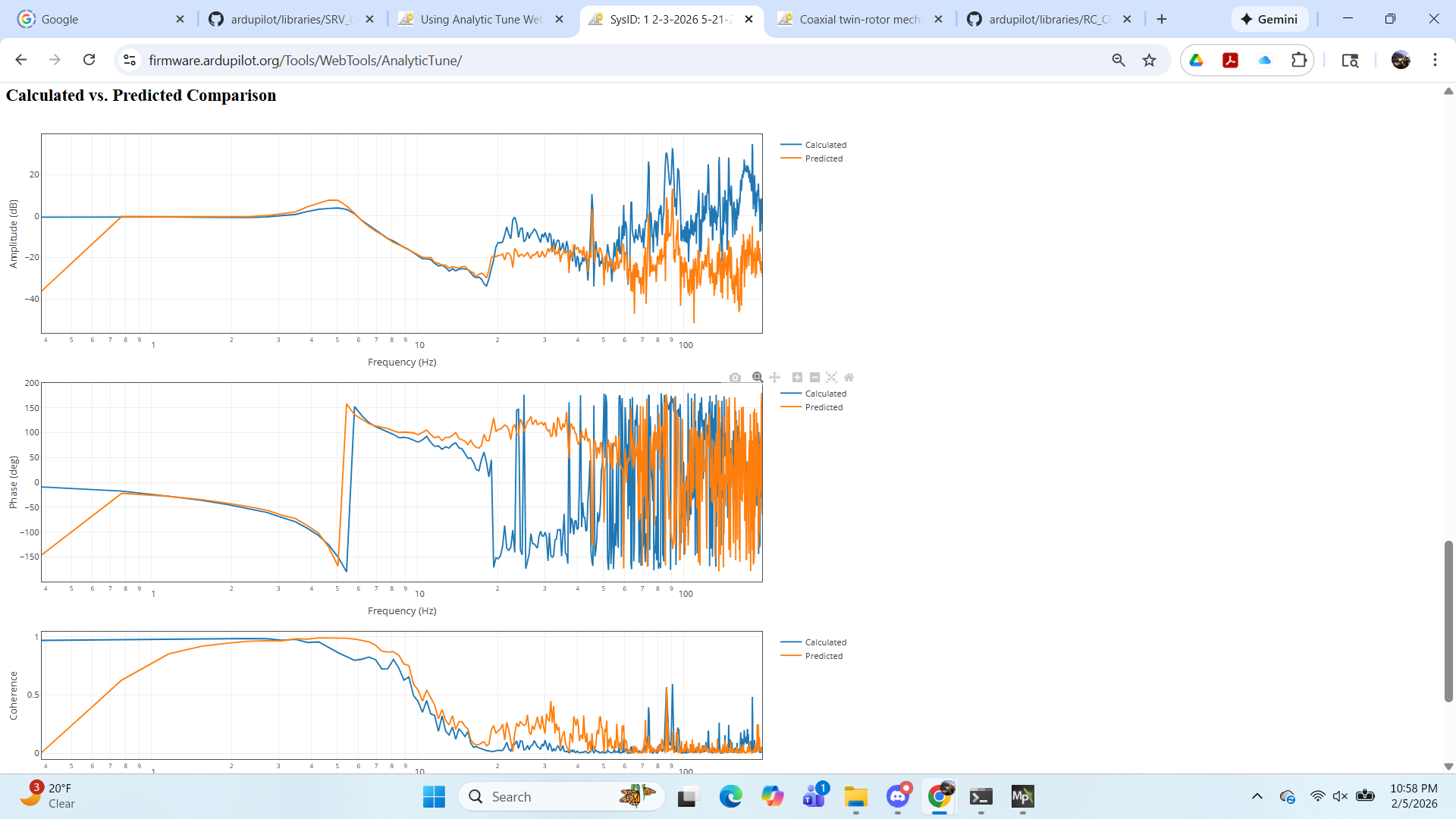

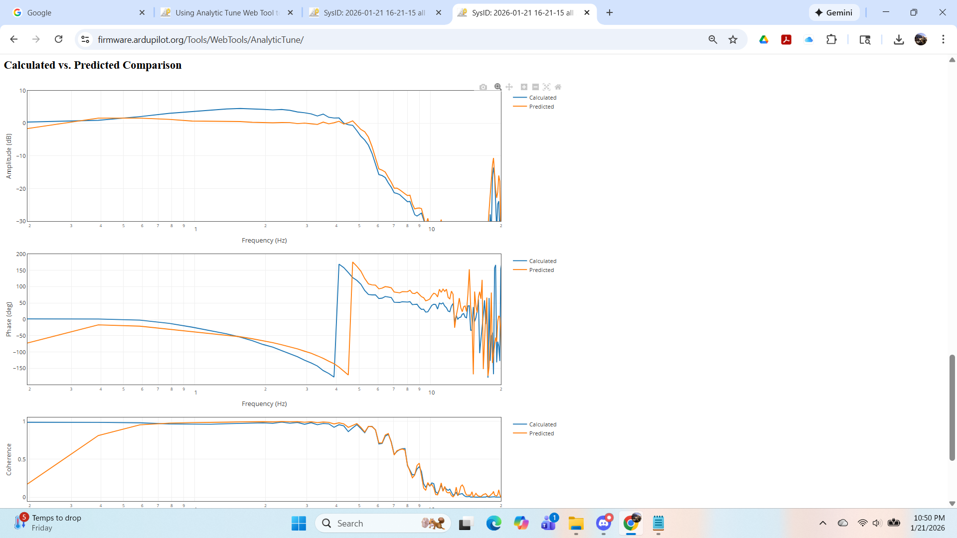

Here are the settings that I arrived at. I don’t add FLTD unless I really need to. If you signal is cleaned up well by the notch filters then you can set FLTD to zero to disable it. That was causing a lot of rise in the gain plot
This is the rate controller plot
This is the attitude controller plot

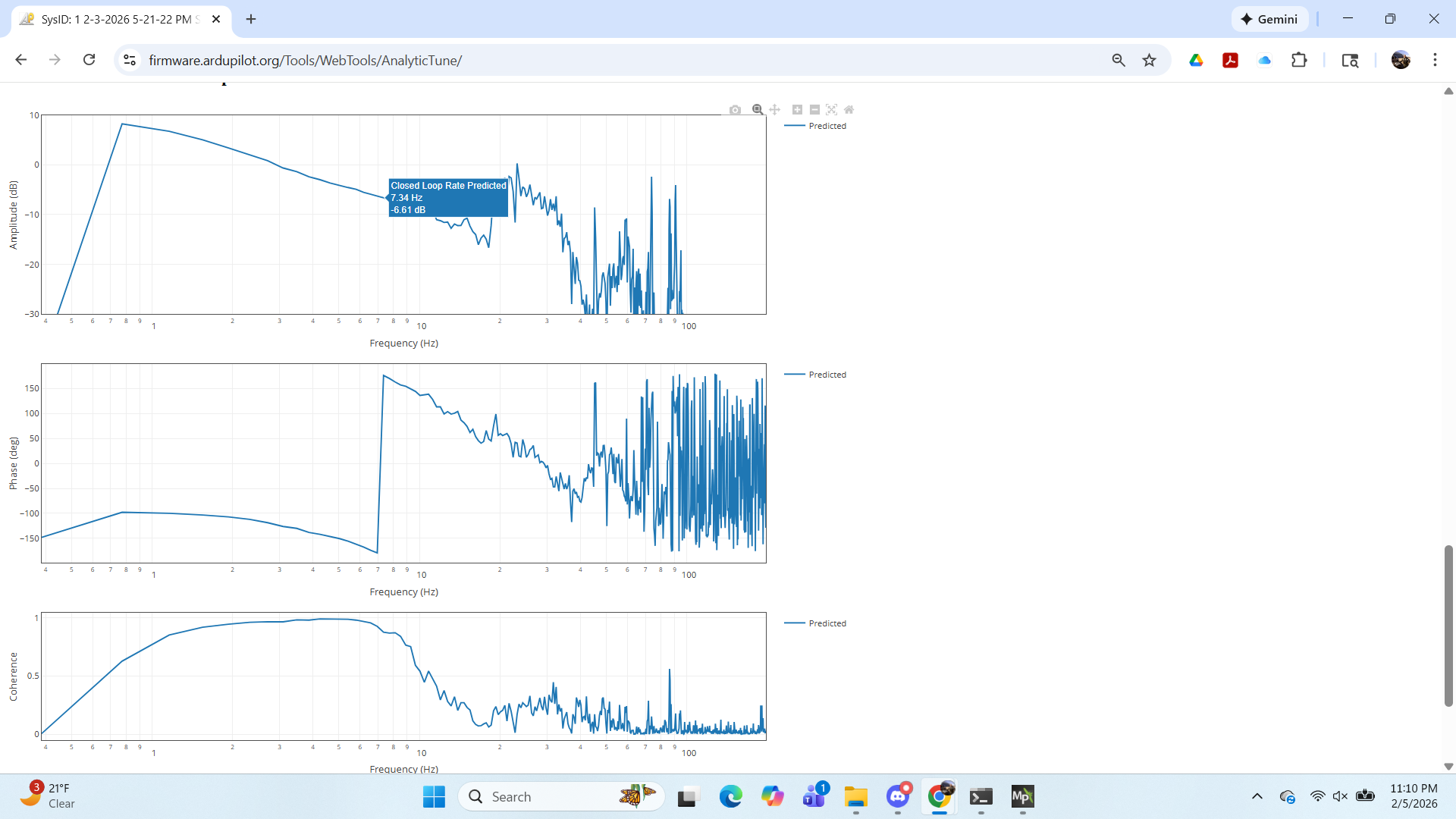

This is the rate stability plot. You can see the gain at the -180 deg crossing is below -6db (not by much though)
Hope this helps

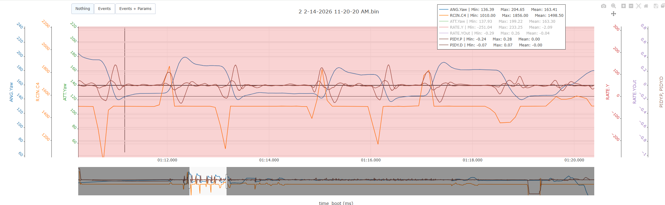

I have started to notice that even really slow yaw input gets a bounce back and then look for this in the logs I see there is a saw tooth bump on ang yaw every time the stick re-centers. I guess I would have expected ang to change slower as the stick is moved back toward the center but im not sure if this is what is causing the overshoot. Iv tried PIDS all over the place to address this one thing and nothing seems to help.
Going to try Pilot y tc at .05 now and log some piros now to verify the the speed.
I guess the point of questioning PILOT_Y_RATE is that would you ever want to use 360 deg/s? I mean if you are doing acro then that would be desired but if you are like me who likes to fly pattern then 180 deg/s is plenty. I really think using the PILOT_Y_RATE_TC will help with the overshoot.
I verified this heli can do 360/s. I set it up to 400 and then checked the logs and it held around 400 so 360 should be ok.
Yes, I want that. 360 feels very slow to me still. Am I often going to do 360/s turns? Probably not but most of my FPV flying is done with quad copters so 360 is closer to sorta what I’m used to I guess. I’v turned in down to 180 on this heli for now though incase that is contributing to my issue.
It has this yaw bounce back with the stick hardly moved at very slow rates though so I don’t think rate max is the issue.
