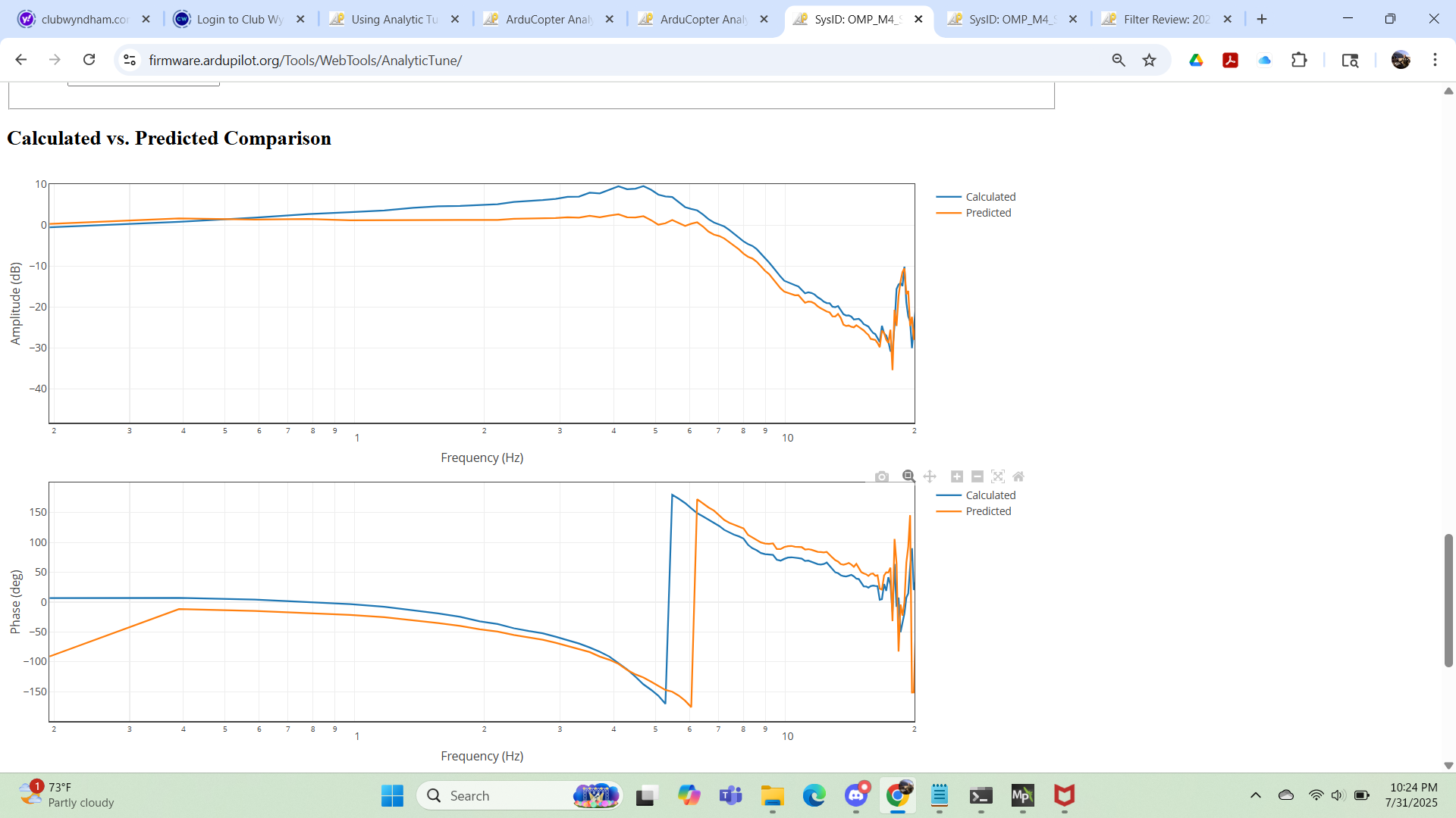

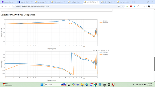

@bnsgeyer I finally got back to this. OMP M4. I’ve taken a stab at pitch and roll parameters from the SysID flight. Can you have a look and give me some feedback before I fly these parameters? Thanks!
M4_40_Roll.param (575 Bytes)
M4_40_Pitch.param (579 Bytes)
Hi Allister,
I think you did a pretty good job on Pitch. I took a slightly different tactic. Using the Notch filter, you can reduce the peak and still be able to increase the Rate P gain a little more. Here is what response looks like and the gains
pitch_allister.param (646 Bytes)
I thought roll was tuned pretty well too. I made a few adjustments. I would pull back the FF slightly to 0.11. That will bring down the rate controller below the 0 db line but more importantly it pulls down the magnitude line down for the attitude controller. in many cases the attitude controller magnitude will stay above the 0 db but just want to keep it down. The other thing I did was increase the Rate D term to 0.0003. it helps flatten out the magnitude.
Thanks! I’ll give these a try and let you know how it goes. I appreciate your time!
