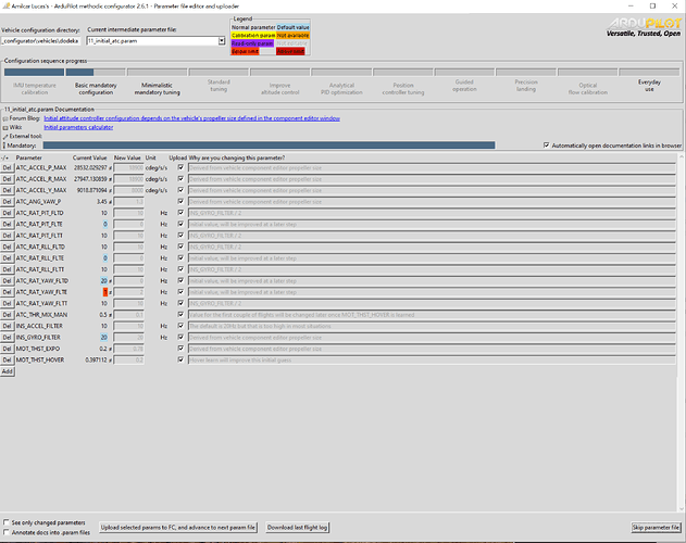

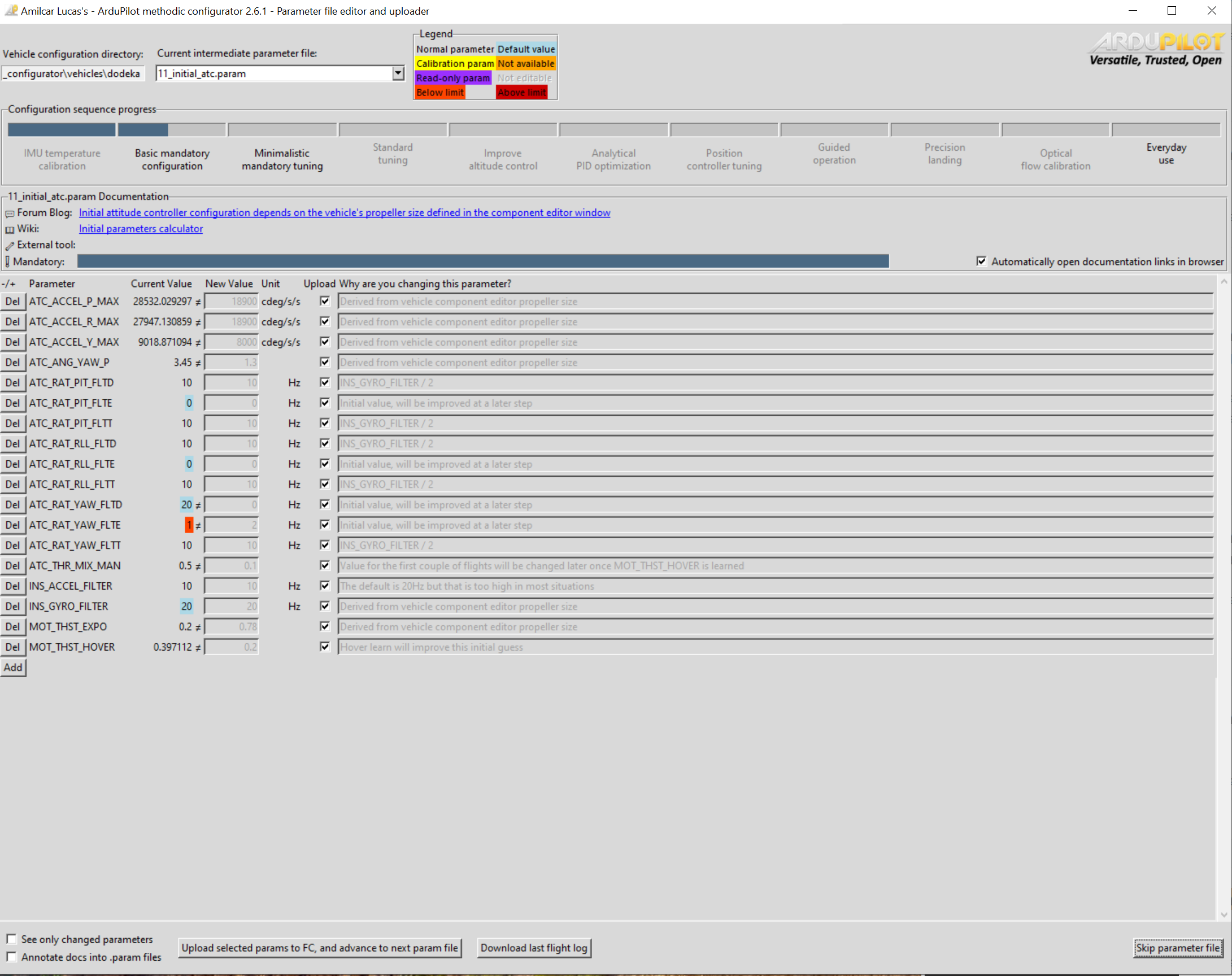

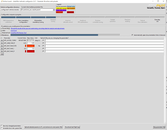

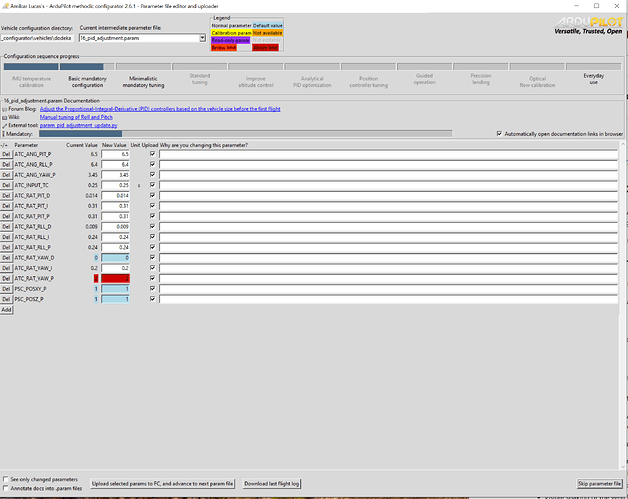

I ran the methodic_configurator as well. All seems ok except for a couple of warning for the ATC_RAT_YAW_P and ATC_RAT_YAW_FLTE for having too high values. This has nothing to do with the FC firmware upgrade, these are the values it copied along from my params in 4.4.4.
Adding a couple screenshots of the methodic_configurator for completeness.
