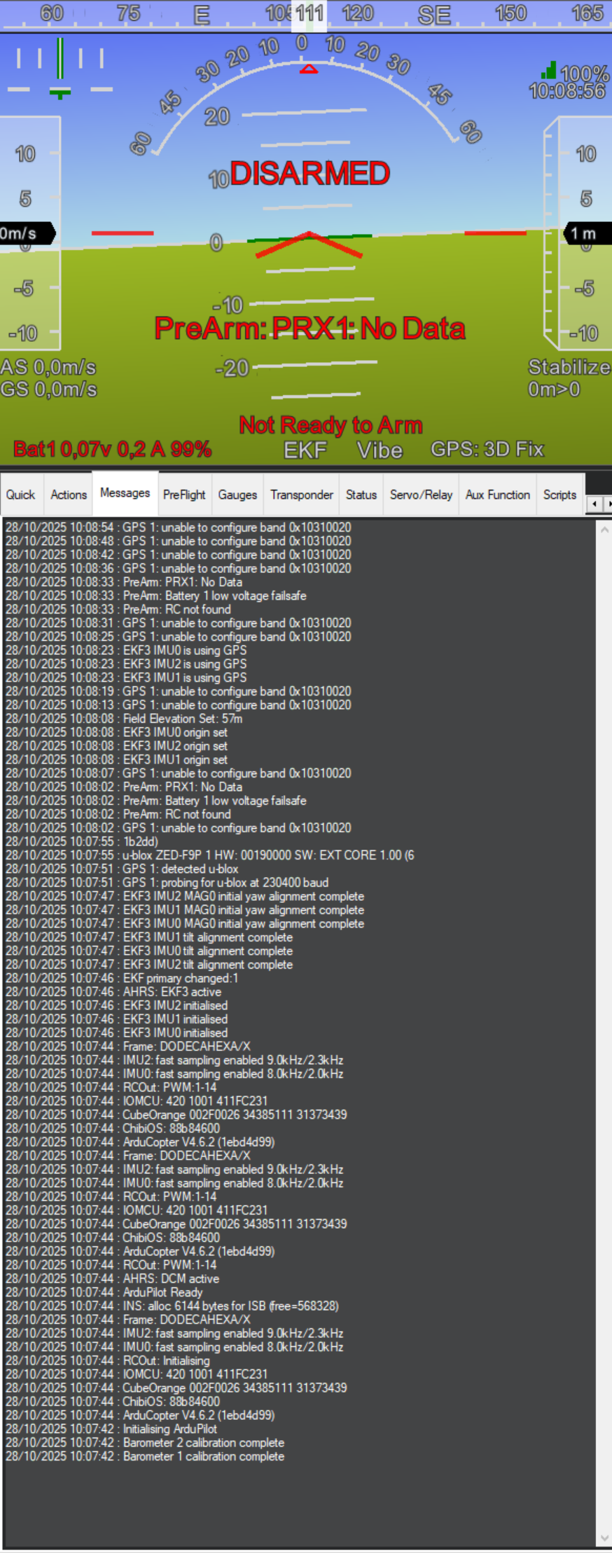

Did the upgrade today. All went smooth. The upgrade procedure copied over the parameters from 4.4.4 to 4.6.2 as I had them set. I did get one warning/error message 'GPS1 unable to configure band 0x10310020' (see attached screenshot). I couldn’t find any related issue online. Anyone has an idea what this is or what is causing it?
Took the drone outside and the GPS was showing our correct position on the map, however the warning/error messages kept appearing.
I did not arm the drone, nor did I do a test flight as the local flight authority forbids us from doing so in this region. The flight test will be conducted in the field around mid December.
I saved the params from the FC to file, loaded them into the simulator (SITL + our params + Gazebo) and it flew ok. There were no reported issues.
I tried the methodic_configurator, but for some reason when I chose the option of ā€˜edit local params’ as opposed to uploading to the drone, it kept showing n/a as current values.
Anyone seen the GPS warning/error before?

@Tristan_Redish hope this helps you in making a decision.
Edit: attached image

How does the GPS Module get its power? Why is the Bat1 showing 0.07v, is it you haven’t configured the battery 1 monitoring?
