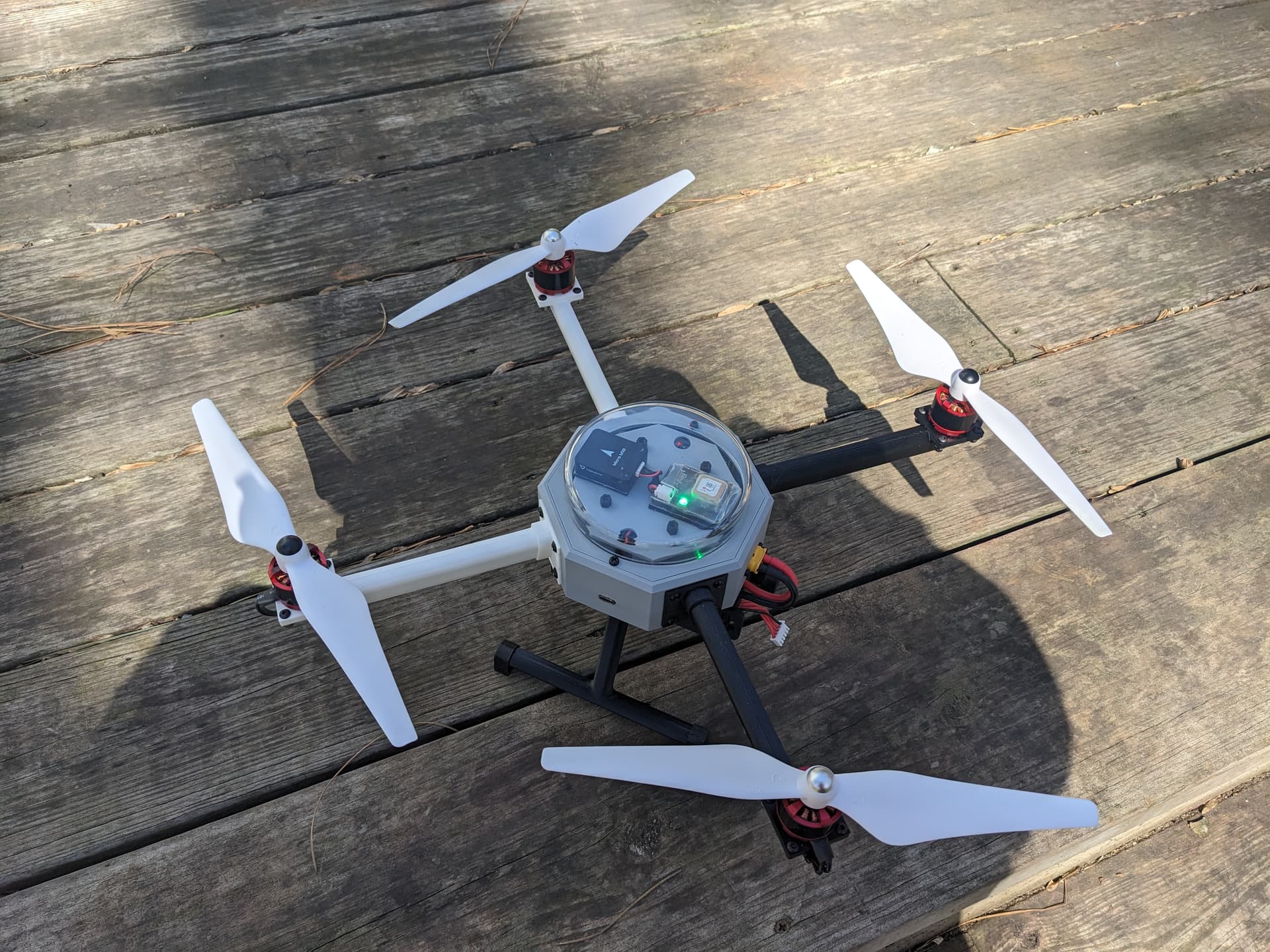

I’m working through initial tuning of a new quad-copter I’ve designed.
The MOT_THST_HOVER value is 1.35 - which is below the stated lower limit of 2.0.
eCalc shows this copter to have a thrust to weight ratio of over 3.5 - which seems to me like it’s got enough power to warrant low power for hover. (eCalc misses the mark on flight time - about 2 minutes two low, and hover amps at about .4 amps high)
I don’t remember having such a low value on MOT_THST_HOVER on other copters. I’m wondering if there’s any other settings I should consider looking into other than what the initial setup tool suggests:

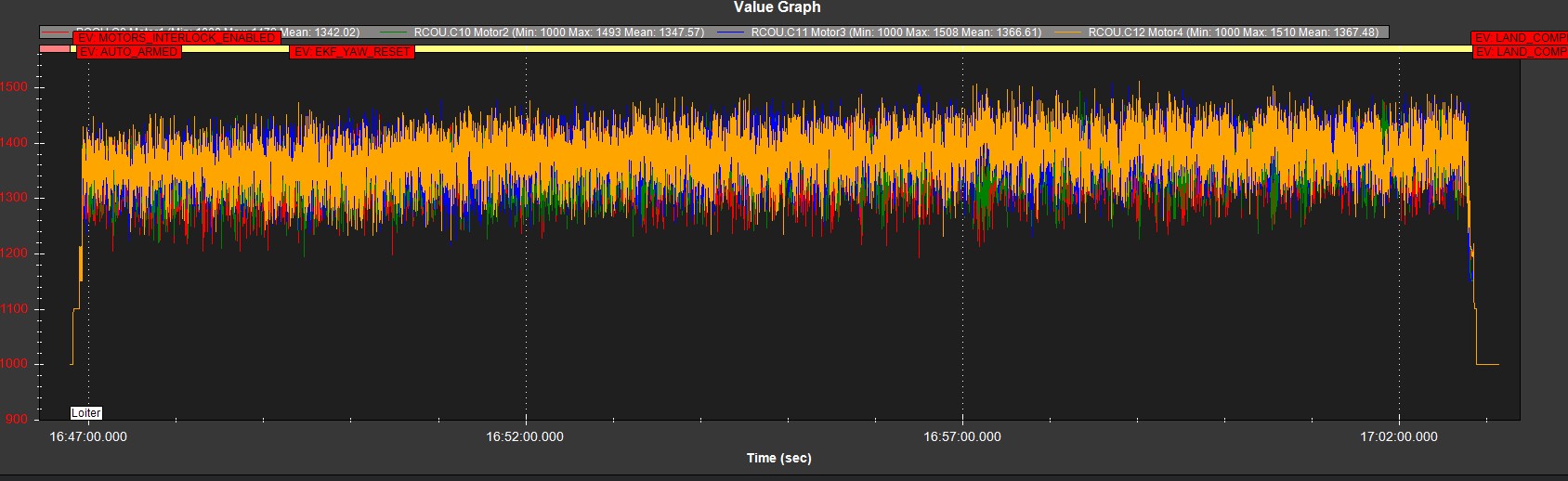

Here’s a log for a 16 minute backyard hover test.
Nothing unusual. I have a few that are 1/2 that. Standard tuning applies. You probably know by now that the limits shown in MP are not applicable to all, or any, craft.
I don’t think so. Output oscillation typical of default PID’s in most craft.
Easy to fix by lowing the rate PID’s. See you are using the Bdshot firmware but no ESC RPM in sight.
